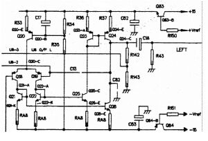

Linn LK1
Is it anybody that can give me some tip on how to get this beast working with newer Zetex BJT's.🙂

Re: LK-1 Circuit
leiade,
the Linn LK1 circuit simply has not enough gain. The current from the input stage is mirrored twice, and maybe there is a tenfold current muliplification at the first set of current mirrors (depending on actual resistor values not shown in the circuit schematic), but that is simply not enough.
If you convert it into differential amp -> differential VAS stage -> current mirror, you get early Mark Levinson style from raw topology and much reduced distortions. Mind the phase, when doing the conversion. Check for oscillations, because of more open loop gain.
regards,
Hartmut
leiade said:Here is a image of the LK-1 circuit I think that the distorsion is rather high 0,1 % thd maybe it would be some adjustment to the circuit but where?🙂
leiade,
regards,
Hartmut
