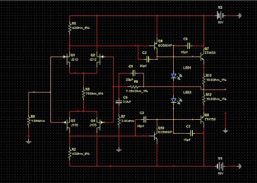

I have designed an BJT output for the JC-2 I just hooked on two transistors I used the old BD139/140 seems to be very good devices is there any other esoteric devices that I can use.
I will post this scheme tonight and I'm indeed very curious for the comments.
I have used the Multisim "pspice type of simulator" it has very good schematic drawing utility and the simulator "state of the art".

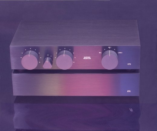

Here it is the Blowtorch I've got a letter this morning from Mr.Crump the letter has three attachments one is a picture of the famous Blowtorch.:bigeyes:
Meet this spec any???
This is the Blowtorch specifications:
Open loop bandwidth 350,000 hz
Spectral analysis 2nd and 3rd order only <.01% IM at 3V output
S/N line 113dB
S/N Phono 85dB
Crosstalk 100dB @ 50Khz
Gain 8dB single ended
14dB balanced
Output impedance 1K without buffer
:Pinoc:
prebuff
Here is my first trial circuit it happens to be a preamp with low output driving capability I have done a Multisim simulation and it seems to be just Ok very low distorsion and good linearity.
But if people here have suggestions on how to make t better I would be happy.😎
