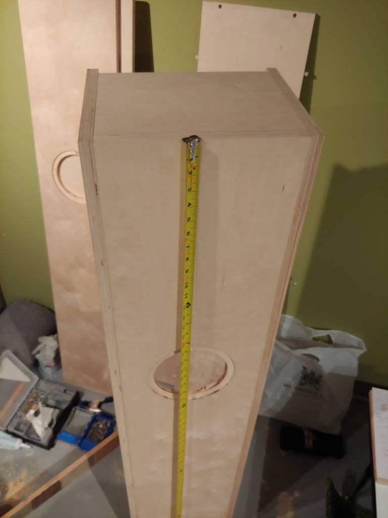

The "piano towers" (working title) are coming along!
Having a Christmas break helps... Though I'm not sure I'm getting any more done than when I just worked on it every spare evening.
Just hoping I can find out how to bring the grain out of the Birch. It's apparently hard to stain and finish!! These pieces have a lot of stormy looking grain.

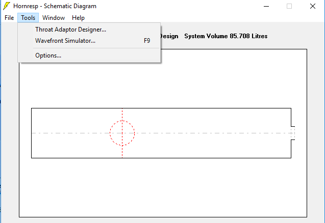

I attached a screenshot... I get NO loudspeaker wizard access in HR.
In this window the Tools menu does not contain the wizard.
In the PREVIOUS window, there's a Loudspeaker Wizard option, but it (and most of the options) are grayed out!

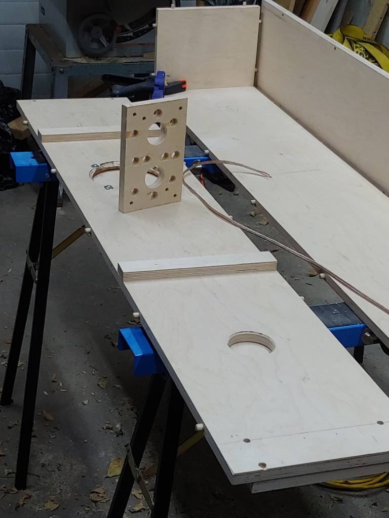

back to speaker work. Never could see a diagram that shows where stuffing should be.

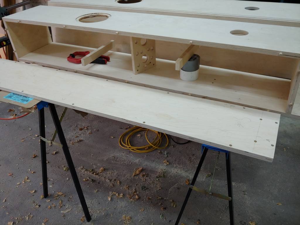

I'm planning on bracing it, 1 f/b brace, and 2 side/sides. Front/Back brace will be just below the speaker, angled (and holed out), just below half way down the airspace.
I would be the Side braces about 70% and 35% perhaps, just to avoid harmonic numbers.
Just been sanding to prepare for finishing, and deciding how soon I want to glue. I want to leave one side unglued, in case I need to remove stuffing, etc.
I created a "port" in the false bottom so that I can add a BSC later, if needed.
I'll add photos from my cell.

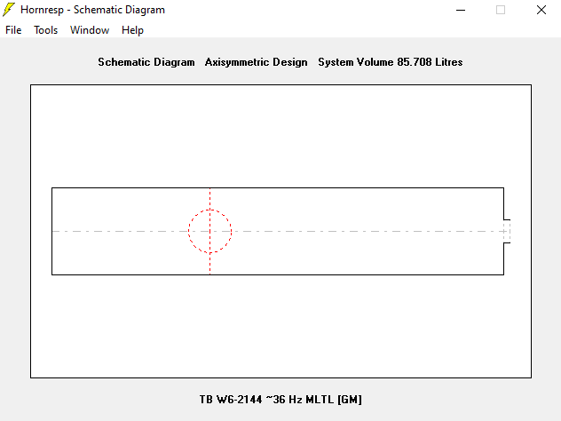

Hmm, if you mean creating a HR DCR/DCAAV Wizard Record of a MLTL, then mostly yes [don't see a way to directly compare to a MLTL in the Wizard], otherwise no clue what you're wanting.
Anyway, converting my previously posted ~36 Hz [GM] MLTL yields a ~extra 1/2 octave [~25 Hz Fb] of usable BW, i.e. build the original except one ~18 mm panel thickness taller [divider] and add a 2nd vent of the same design in the bottom chamber, though all things considered, I doubt one can hear the difference by just adding the vented divider to the existing MLTL [mine or any others] as they tend to have enough extra net Vb over a basic BR to merely adjust its stuffing density [at most].

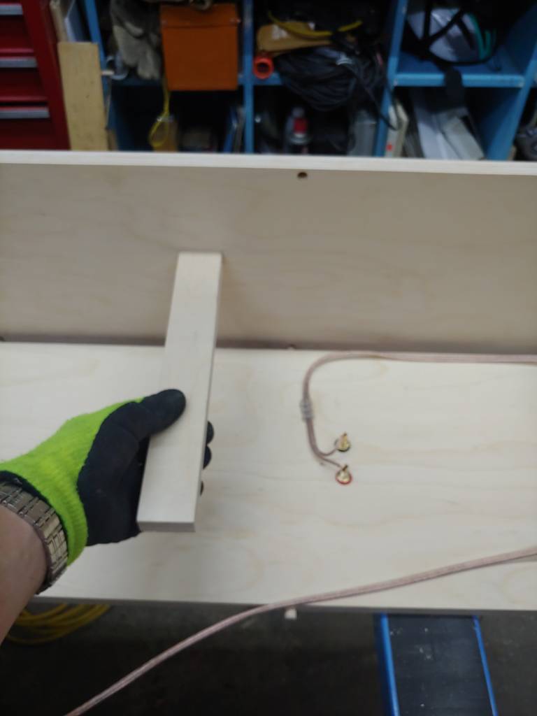

100% would just be stuffed loosely, down to driver center line, right? I could put a wood brace across there to keep the stuffing above.
Does Poly settle at all over time? Does anyone know of a better method to keep it in place?
30% , would that mean taking the "normal amount", and just breaking a third off, approx, then fluffing it out to occupy the space?
Ok, I'll move the fat brace down to 78cm to hold the 30% zone up, and put a narrow brace behind driver to hold the 100% stuffing above that.
Any issues with the size of that fat brace? I drilled lots of holes, so it shouldn't affect the performance much, right?

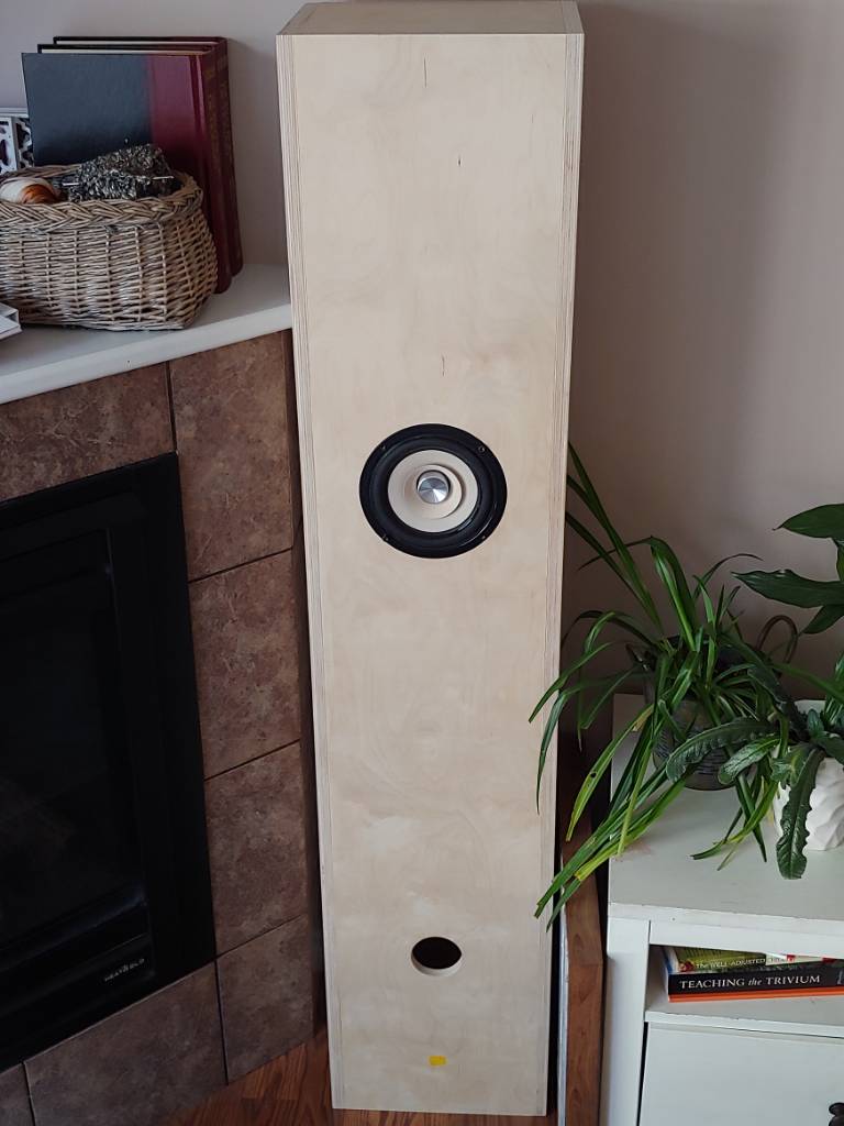

Glued all but one side panel.
Set then up for tuning. They sound feast against the wall!
And by feast i mean great!
Folk, classical, etc sounds warm/intimate. Vocals image nicely... Maybe not quite as precise a earlier... But I sit further away, so I'm not surprised.
Soundtracks are full of weight! Bladerunner 2049 is epic!
Rock almost becomes dry, you can pick apart all the elements!
Techno, DnB... Every low note is well balanced.
Now to convince someone that the WAF is higher than it appears... I just want to finish them and put them back in the living room.JPEG_20201014_125334_4551555399657663195.jpg
