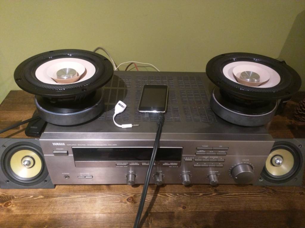

Folded horns? Xtra Large?Bought them going to try them in my FHXL’s
Wow.
