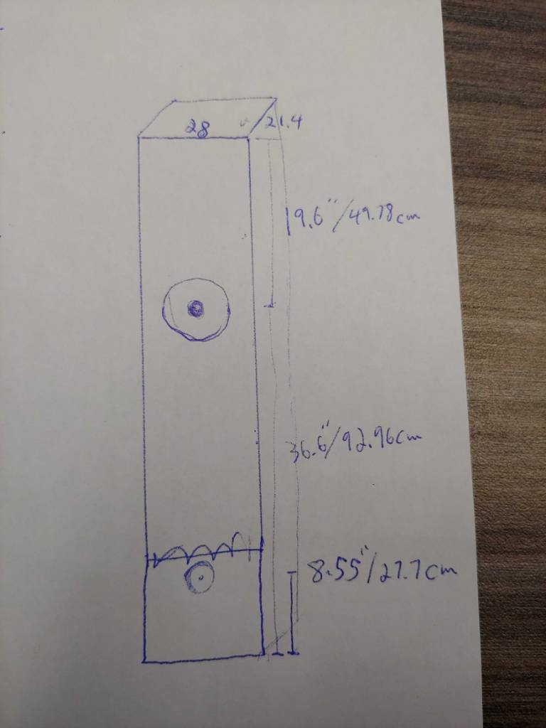

No, looking at it again, I do really like that huge 35hz bump... And having just built a PAL, which has a similar rise down to 37-39hz, I know I like the sound of music through that sub. It has NO damping, so definitely a bit of that hollow sound. It's for PA, so you don't notice it in a system.
PLUS - I believe the length of yours matches up perfectly to a 5' height, correct?? So 5x5 BB plywood should work perfectly for the box. Might have some extra for plywood for for bases / tops....
Might take two 5x5s... Or to save $ I can use 3/4" BB on fronts, and some kind of 1/2" for sides. That will lighten box, and make it easier to stabilize with weight /wide base on the bottom.
I'm going to try and draw the design out, so I can post it here and have you confirm that I've got everything right.
Hmm, the PAL sub is a TH IIRC, so not comparing apples to apples, but worst case is you add more stuffing to knock it down a bit.
Well, the baffle is ~19.61 + ~36.57 = ~56.18" [3/16] and add 1.5" for the side plates gives you some excess from 5 ft/60" to fudge with.
