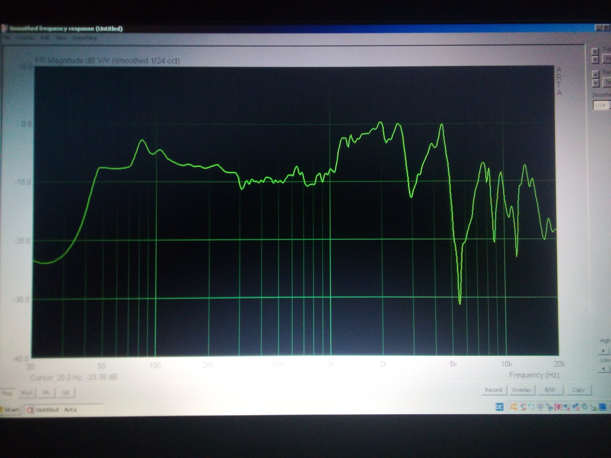

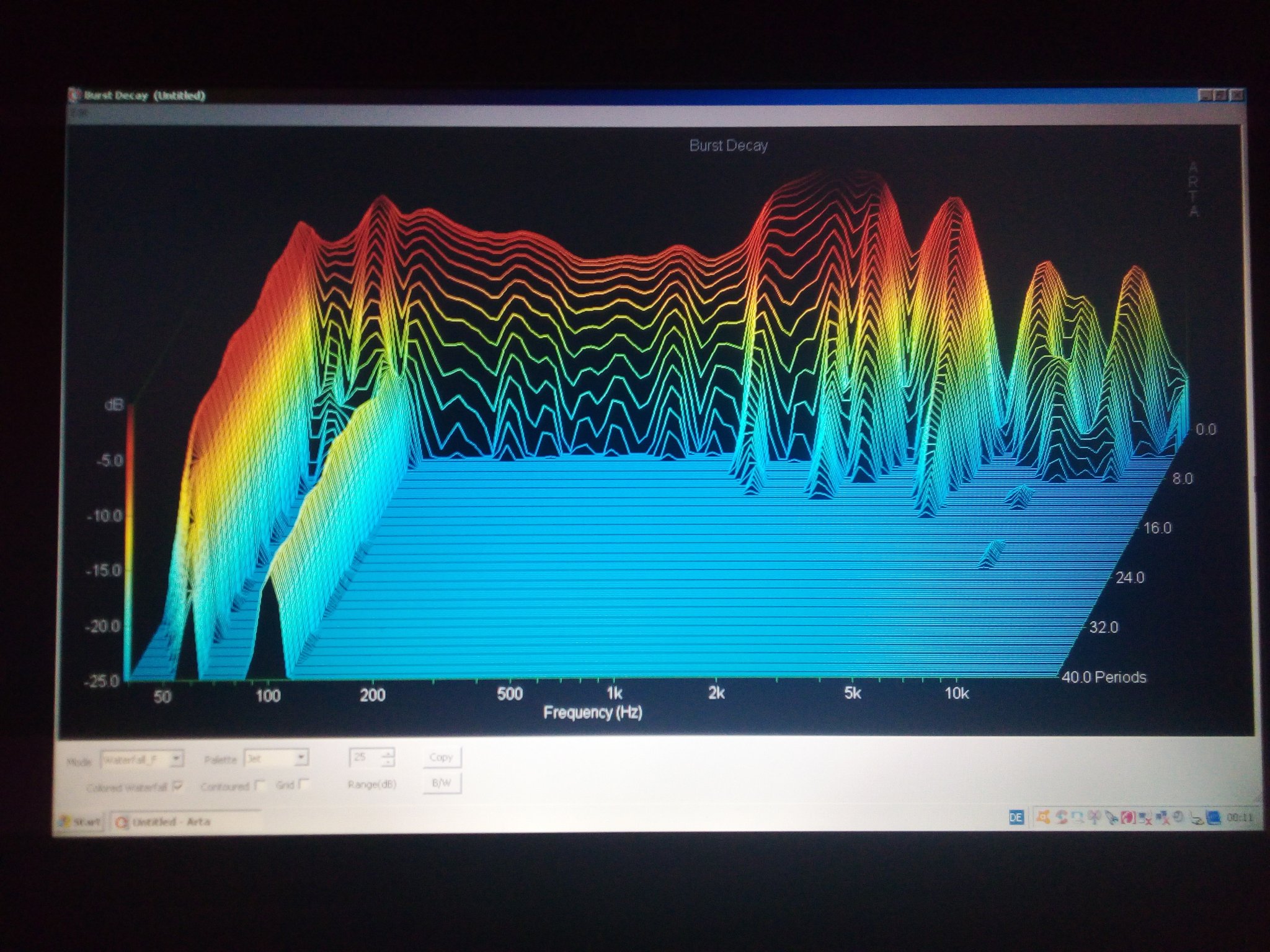

Similar same size driver with the same cone but with bigger magnet, bigger voice coil and plastic whizzer cone instead of paper, we see with more inductivity on the voice coil
Freedom666 Member Joined 2008 Paid Member 2024-04-16 1:14 pm #64 2024-04-16 1:14 pm #64 this one looks good. With LCR filter or current driven amp it should work well
