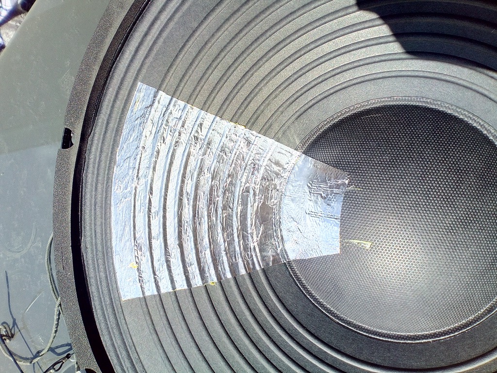

I think the glue is not so important.
Sometimes I use Nitro cellulose from the goldsmith with very thin alu foil.
Other times Uhu or Pattex with household aluminium foil.
The first for whizzer cones or small fullrange.
The latter for bigger drivers

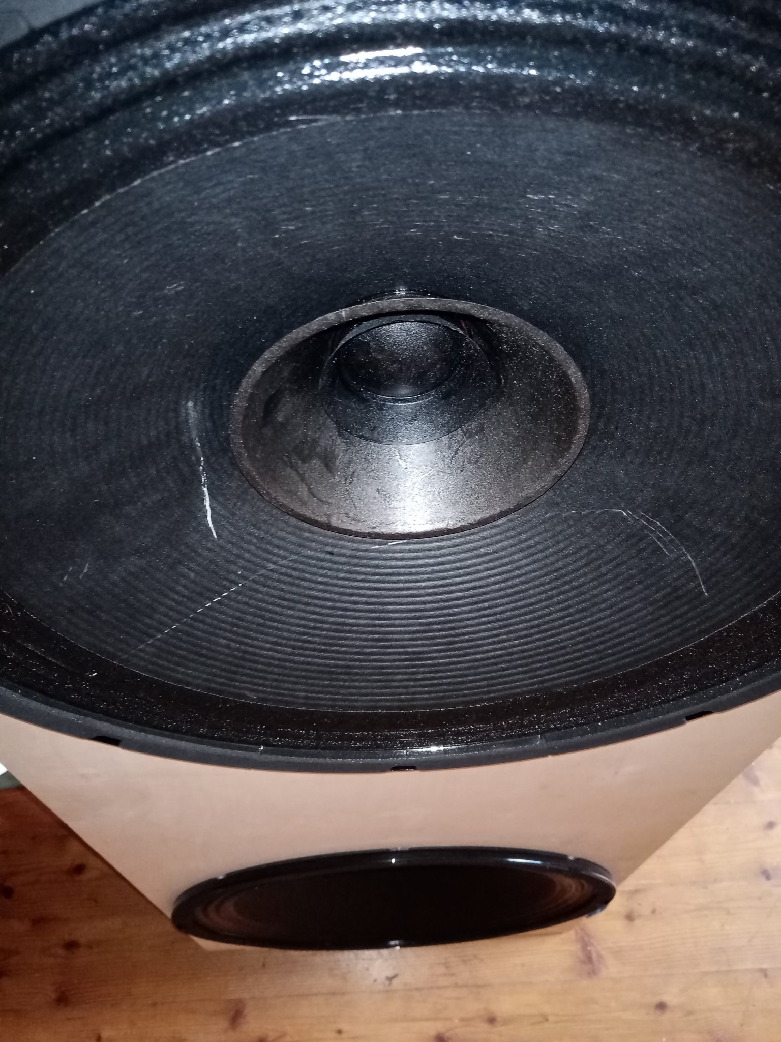

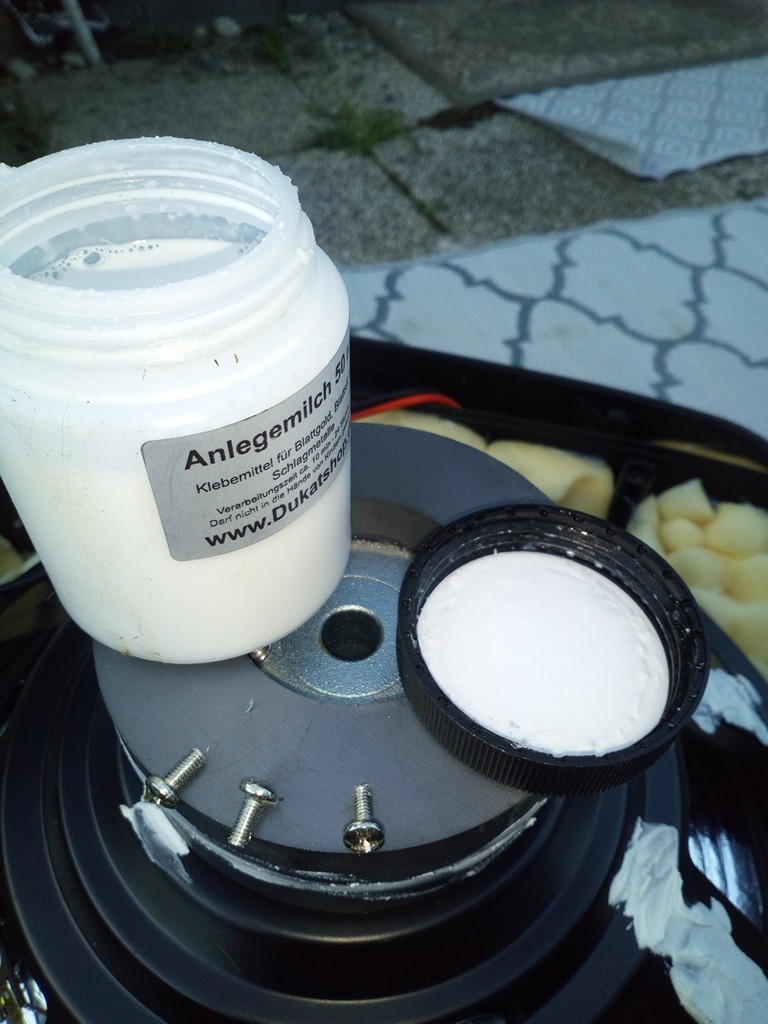

OK, both nitro cellulose and Pattex do some damping.
You can use the glue named in German Anlegemilch (nitro cellulose) as slight damping for paper cones. You see it on this the whizzer cone of this Fane Sovereign 15 300tc. And on the other Foto as a product from dukatshop.
I think that the aluminum does some damping. In my eyes it's the dominating factor.
It prevents from big resonance amplitudes.
The paper core itself has damping characteristics.

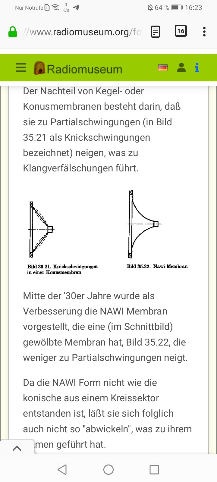

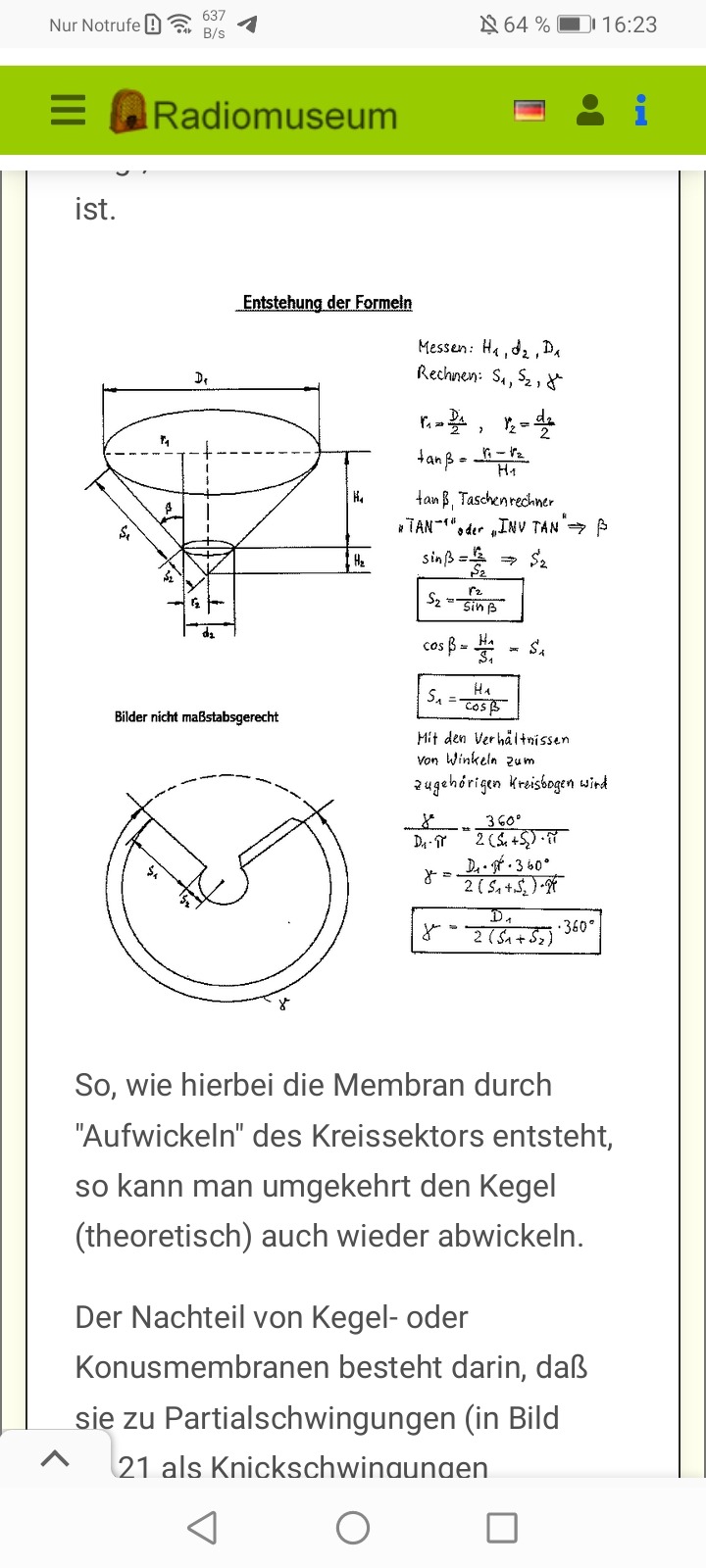

Nawi is the most stable cone.
But honeycomb structures are difficult to implement into this structure. Therefore often flat cones are used.
So nawi paper cone with sandwich aluminium foil is a good stiff structure.
https://www.radiomuseum.org/forum/technik_der_lautsprecher.html
