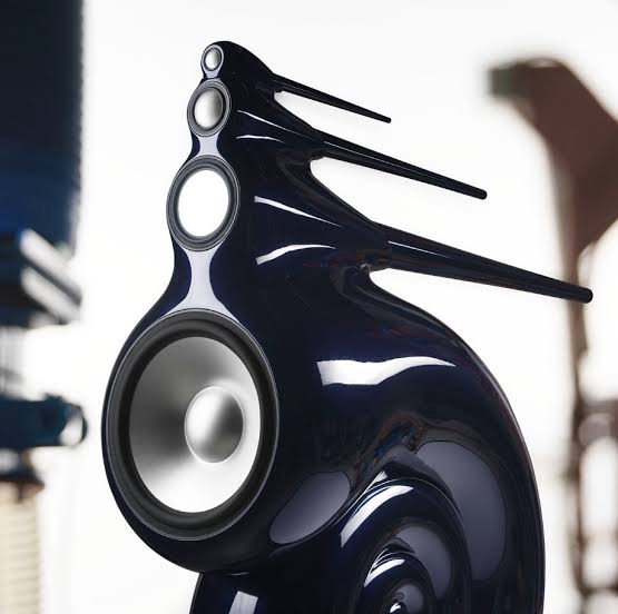

Hello, I've read a lot about sandwich structures and some renowned companies have used them.
I'm currently working on a project of mine to make sandwich cones for my speakers.
The materials are:
Faces: Kevlar carbon fiber hybrid
Core: Low density expanded polystyrene (LDEP)
I want to know if there is another sandwich structure or better material than those I mentioned.
Currently I think the best sandwich structure for speaker cone.
I want to know how the speaker cone profile can affect the sound performance.
The speaker cone profiles I know of are:
Concave cone, widely used for Subwoofer, Woofer and Mid-Ranger.
Dome cone, often used for Tweeters and a few Mid-Rangers.
Flat cone, somewhat unknown, used for Woofers and Mid-Rangers.
The photo (image) below is of the Nautilus by Bowers & Wilkins.
Note that the mid-bass is a flat profile cone.

I do not know what foam core is used by such companies as Focal or Eton in their sandwiched drivers, but the answers as usual should be : the ligther and stiffer and most damped foam structure. Then choose you two external driver sides devil : A german company made a nice aluminium with inside foam core line of drivers. I would be curious about non symetrical material surfaces : for instance : external thin aluminium sheet - foam core - internal side of the driver with something more damped though still stiff (glass fiber ?).
Anyway you should find some nice sandwich from Focal but alas in the car line.
The venerable KEF B139 bass driver (aluminium foil on expanded polystyrene) is surely old enough to be very well documented - probably worth a search to reveal its pros and cons. The best bass driver I have ever heard was a conventional conical paper cone.
Rohacell is a newer foam core - seems to be a technical update instead of Polystyrol. BW used Rohacell for their bass drivers.
However I was thinking about a Polystyrol core worked with CNC machines to be a honeycomb structure. Then layerd between alu or other material.

It is my understanding that non-paper/non-conical drivers have very peaky resonances requiring steep filtering to tame them, so keeping them out of the intended pass band will be the key to success, or not! The SEAS magnesium cones spring instantly to mind. Given that paper cones can be made to work so well, it is probably a purely academic exercise to do otherwise, but a fascinating project nonetheless and I wish the OP well.
Eton has managed to tame the resonances in their Kevlar honeycomb sandwich drivers.
Maybe due to special glue I guess.
So it's not true that only paper can have good resonance behavior.
Also the HDA drivers from Audax were similar to paper.
They took high tech fibers and mixed them like paper pulp. And you got the good damping from paper cones but much stiffer cones.
