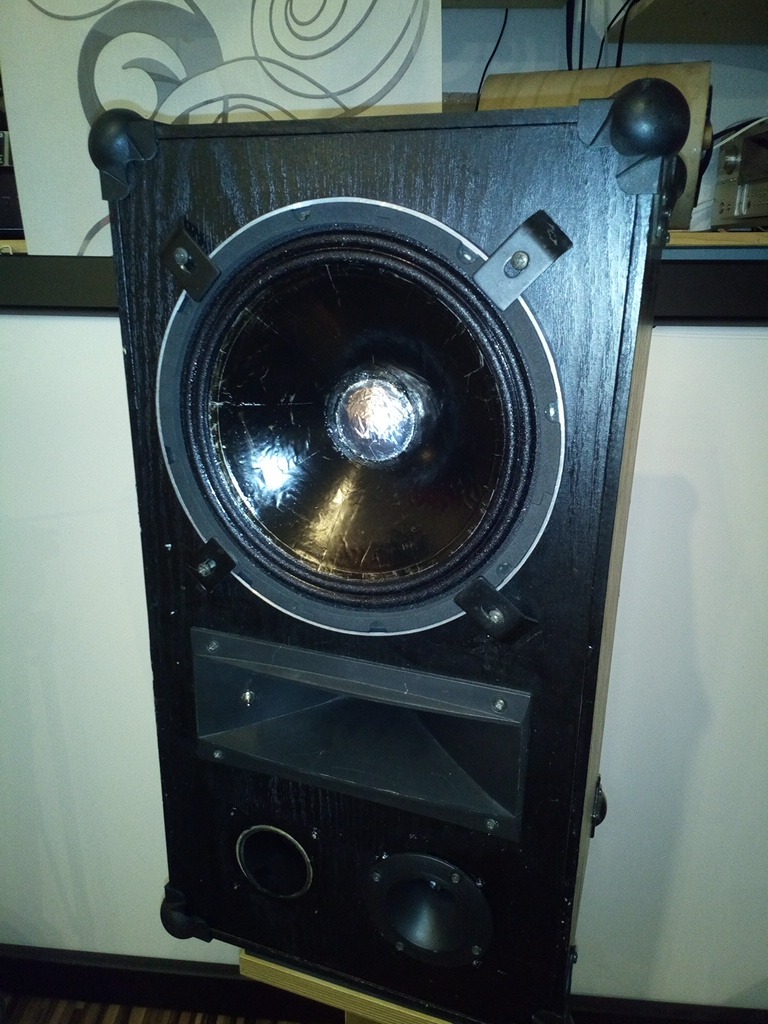

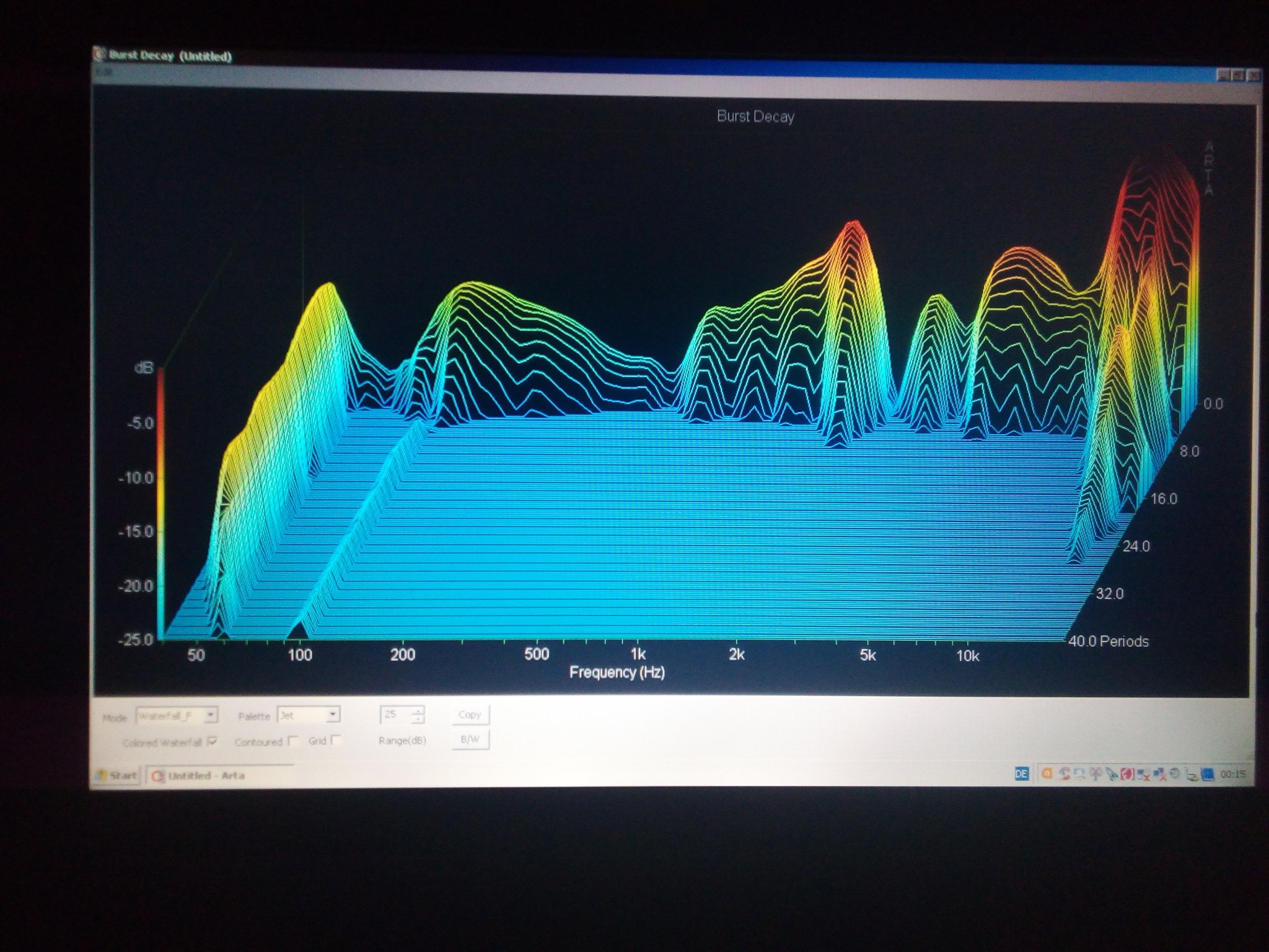

I prefer EQed fullrange drivers doped with aluminum foil.
Here you can see it with a 25cm driver fullrange, no tweeter. The cone is aluminium paper aluminium but painted black for design reasons. Measurements included.

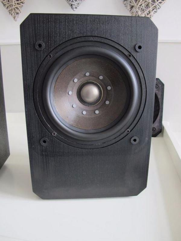

One example for putting weight to some points of a paper cone worked well for the Pfleid FRS20 a loudspeaker legend from Germany in the 80ies.
I have put the small rubber weights down and later glued them back because it was only making the sound better.
Here you can see the damping of the outer edge of the cone, too.
This is a EQed fullrange driver with perfect sound. With natural time coherence.

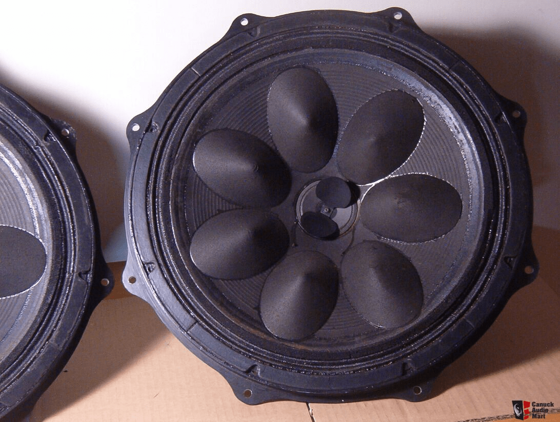

I remember those. Reminds me of the older ITT and Philips drivers. Heco and Magnat had drivers of this design as well.
Older Focal polykevlar was very good for a sandwich type cone. The 5k013l is still a very respectable performing driver to this day.

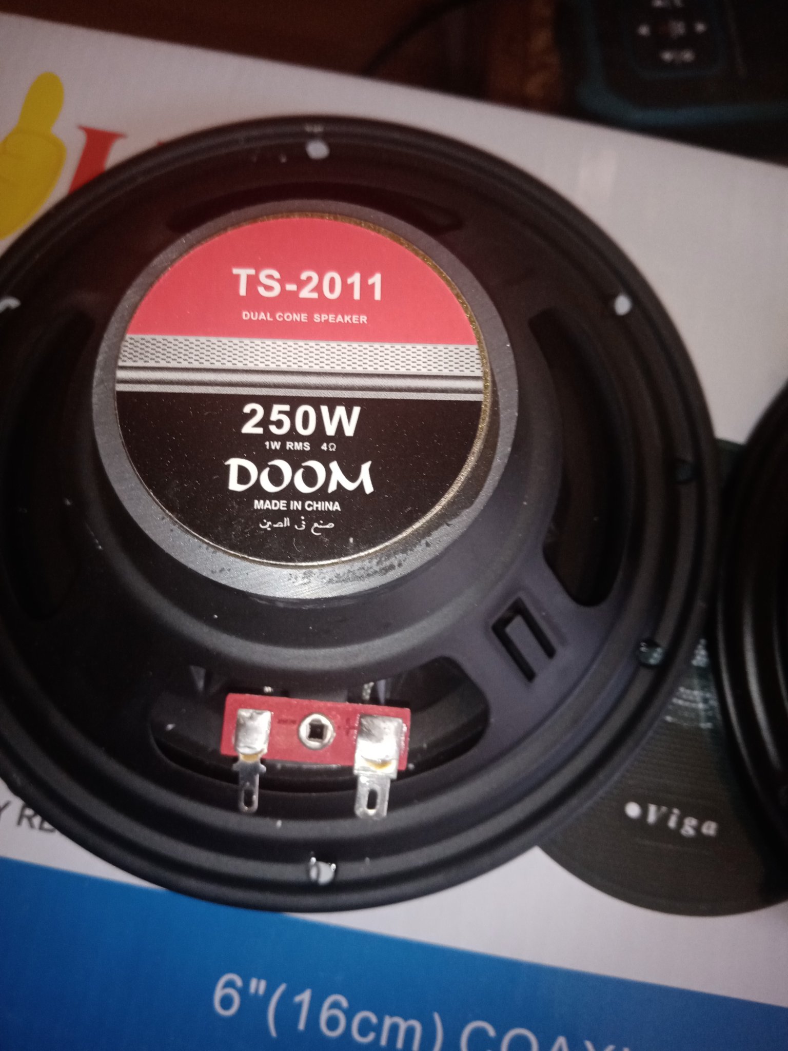

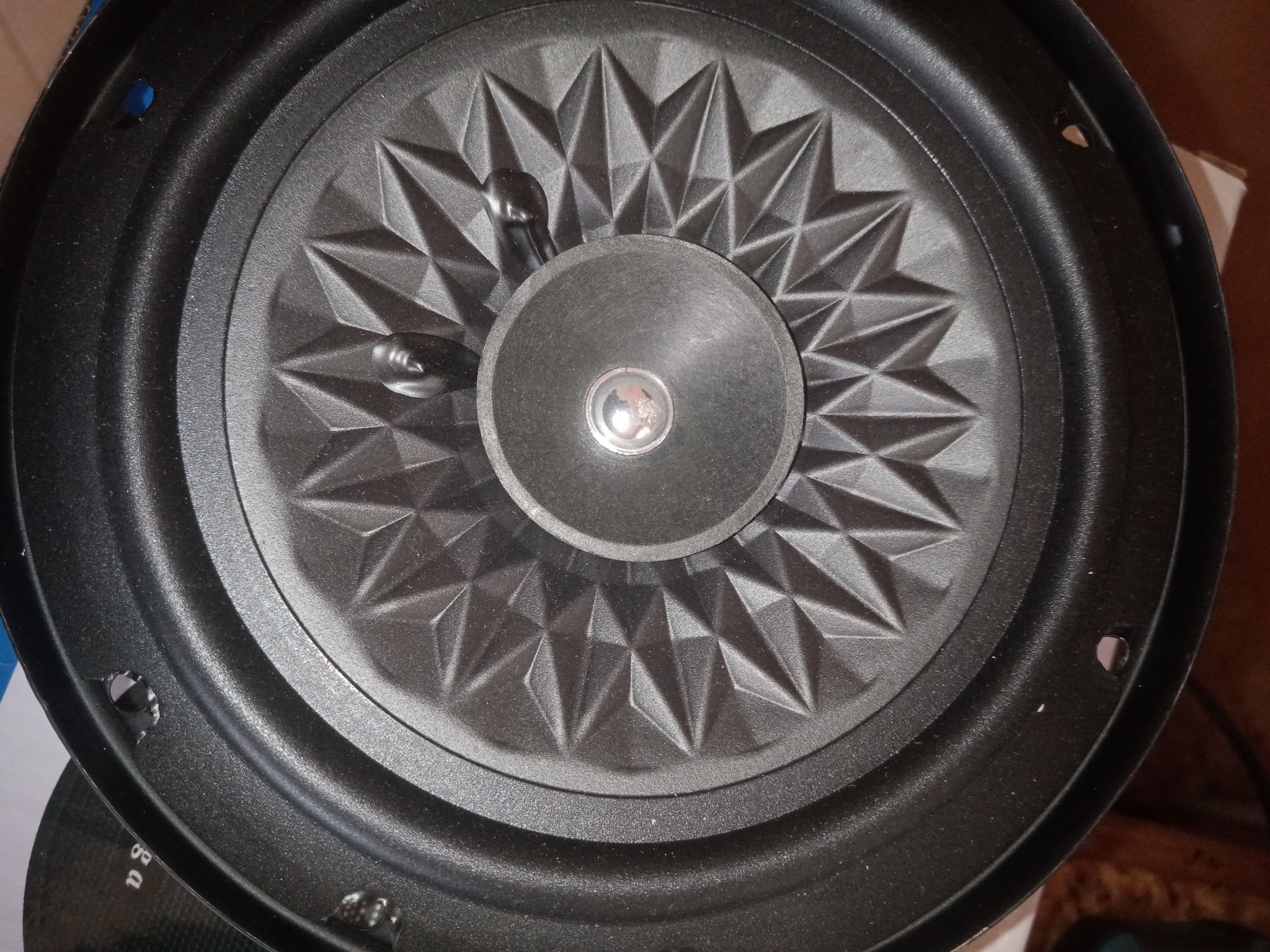

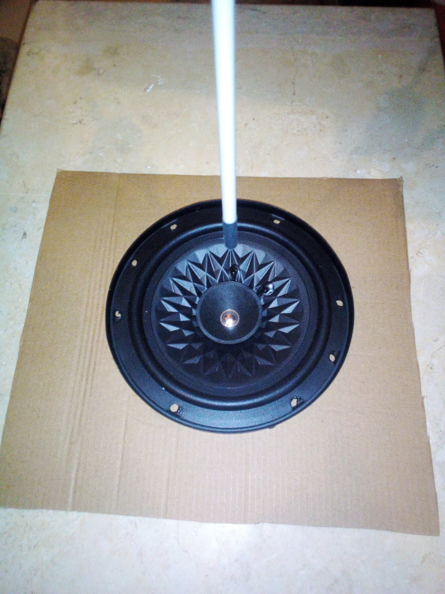

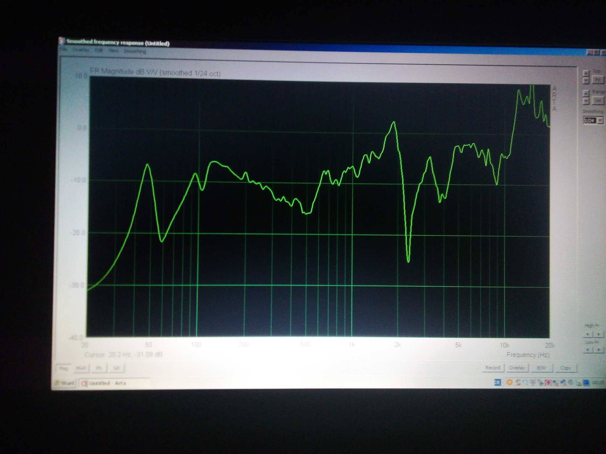

Found interesting drivers with heavily structured polypropylene cone.
It measures like this
Magnet is underpowered and voice coil is only aproxx 1cm diameter but therefore extends easily to 20hz
