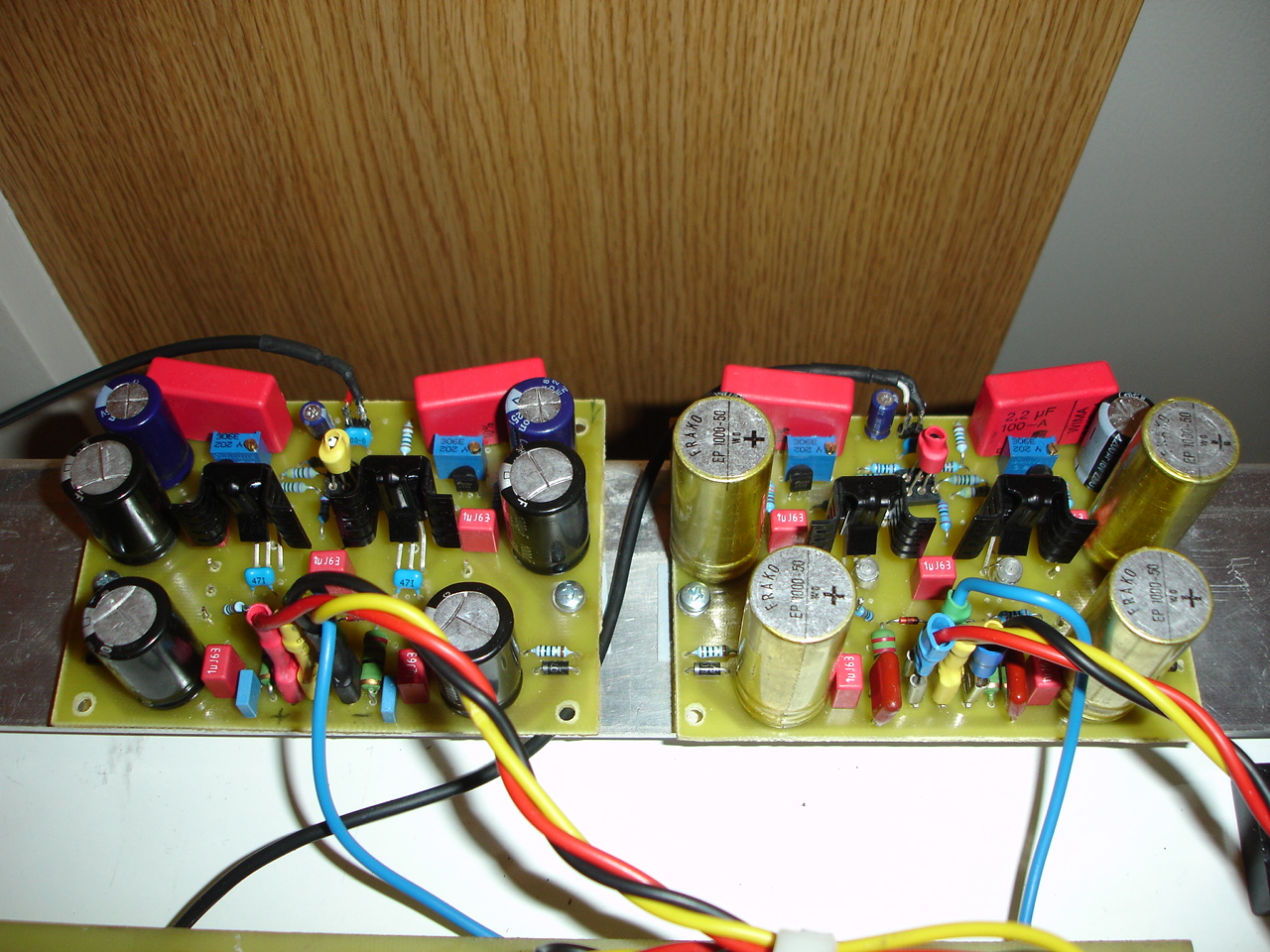

Hi abetir
Fine it is 2,2mF, then run it alone or add the 10uF MKT (your personal taste by listening test).
Pretty shure needs to be TLVH431, search LC's VSSA thread to see malfunction with TLV431.
FET CSS legs SGD looks alright to me at green PCB picture (also see PMI schematic post #1 as help), but do not know if resistor networks is right setup to your 36V rails. Suggest write a friendly PM to member nikosokey, he run successful VSSA with 2N5462 onboard.
Also suggest that you seek knowledge for upstart and calibration on LC's VSSA thread, and until you get it right always have the 22ohm/5W at both rails under testing/calibration scenario, good soldering.

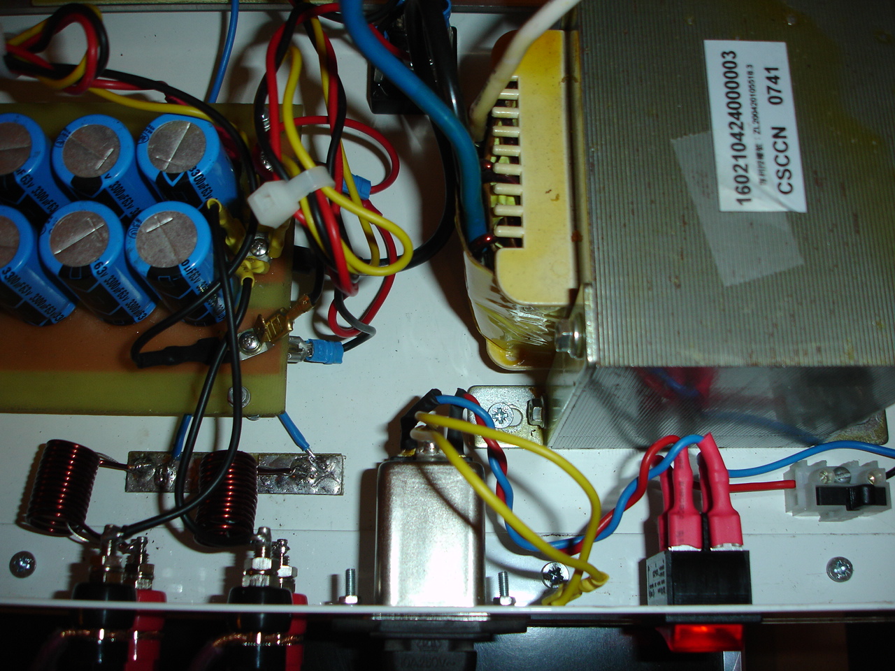

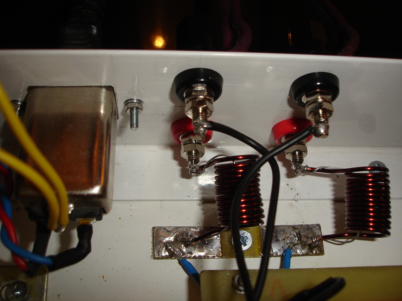

HiA testbed for general use or poor man's enclosure!😱

I have listened this amplifier for a little.
My first opinion is that is an analytic stage with very good and tight bass excellent mids and very good high.
As this amplifier hasn't a differential stage input a little hum is present even with 36.000uf/rail.(my opinion).
That's for now.
My friends wait to listen this also.
You can listen this on youtube soon,but youtube sound is compressed mp3.🙁
Best regards.
Thimios.
