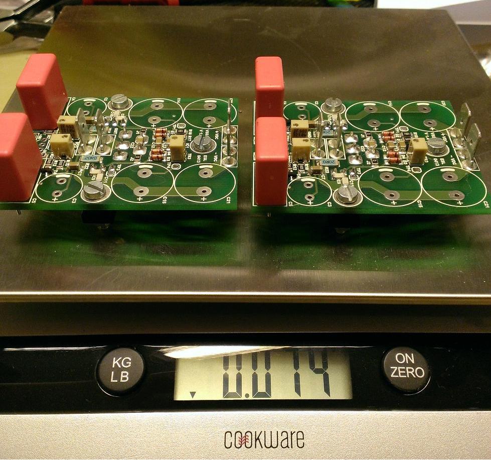

35 g for stereo 😱
Please weight and show us both finished PCB modules.
Hardly wait to see your final implementation. 😎
I will for sure be interesting seeing all different VSSA implementations - Your reward after all work.
I sneak in with a halfway report. Almost 100% VSSA weight gain, now at healthy 74g.😀 Elcaps are on back order, I'll get them on Monday.

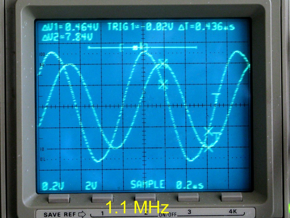

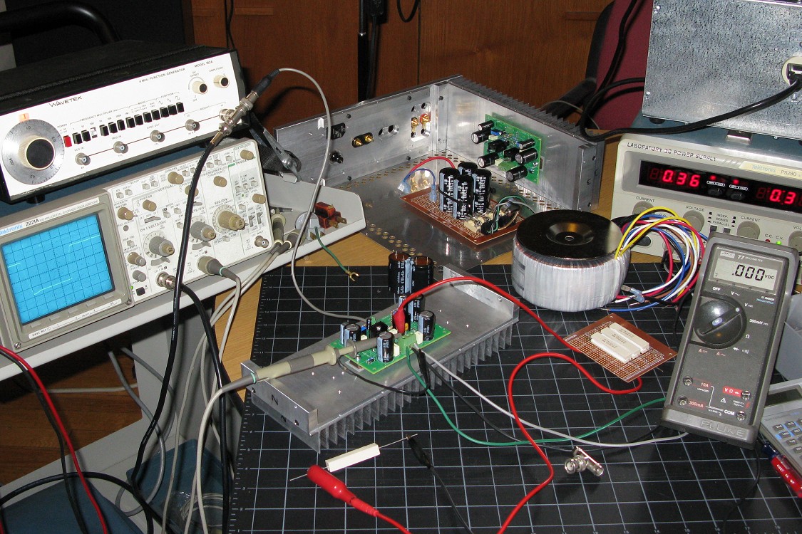

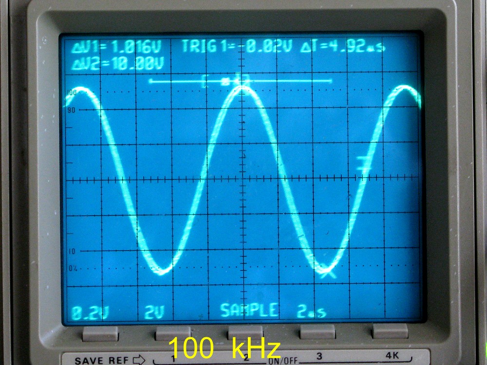

@Salas: This is a follow-up to my earlier bw measurements and estimate. The earlier pics were not usable, these are from a re-do. (The Wavetek makes it hard to repeat a test exactly at over 1 Mhz) I tried using a bench supply (on the right in the last pic) to get a better ground reference for the tests, but that only helped slightly if at all, so this is going to be the best I can do with this source.
HF rolloff:
To show input and output signals same size while using two different scales, I used the screen calibration adjustment to scale (normalize) the channels. In other words, I used the screen-cal adjustment to tweak the display, but NOT the measurements.
To measure sine wave P-P voltage and frequency at the same time on this scope, the cursors have to be 1/2 wave apart, delta-T represents 1/2 of the period, and f=1/(2*delta-T). Only 1 channel can be measured at a time, so when the signal starts to phase shift, only the delta V2 is relevant.
The signal source is an old Wavetek analog signal generator, Most of the waveform distortion visible in the tests above 1 MHz is from the generator, not from the VSSA circuit (verified). Amplitude and rise/fall times are correct.
Pics:
#1 - 100 kHz since wave, input and output in phase, no attenuation.
#2 - 1.1 MHz, -2db
#3 - 1.3 MHz, -3db
#4 - Setup, as tested
