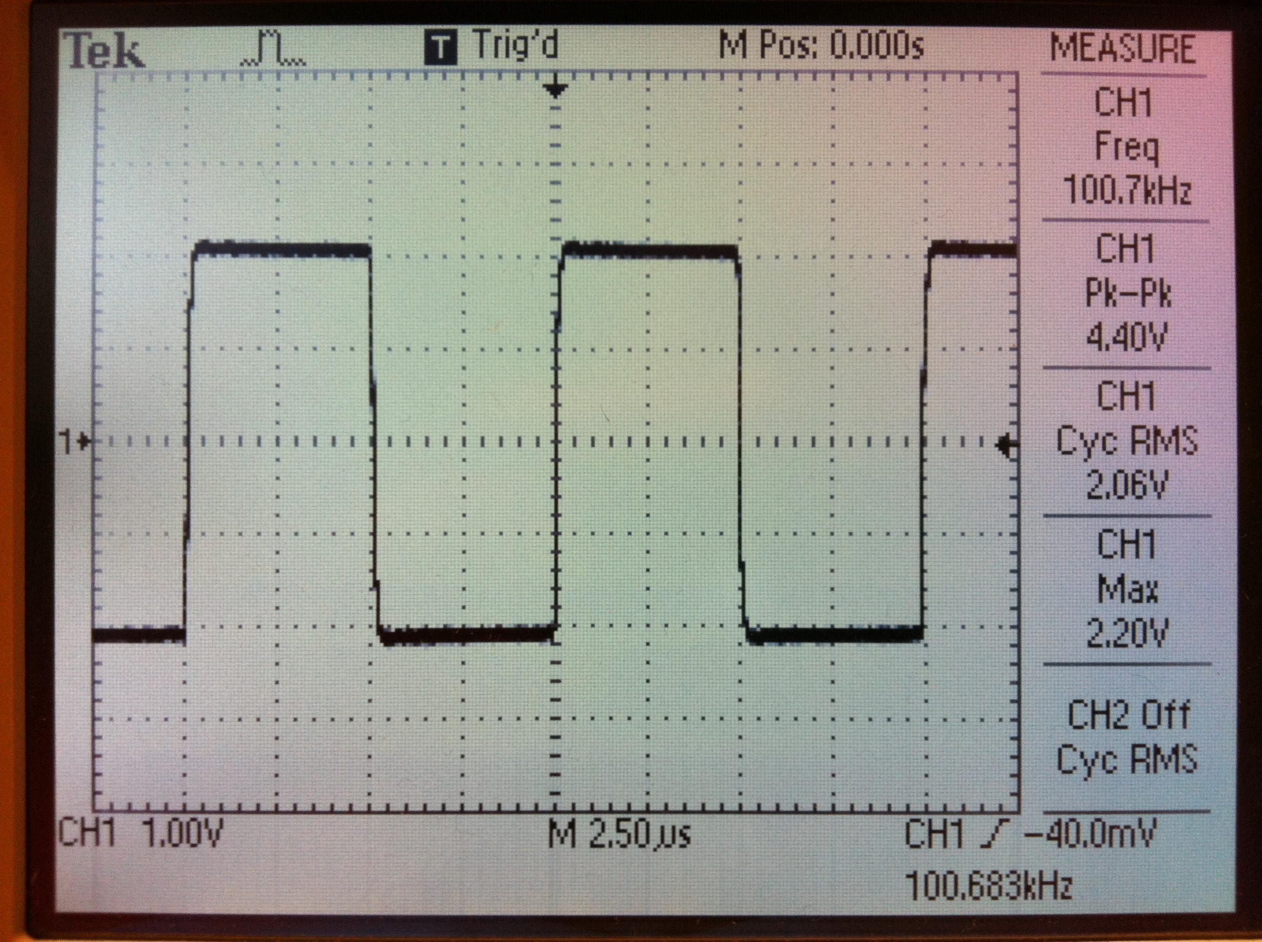

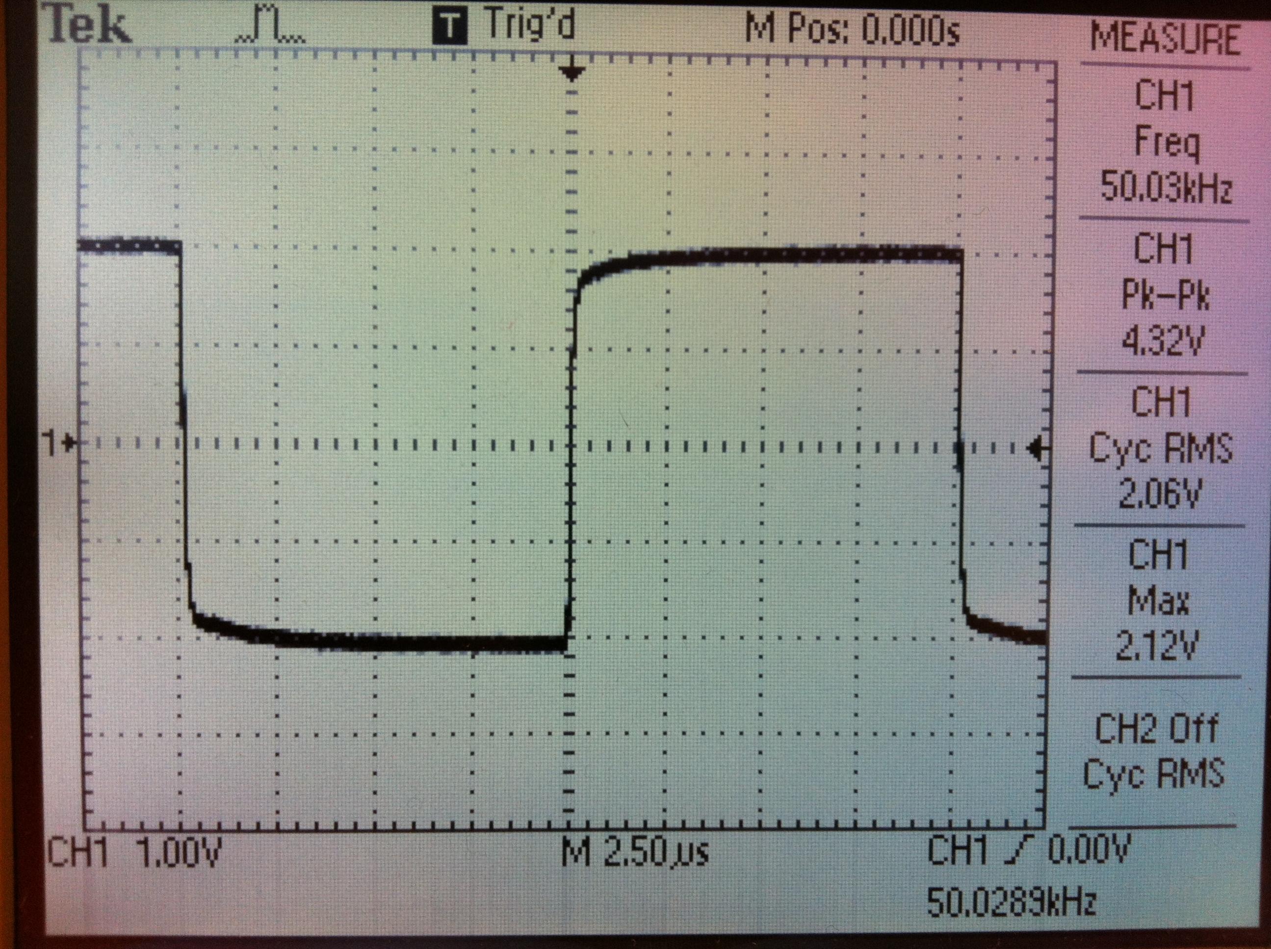

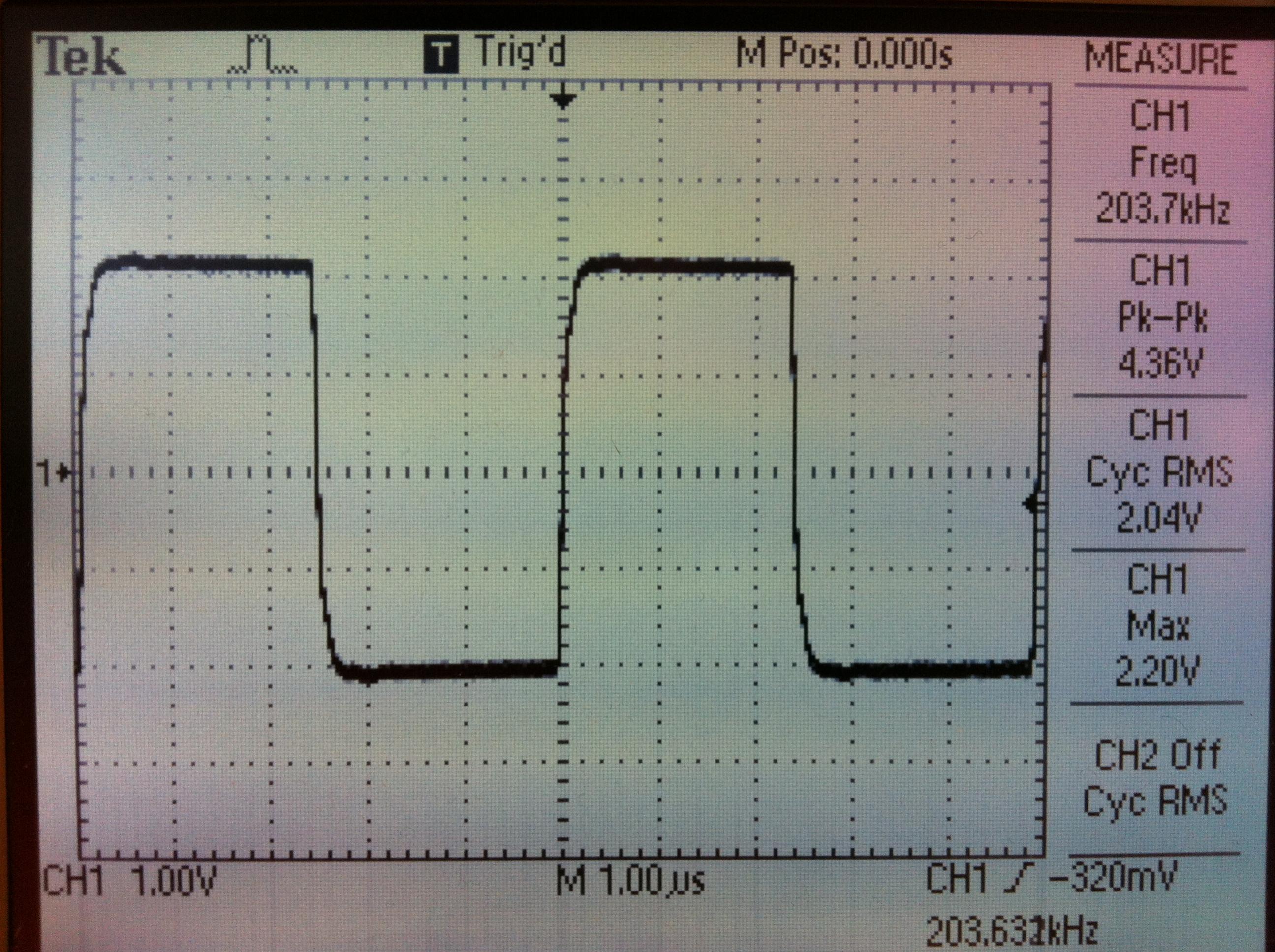

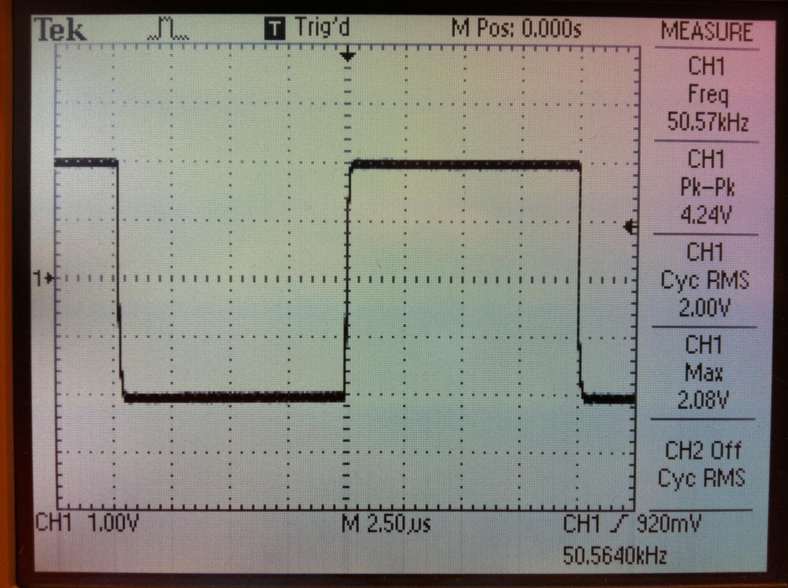

VSSA test measurements with square waves. Input low-pass filter set to 970 kHz (-3 dB), output RC filter installed.
1. Plot - 50 kHz, 8 Ohm load
2. Plot - 100 kHz, 8 Ohm load
3. Plot - 200 kHz, 8 Ohm load
4. plot - 50 kHz, 1 Ohm load
