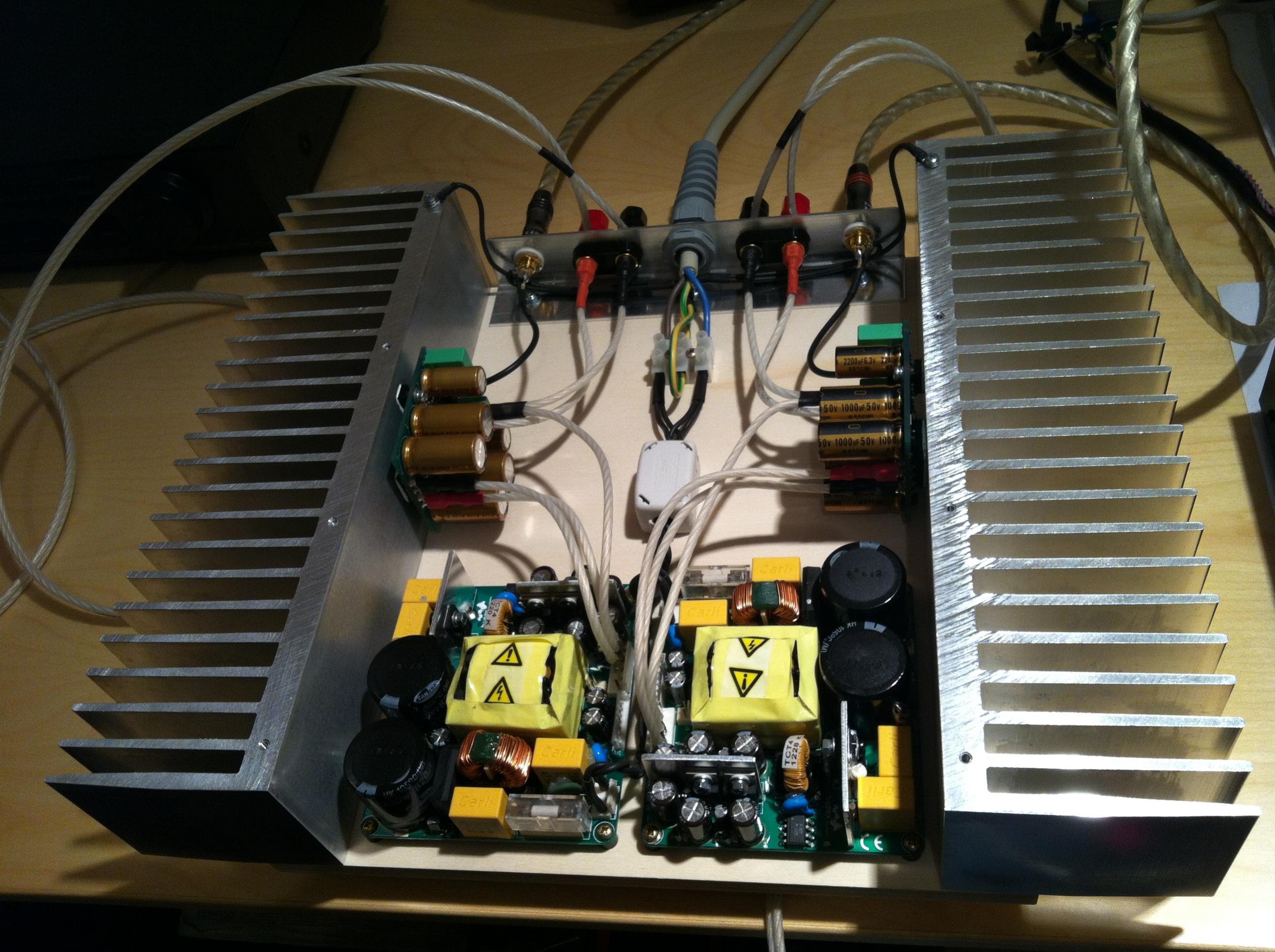

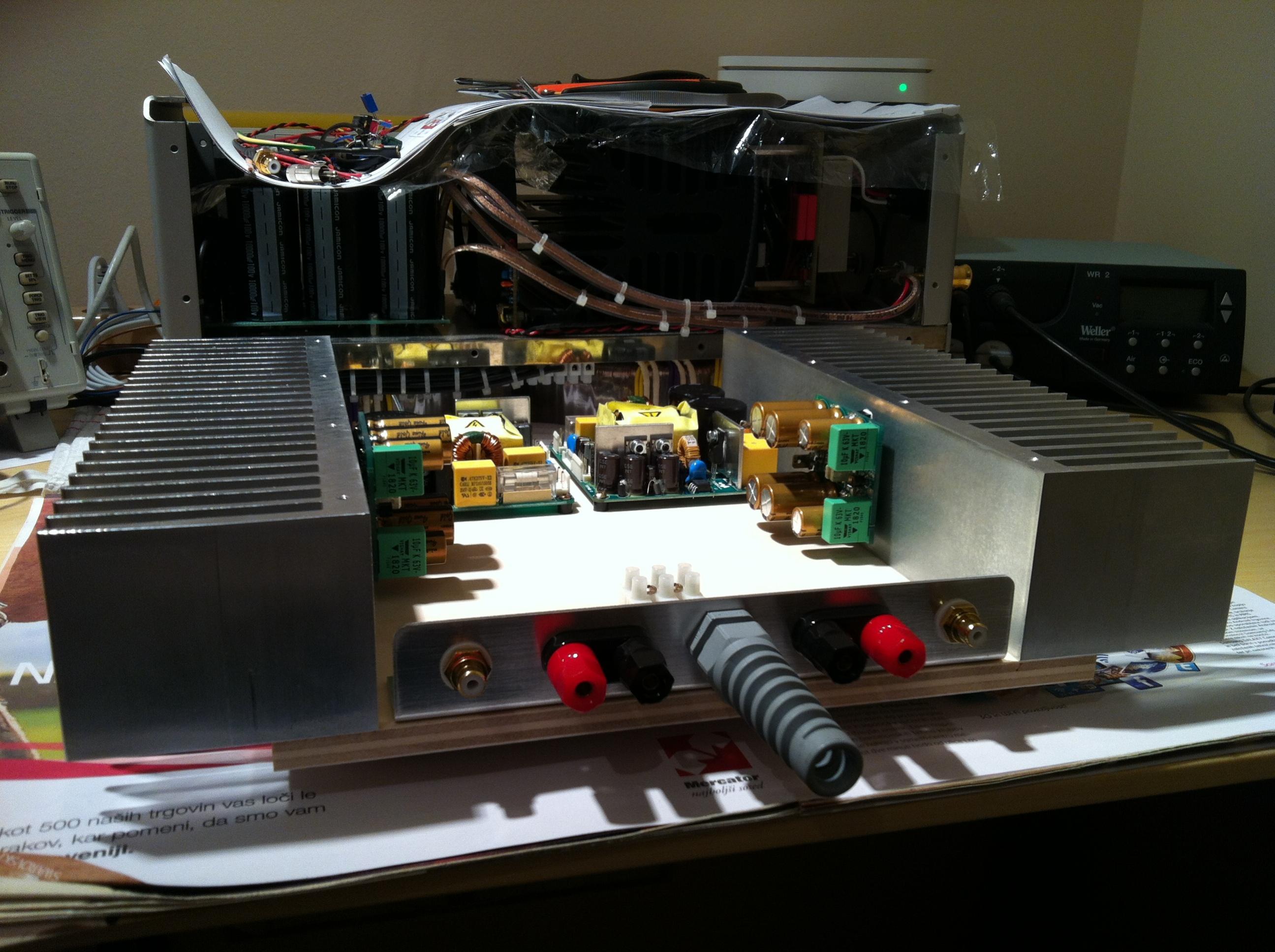

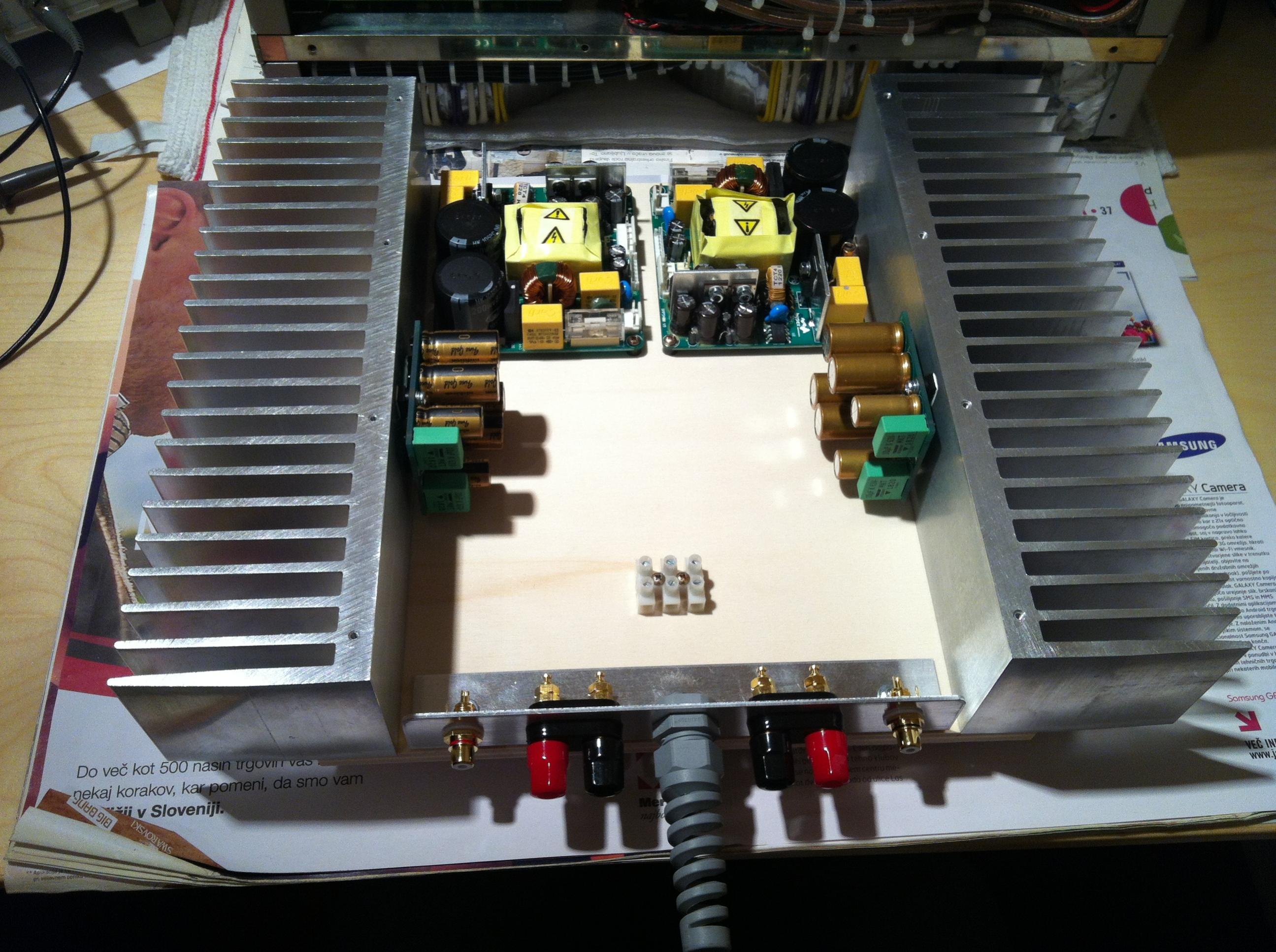

I was a little short in time this wekend, to finish complete prototype of VSSA + SMPS400 amplifier as I promised, but anyway it will happen tomorrow hehehe.

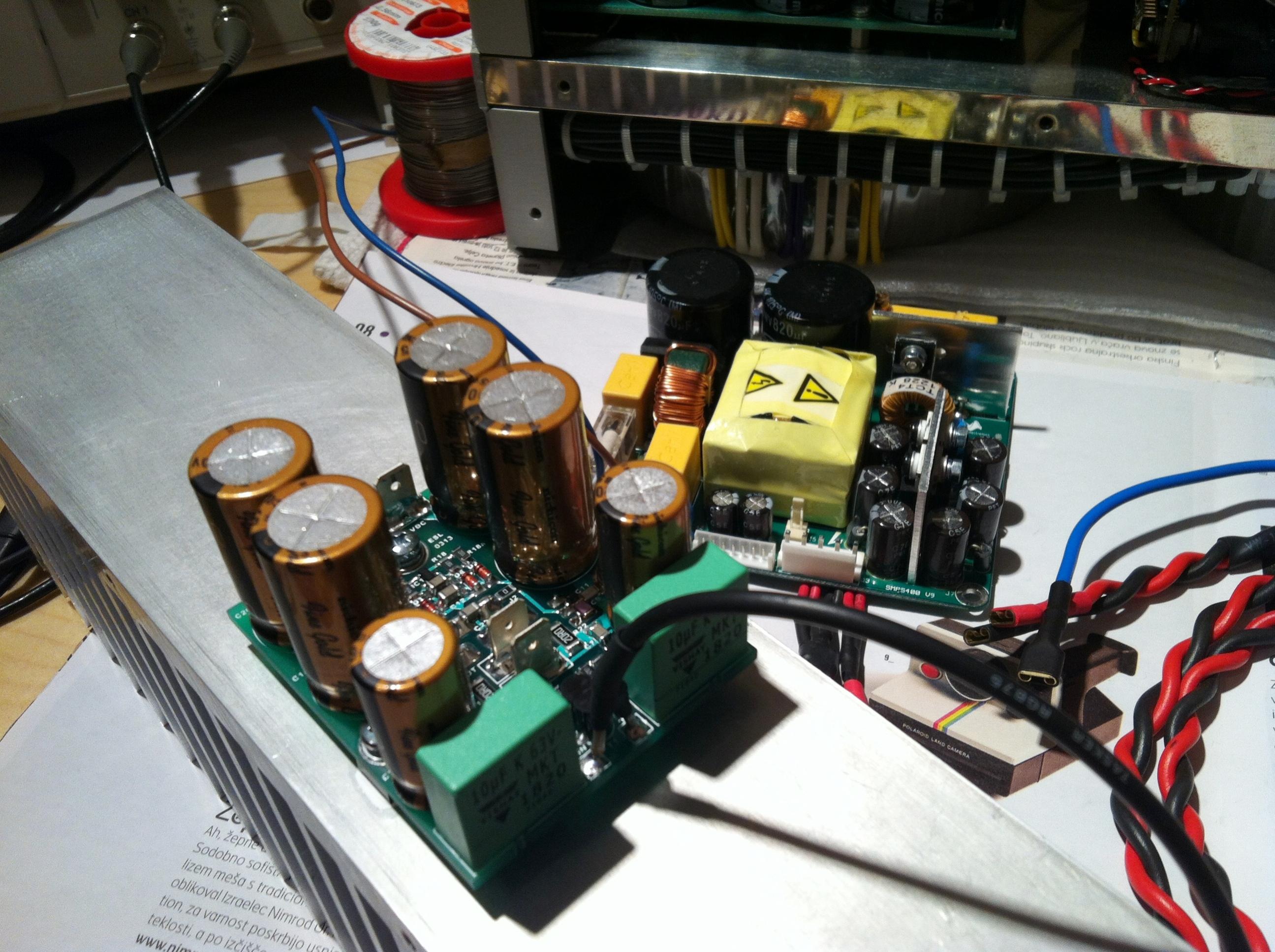

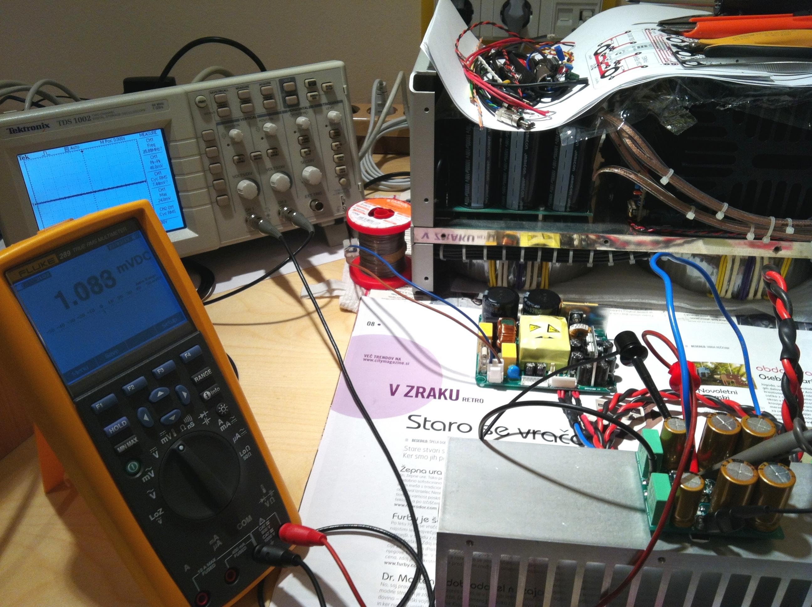

Both VSSA channels finished today, mounted on separate heatsinks, calibrated, measured and tested in combination with SMPS400 at +/-45 V and I have to tell you all that I'm really really pleased. So far all together four VSSA channels built and capability of reproducibility is very constant, no surprises at all.
To all CFB amplifier's sceptics I can only say: forget the VFB. Two major specifications they always bring to daylight are DC stability and PSSR. My answer here would be: VSSA has 1 mV stable output DC offset (pic 3.) no mater the temp, from cold start to heavy loading programme, no DC offset stability problem noticable whatsoever. Of course no DC servo present around. PSSR is unmeasurable with my FLUKE-TEK measuring equipment. Also no hiss, hum, pop up, bang, boom on/off sounds from speakers, zero, nada.
Few pics of the measuring session attached.

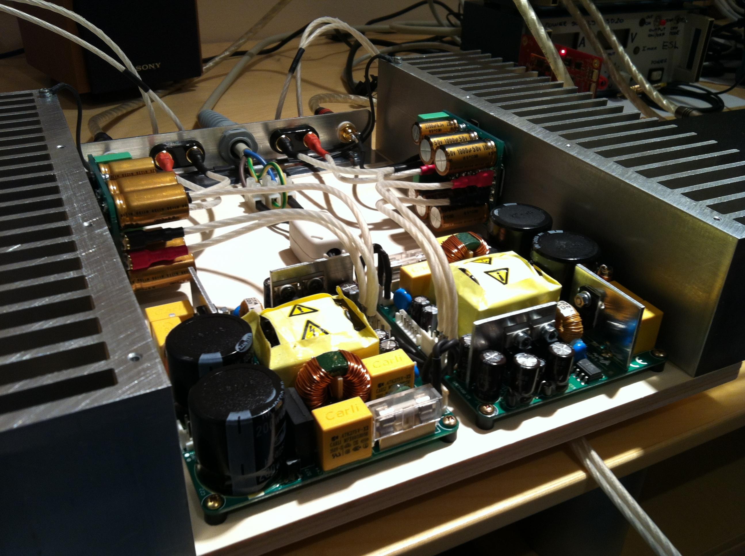

Hi guys
VSSA + SMPS400 already playing for few hours now hehe
It looks Nichicons doing their job pretty well. HR files are pure pleasure to listen to, just music.
