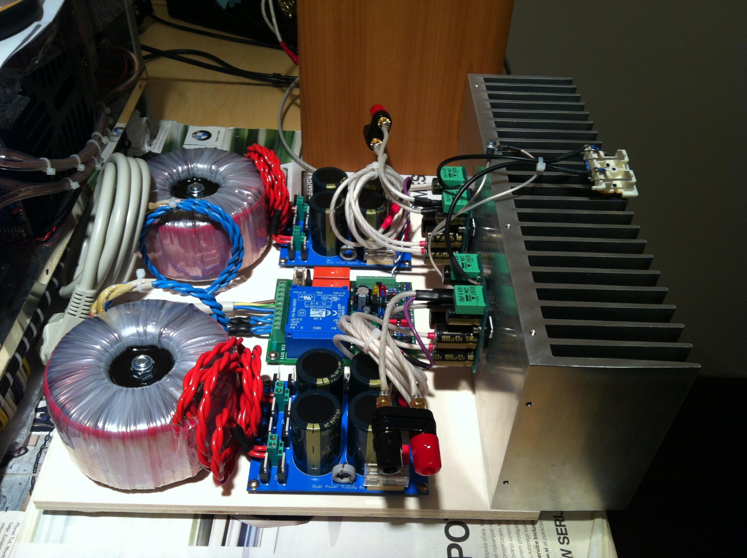

Today VSSA went to the first outside lab listening test and all I can say, it is simply the best sounding amp I ever built. CSA will gain a lot from experiences gathered here.![]()
As LC already mentioned, today was made a first "out of the house" VSSA listening session and to satisfied my curiosity, it was made in my audio system
VSSA was tested on CNO loudspeakers from Troels Gravesen. As transport we use modified NAD C541i CD player and Benchmark DAC/preamp. I have to say that in 15 years of building and modifying amplifiers, this is simply best diy amplifier, that I have ever a chance to hear it in my system.
I would simply describe it as a very transparent, detailed and (very important) fluid & musical. Listening session was long almost 3 hours and we were just throwing one cd after another into NAD player. But most interesting finding was the massive power and dynamic that comes from such a small, almost bizarre 5x5 cm square pcb . In a room of 24m2 and 87 dB speakers, we were never even near the clipping or soundstage congestion, even if SPL were above normal listening levels.
