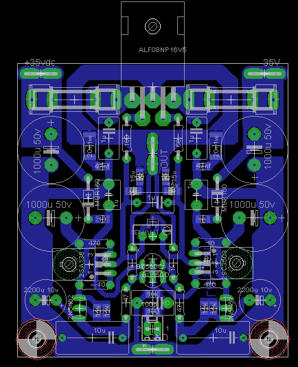

Hi LC,
The major issu for common Diyboy with you puppie will be the resistors tunning as it handel to solder CMS with those electrolytics and 10µ so near...That's why i don't know if just after TSSA BIGBT HP il will go for your neat vssa or i go for my layout. The board is bigger (73*63mm) but tricky resistors are on solder side. I have pad to solder tunning trimmer that will be removed. According to V1.4 VAS are on main heatsink and TLVH431 is present.
Marc
Marc

how cricital is CCS symetry and exact value ? , I would think to use j508/j509 current diodes , but tolerances of those are not good , 20% , 🙁
CRD-s are untrimmable and it would be almost impossible to balance DC offset and to set correct input/VAS bias current even with large asortiman. So the solution with j-fet and two fixed resistors is just optimal as enables trimming to +/- 5 mV output DC offset and VAS bias to cold start level of 12 mA. What's best it is time wear-proof since there's no trimmer present after initial calibration.
Something that would work is to get one BF245A JFET (or BF245B) for each current source.CRD-s are untrimmable and it would be almost impossible to balance DC offset and to set correct input/VAS bias current even with large asortiman. So the solution with j-fet and two fixed resistors is just optimal as enables trimming to +/- 5 mV output DC offset and VAS bias to cold start level of 12 mA. What's best it is time wear-proof since there's no trimmer present after initial calibration.![]()

What about N-channel JFETs like BF256, BF244, BFW10, BFW11 or P-channel JFET like J176 for CCS? Thanks.
Any type of N or P ch j-fet providing Id=8 mA at Vgs=0 V is OK, so when calibrated to cca. 2,4 mA as CCS in VSSA, Rgs at that point (two parallel fixed setting resistors) is in a range of 1 kohm.
The only limiting factor is Vds max, which at 2N5462 is 40 V. Solution is to put resistor in series with CCS to take few extra volts. I can consider this and implement BF245B plus serial resistor in a GB PCB since this one is easily obtainable.
The only limiting factor is Vds max, which at 2N5462 is 40 V. Solution is to put resistor in series with CCS to take few extra volts. I can consider this and implement BF245B plus serial resistor in a GB PCB since this one is easily obtainable.![]()
