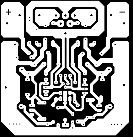

But first thing is to prepare 50 x 60 mm VSSA PCB to be perfectly DIY proof with parts available and to fit in without any nonsense.
As we all know TO-92 j-fets are commonly obsolete and unavailable so I'll put SOT-23 j-fets like BF545B to serve as CCSs from both sides of rails.
PCB is in preparation, also I check availability of ALF08NP16V5 as this is the most important part of VSSA and I think there will be no problem even if I have to order it at Semelab-TT directly.
This is current situation and progresses.
Regards, Andrej

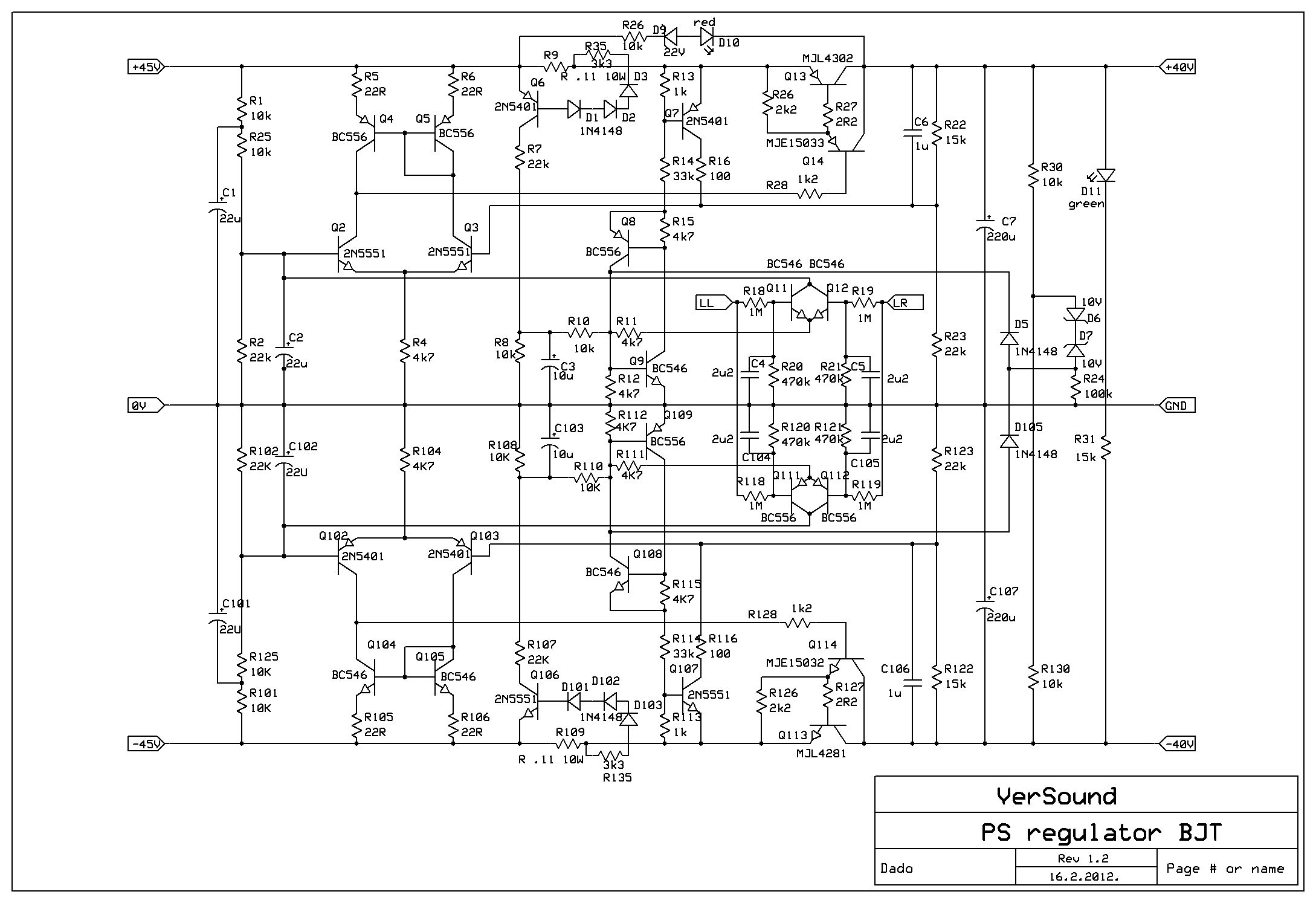

Maybe for the next release to use something as my PS Regulator. It incorporates all needed protection and acts as a capacitance multiplier.
dado
dado
Thank you dadod 😉
Looking to the complexity of the circuit it is quite clear it serves perfectly to job as it was intended. It is actually a slave amp supplying power to the master one. Maybe implemented in a High-End version of VSSA.
Thank you dadod 😉
Looking to the complexity of the circuit it is quite clear it serves perfectly to job as it was intended. It is actually a slave amp supplying power to the master one. Maybe implemented in a High-End version of VSSA.![]()
