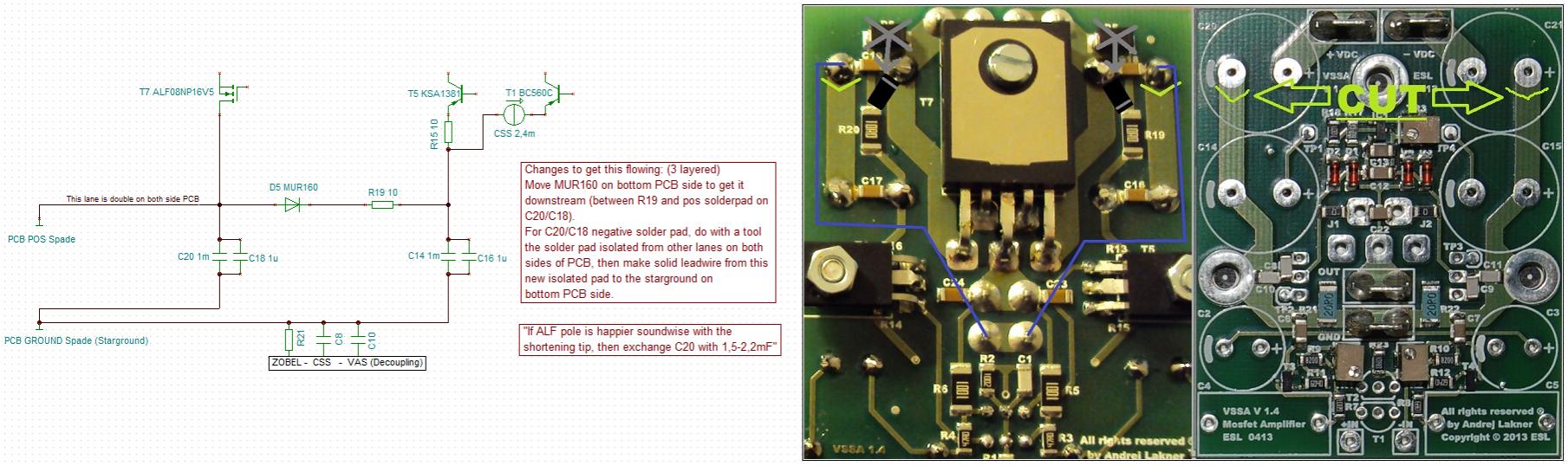

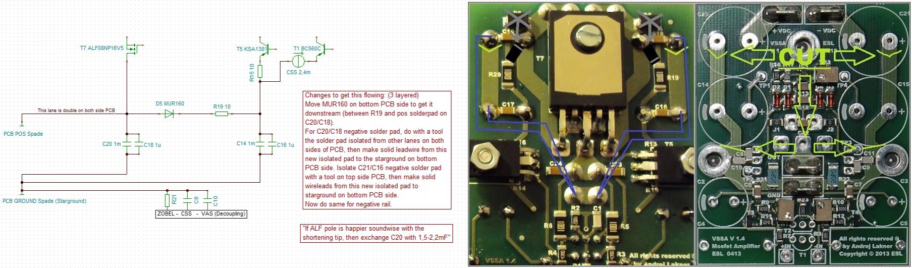

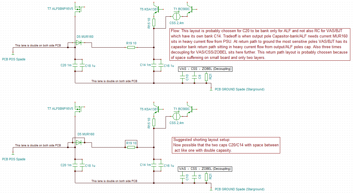

Evening post. I decoded the PCB lane routing for PSU as a schematic shown in picture 1 (See the text explanation in Picture). In picture 2 if this flow change routing for PSU lanes is done in my tubeguitar preamp, it is very very audioable. Picture 2 is best layout which i have learnt from books and experience. Picture 3 is easyer workaround way with little compromis in return path. Would it be audioable here and maybe cancel the R19/R20/D5/D6 shortening and keep concern for good PSU PSRR/CMRR in VAS/BJT input at good. Last if ALF pole is happier soundwise with the added capasitence, then exchange C20 with 1,5-2,2mF".

Evening post....
I now realyze that previous post only holds schematic if screws/washers for the two VAS devices are isolated from PCB. Else two new chasis ground think with higher Z get into circuit. Think i will isolate here for controlling ground connections path. For clearness screw/washer at PCB for ALF is floating on board, so don't need isolation.

Nice one, BYRTT. Very clever analyze. Need at least to be tested by L.C to ensure if it is worth the dirt :). (Ground tracks are so short).
Beware it can bring some evils with parasitic capacitances too...
... Or just by charging the ground tracks with a mono big enough coper wire soldered on it ? Not easy neither with SMDs across them.
This ground reference issue can explain the change noticed in the medium ? May-be. To be experienced.
To be remembered for future designs, anyway, an amp buster need a star grounding :)
Ps, i'm sure no need to any change +- power side if you keep diode+R on board. The 10 ohms makes enough difference, the distance is short and the external wires are still there, anyway...
