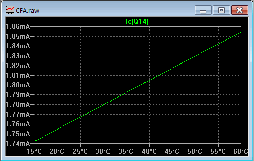

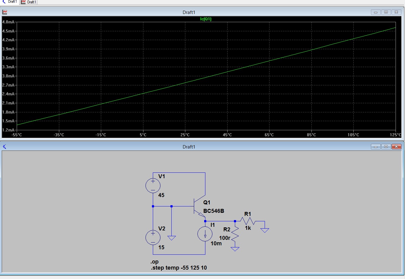

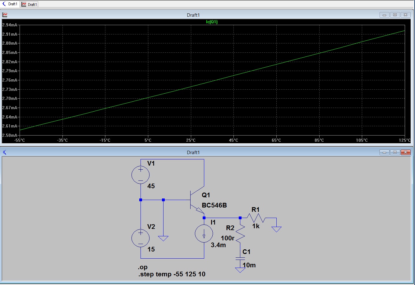

See the attachments.
You can clearly see the change in bias current through the collector with respect to temperature.
http://www.onsemi.com/pub/Collateral/BC546-D.PDF
Look at figure 1 and figure 6 wich shows the current gain and CURRENT-GAIN - BANDWIDTH PRODUCT. You can clearly see that you will move up and down the curve.
Frontend of the diamond buffer can be seen as a source, it is not part of the feedback loop. With an Re of 10R and bias of 2mA you will have an source with an impedance of ~20 - 25R for upper and the lower transistor. This is better than driving next stage directly from a source through a cable.
But i think we can continue this in the CFA thread.
