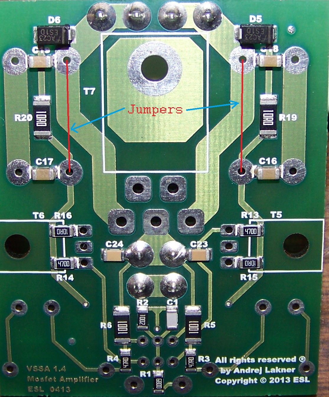

Hi Andrej Is this the amending to be done, or is there more meant in that statement from post #2245 qoute "VSSA improvement will be detaily described after all VSSA modules will be shipped out", just curious if D5/D6/R19/R20 are the baby for that improvement, or more is published when shipping is done.
About this D5/D6/R19/R20 shortening do you recommend one to make sound listening test with original setup first, and then do the shortenings with sound listening test to compare. Or is it recommended to jump to shortening setup righting the R19/R20 fast pulse problem in same amend.
Yes, this change is a major part of a recommendation meant to be proposed to VSSA owners, either SMPS or conventional PSU is used.
To be sure the change will actually bring a valuable improvement in SQ, try to compare original and shortened R-D version. 😉

Actually there are two 20 Ohm resistors in output Zobel filter. It simply got too much power dissipation in higher spectrum since it is in series with 47 nF. Probably measuring method at 20 kHz lasts too long and ...
D5/D6/R19/R20 shortening .........jumpers....

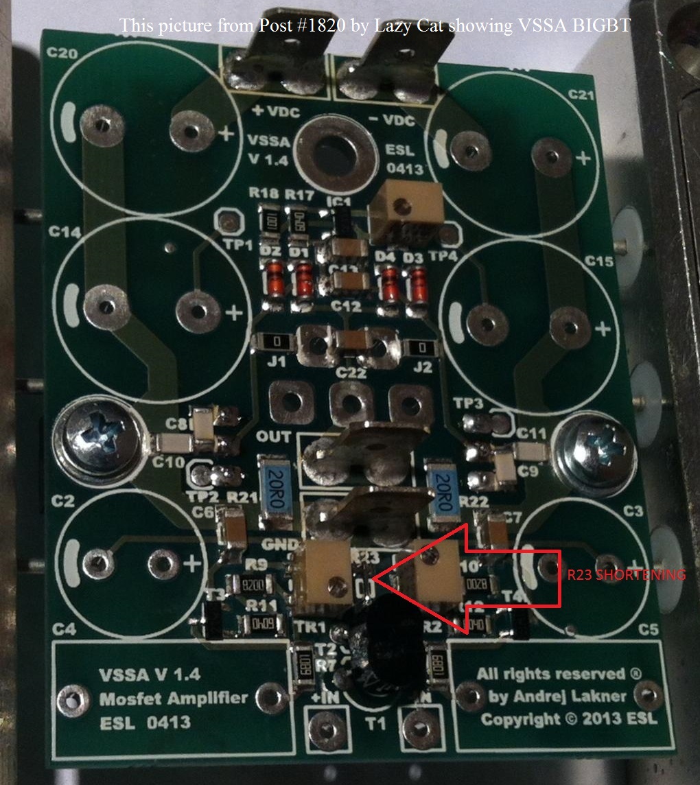

3-Desolder R23 and replace with short, see attached picture. (Input ground lift amend) (Post #1963 link http://www.diyaudio.com/forums/vend...lateral-mosfet-amplifier-197.html#post3568278, and alternative on other side of PCB Post #1971 link http://www.diyaudio.com/forums/vend...lateral-mosfet-amplifier-198.html#post3568597)

2-Shorting both R19/R20 and D5/D6 for sound improvement (Phycical change Post #2526 http://www.diyaudio.com/forums/vend...lateral-mosfet-amplifier-253.html#post3652831 and explanation Post #2501 http://www.diyaudio.com/forums/vend...lateral-mosfet-amplifier-251.html#post3651203)

Resistors and diodes shorted - improvement is quite substantial, especially in the bass, which until now has been the weakest feature of VSSA.
I also learned that Black Gate caps are not a good sonic match for the input stage.
Mine is a very modest build with a single 500VA linear supply shared between the channels. Even so, it is very, very good. Thanks Lazy Cat 🙂
