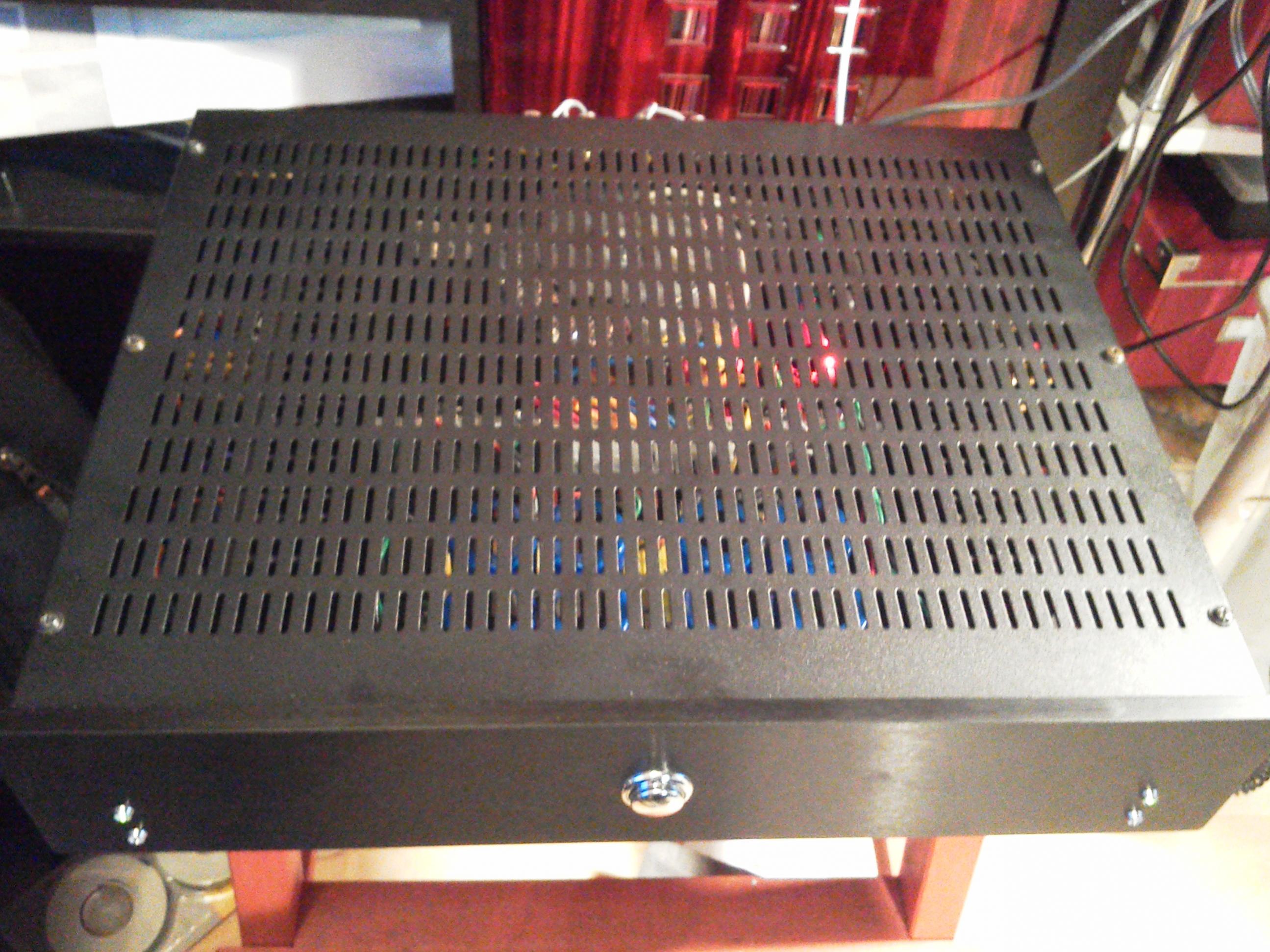

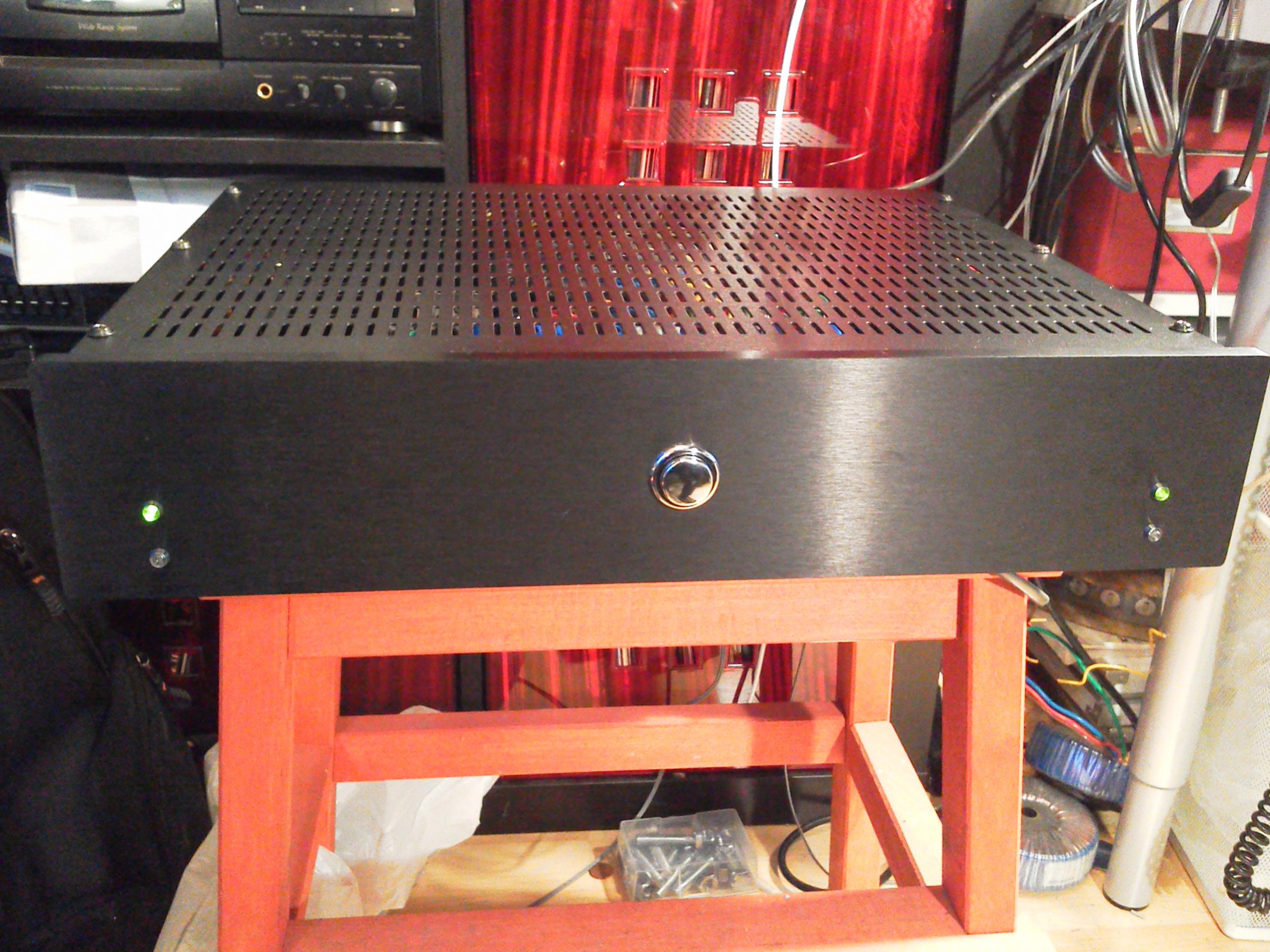

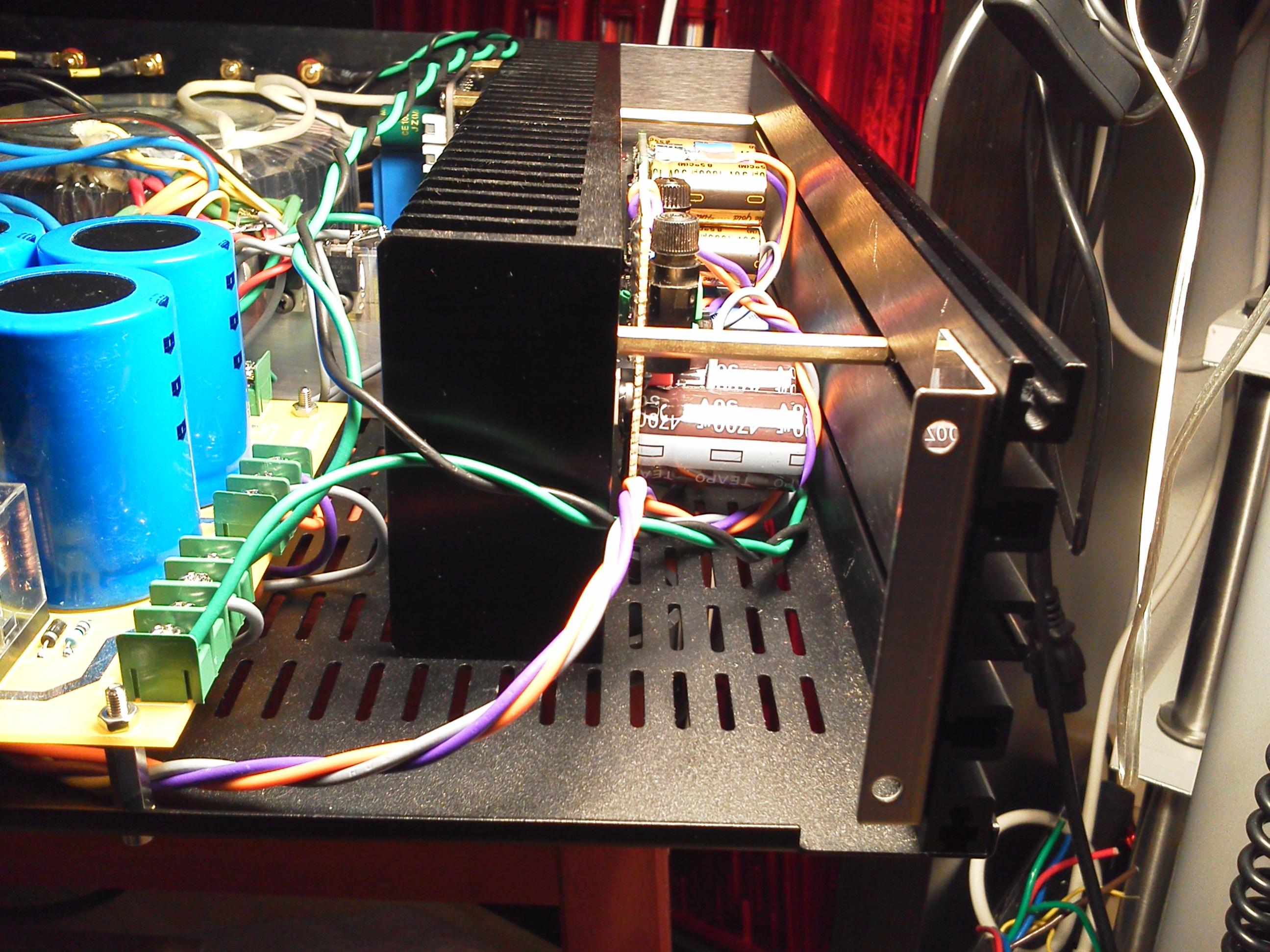

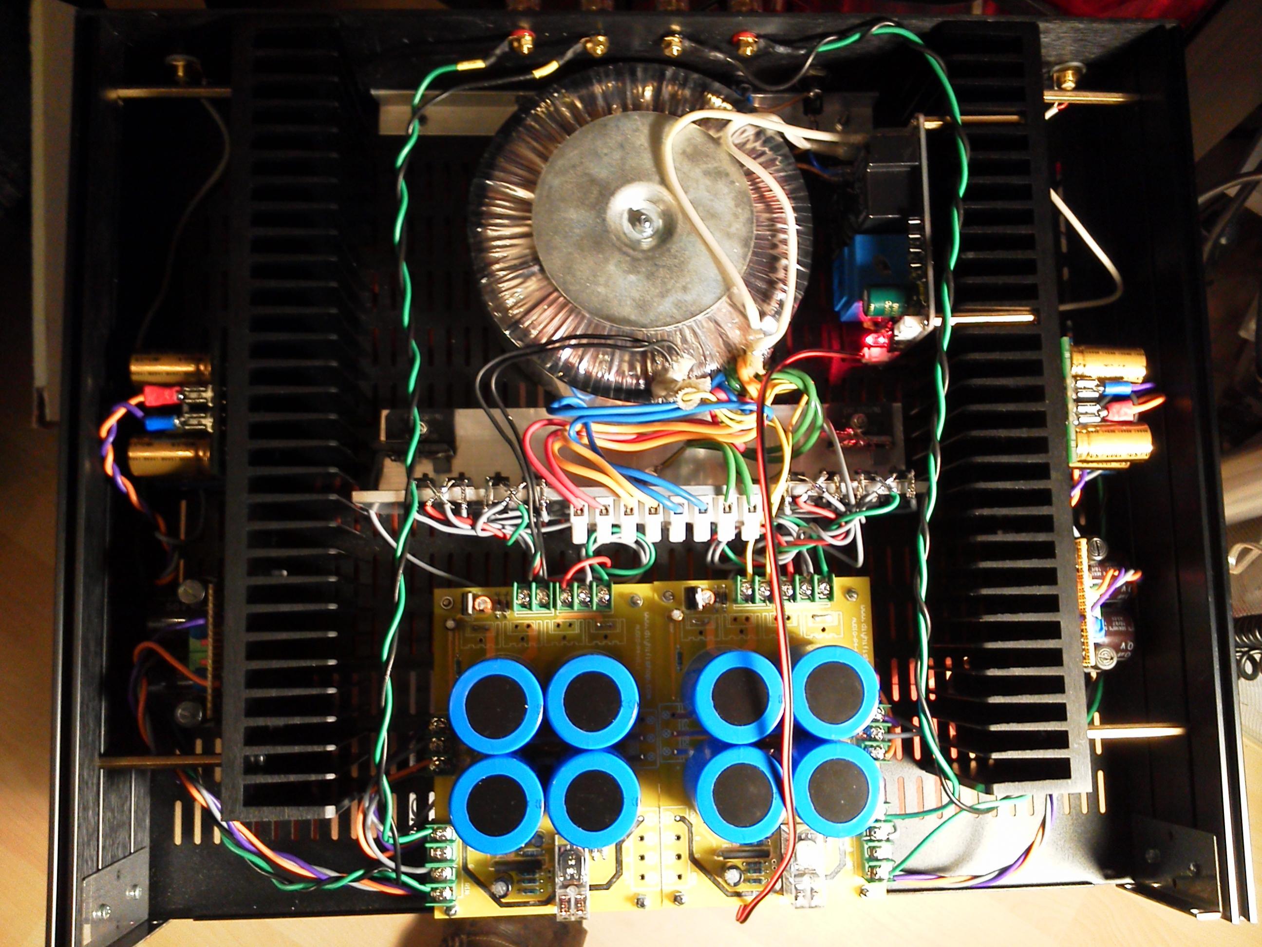

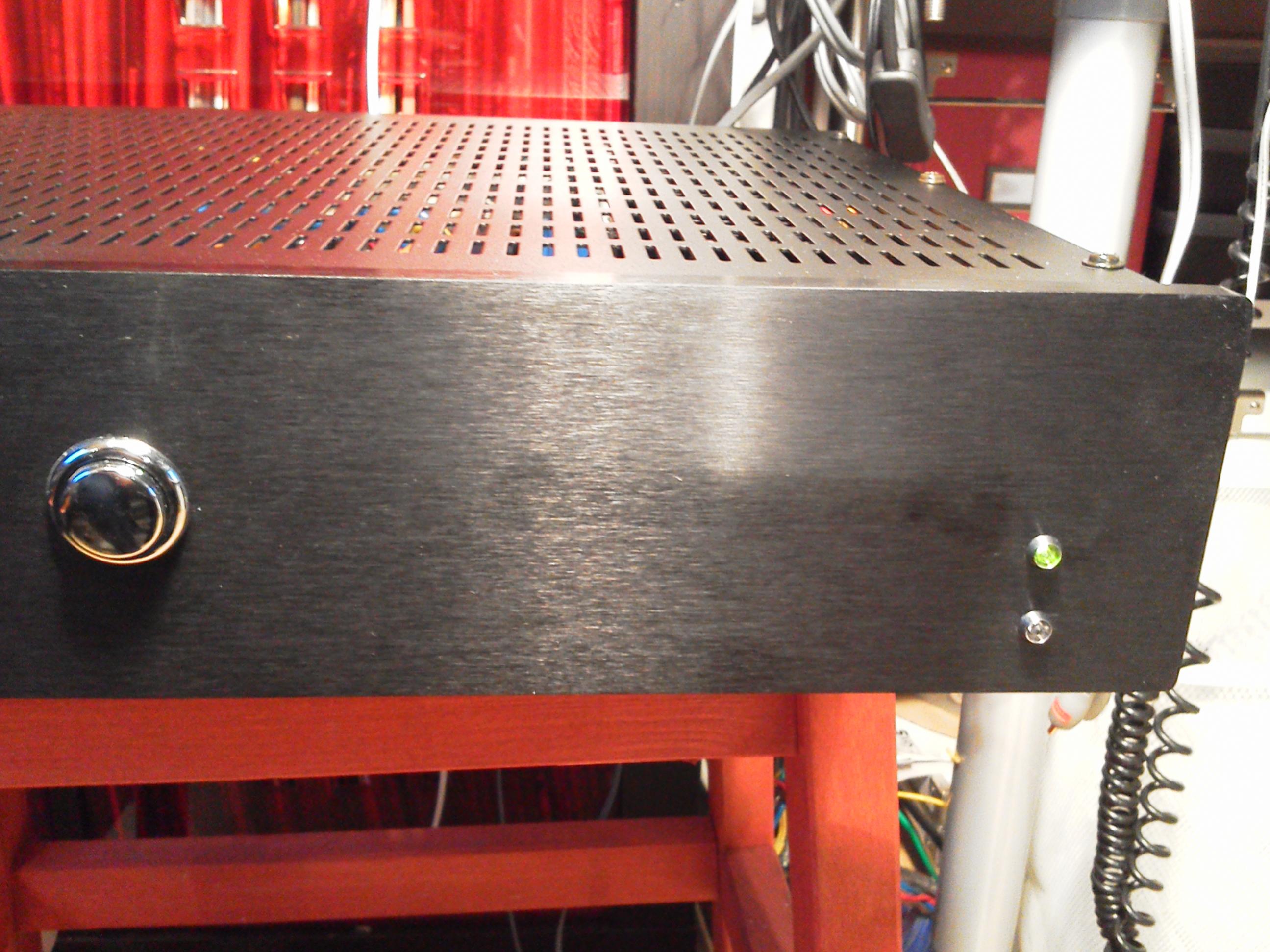

Back on topic, I add a few pictures related to show how I finished this VSSA, which is a great companion to Paradise and JC-80 analog chain. Please excuse the quality of the photos and don't laugh too much about my choice of a game console switch for start-stop (the only acceptable one i had around). 😀
Each channel has a pair of LEDs for on/protect indicators of the speakers output. The position was picked up for practical reasons, as the modushop front panel has some grooves there and it's thick enough to allow me to mount them.

Hi L.C.,
Another VSSA is finished.
I am really impressed by the sound, and in the same time by the silence when it should be 🙂 The first moment I connected the speakers I thought I have a broken cable, a destroyed connector, or something missing in the chain. I could hear nothing with my ear "glued" to the speaker. it's really the first time for me to experience this.
As posted in other sister threads, I use a toroidal transformer custom built for audio, 500VA with separate outputs for each rail, each channel. Each output goes to a dedicated discrete rectifier bridge (4x IXYZ soft recovery) that feeds a capacitor multiplier (Mr.Evil/PMI) via 2x15.000 uF on each rail. It might be an overkill, but I prefer to have more than too little.
With complete separate ground lines, I kept the GND - separating resistors on board, and i replaced by a wire each D-R group that feeds the VAS. The case is connected to each GND by a lifting DDRC group for each channel, coupled in the same point where the transformer's screen meets the chassis.
I would like to thank everyone that constructively contributes to DIYaudio discussions, and especially to Andrej for providing such a masterpiece to this nice community.
Cheers!
