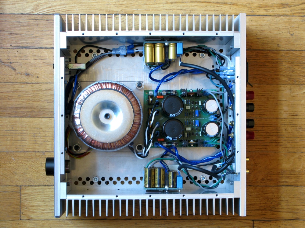

From what I have tried so far, there is definitely a benefit from using a better/cleaner power supply, but I think anyone will be rewarded with great sound with some care and normal precautions. My overall experience with VSSA has been excellent.
I have built three versions so far, including the simplest circuit proposed by Shaan in the PeeCeeBee thread, another version close to the 1.4 rev schematic, the third one being the modules from this thread.

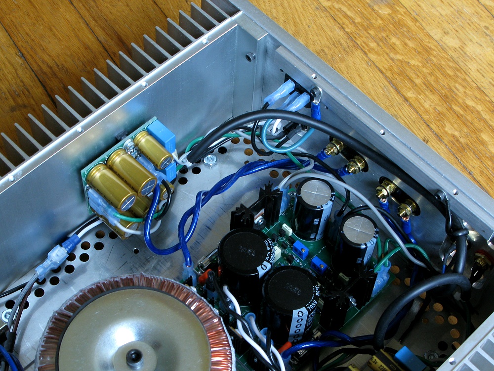

The pics below are the VSSA modules from the first GB, with my version of Mr. Evil's Capacitance Multiplier power supply.
Same circuit Metallicus mentioned in Post 2580.
Heatsinks are from HeatsinkUSA.com, one of the advertisers on diyaudio.
Transformer is plain vanilla AvelLindberg 330VA/25V.
Power supply voltage is adjusted to +/-36V at idle.
One of these days I hope to try a version with a separate supply for the front end as Esperado suggested above.

Seriously, they all sound remarkably good. At low-moderate volume, close to identical. At moderate-high volume, Lazy Cat's modules have the edge, however that was also with a different transformer and higher supply voltage so perhaps not a completely even comparison. I left that configuration direct-coupled, but it is isolated from the heatsinks, and uses a single supply, and one common ground point.
The other two have series caps in the input. I posted pretty extensive test results for one of them, including scope pics both here and in Shaan's PeeCeeBee thread, earlier.
The version built according to the 1.4 schematic is almost indistinguishable from the SMD modules. Mine is maxed out at about +/-36V and 50W, but a local friend built the same circuit with different parts, and it rocks the house, with only moderate dips in the rails. It uses the same BC550C/560C, and KSA1381E/KSC3503E transistors as shown in the V1.4 schematic, and Renesas 2SK1058/2SJ162 in the output.
I should also say that it takes a really good pair of speakers to make a fair comparison, and I have to take two chassis to a friend's house to do it, which makes it a bigger task.
I based my earlier comment about the power supply on tests done at lower power levels with a linear regulated bench supply at first, and comparing to what I could muster up at the time. This led me to the circuit posted by Mr Evil, and since then other people who have tried it had similar success with it. To date there have been four different versions of that built and tried (that I know of) including what has been posted here.
Overall, it has also taken a lot of tips and comments from various people here and elsewhere to get to this point, not to mention the early demise of a couple Latfets... 😀

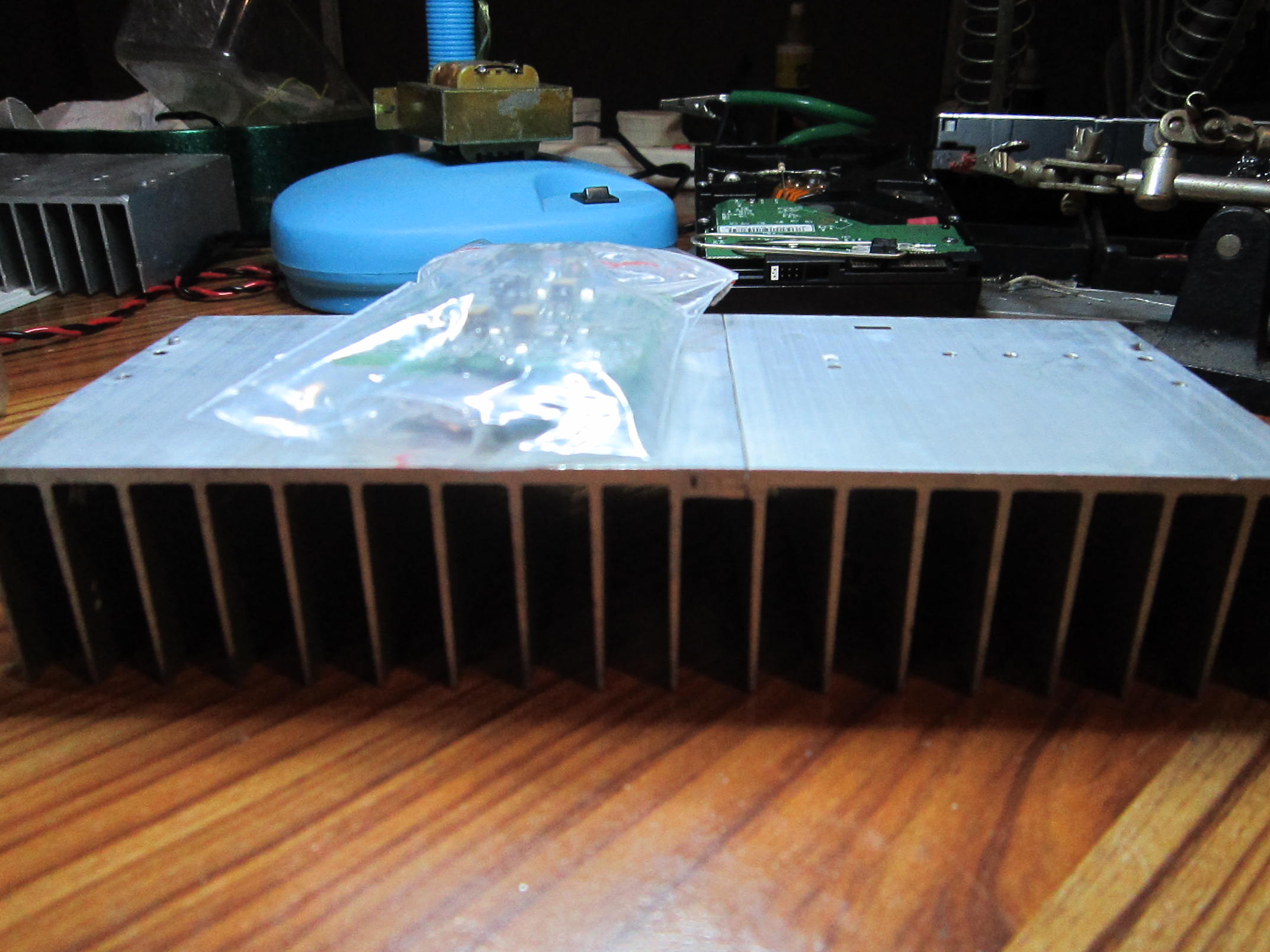

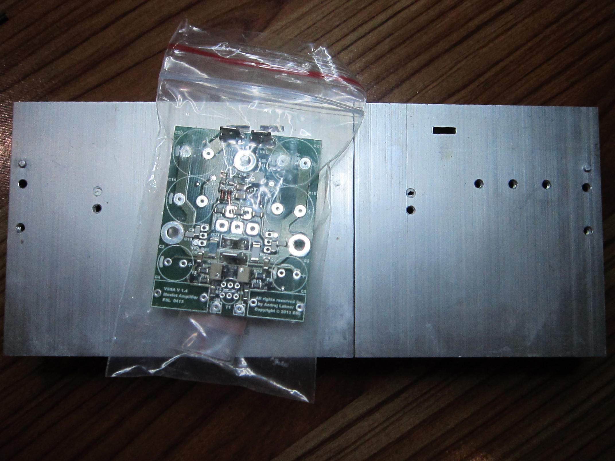

Please advice ----Is this heatsink suitable ?
I am starting the assembly.
Is this heatsink suitable ? see pictures
It is 21cm w and 9 cm depth and the fin is 4cm in height,
The back plate 3mm thickness.
transformer 0 and 35 V ac x2--300 w
intended application : speaker is 89db/w . room about 2000 cu ft. aiming for 105db peak.
thanks

The heatsink is probably just a bit smaller than the 0.5C/watt that LC recommended, but about the same size as my two heatsinks (~25 cm x 10 cm base, with 26 2.5 cm fins). My heatsinks get only moderately warm in normal use. Do you have one heatsink per module, or just one for both modules?I am starting the assembly.

However, that transformer will produce a higher voltage than the +/-45V maximum listed in LC's documentation. Assuming a conventional power supply with a rectifier bridge and caps, the DC voltage will be around +/-49V, plus about 5% at low load., so perhaps up to 51V, not taking line (mains) conditions into account.
Calculated as follows:
35AC * SQRT(2) - 1 diode drop x 1.05 load regulation ~ 51VDC
5% is from the published load regulation of my 330VA transformer, at 60Hz and 115VAC mains voltage (you may want to look up the correct number for 220V/50Hz). If your mains voltage is on the high side (like mine for example), then you have to add another 1-2V to the result.
I am not sure exceeding 45V by that much is a good idea, but perhaps someone else has a more definitive answer on that. In any case, I would make sure ahead of trying it.
A possible solution might be using a different pair of input transistors, instead of the BC550/560 which shipped with the modules.
