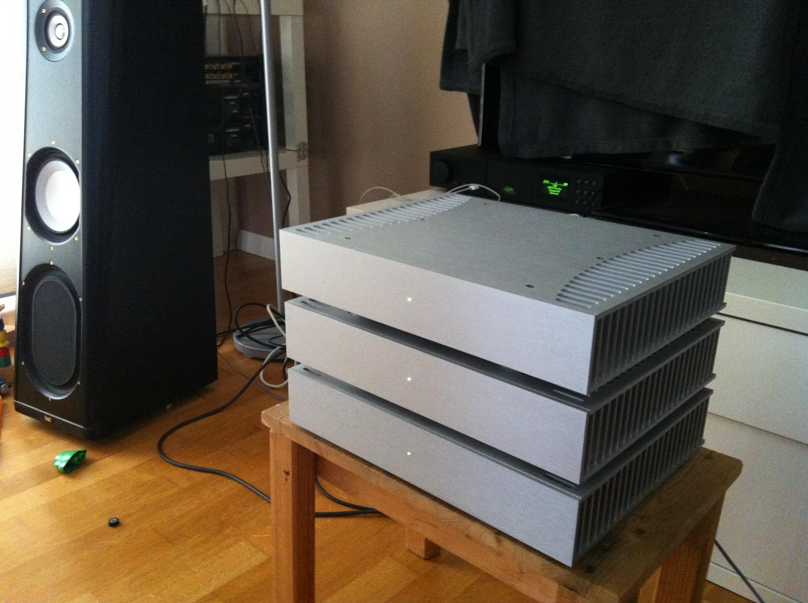

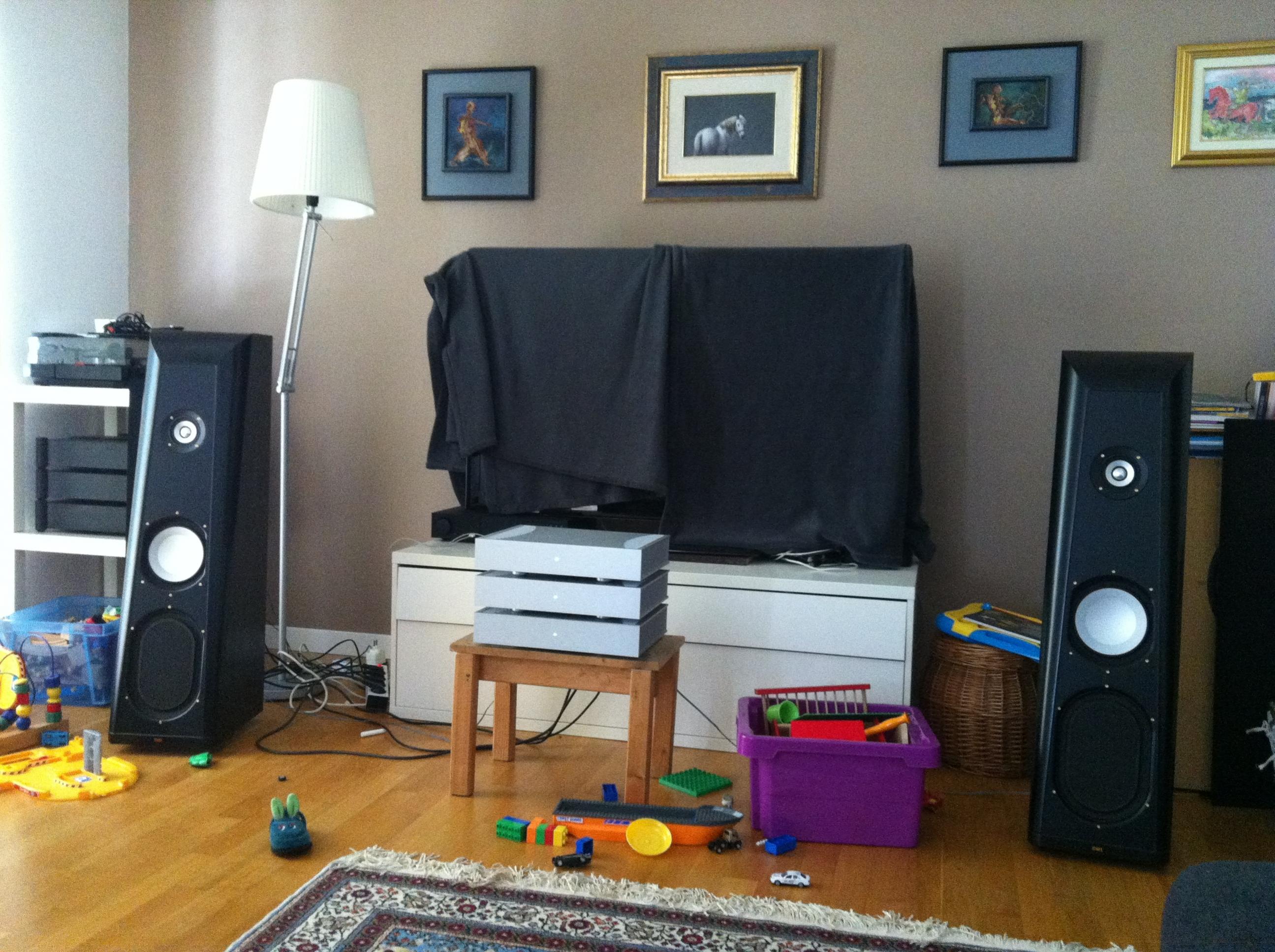

VSSA major SQ improvement
Today's VSSA shootout brought some very interesting results hehe :up:
