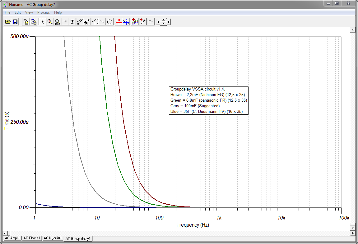

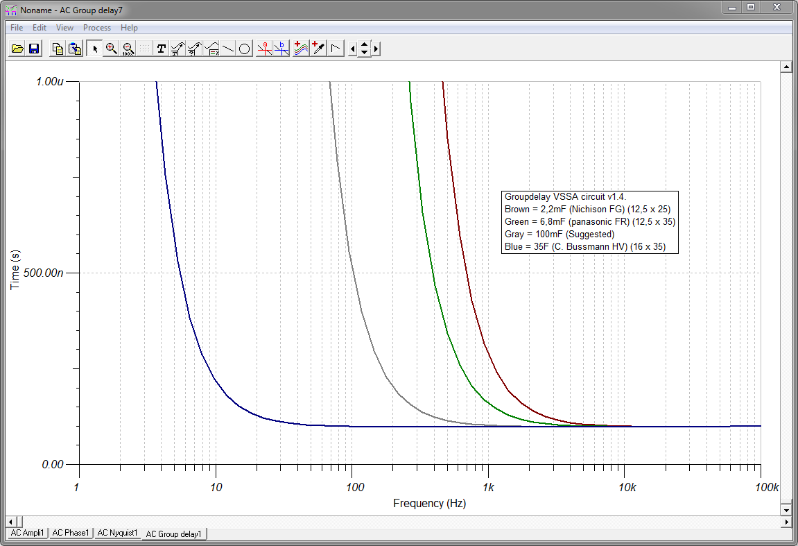

Well, i thought about this and made some sims. (Can interest L.C. as well).
Considering the few DC mV on this cap, it would be interesting to try a super/ultra capacitor (double layer) here and listen if any difference?
Thanks and interesting, Andrej said we can leave the 10uF MKT out if one likes that sound as best. But that is with the 2,2mF alone, what happens if one goes huge with a example 35F alone, what happens up higher where such huge cap has less bite because of induktor effect.
My eyes is on Cooper Bussmann HV 35F ESR 0,022 at 1Khz. My concern is that it is not tested in the VSSA setup, and do i have skills and equipment for measuring in live setup ?...
I have bought 6,8mF FR ø12,5 that i will test at some time alone without the 10uF MKT.

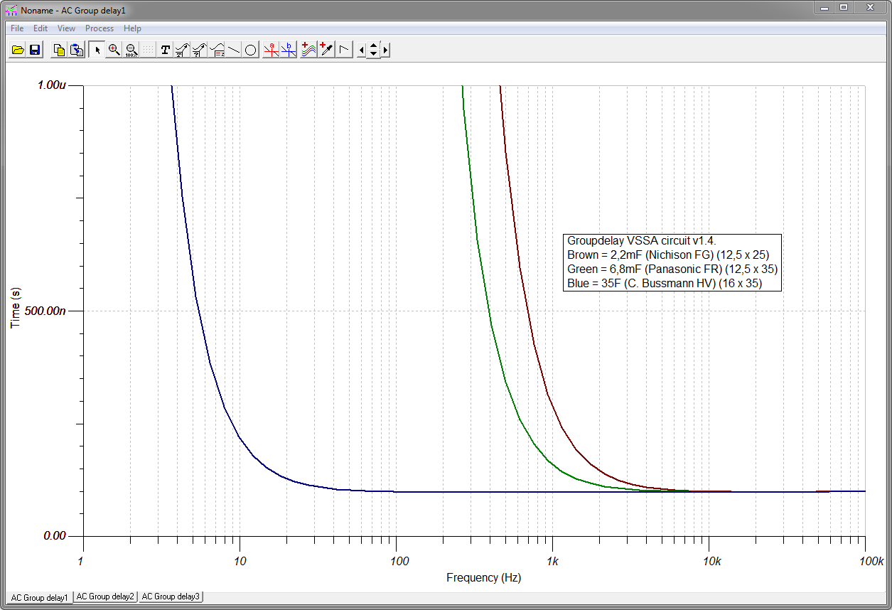

I attach nice images of simulation for groupdelays with vertical 500uS and 1uS, when looking on 1uS vertical it would be nice to have 35F to be stable in circuit for high end folks and studio setups.

BRITT, you have to figure-out the sensibility of human ears to group delay vs frequency is max 1ms at 3Khz. (we are more sensible to the differences to localize) While, down to 500Hz, it is > 3.5ms increasing of 0.5ms by octave while the frequency decrease if i remember well.
I doubt any phase correlated difference can be noticed with anything greater than the original 2200µF here.
On the contrary, i wonder how long your monstrous 35F cap will take to be fully charged with a 2.5mA current source ?
My 100 000µF value was chosen to get a flat distortion curve. And i believe anything more is both useless and will only bring negative effects.
Christophe you are probably right and know much more about electrically goods and bads, and maybe it is impossible to real world. I admit i haven't heard VSSA yet, but working on the building process.
But i know my current setup is pure DC means coupled and sounds great, and have some country recordings "Elvis Presley and Willie Nelson" which have very low rumple errors which sounds real and great in that setup. This is why i care for the lows timing because every time i put caps in my present setup even with a corner frequency like your 100mF the realness in those recordings gets lost, and that is why i "dream" do overkill with the caps.

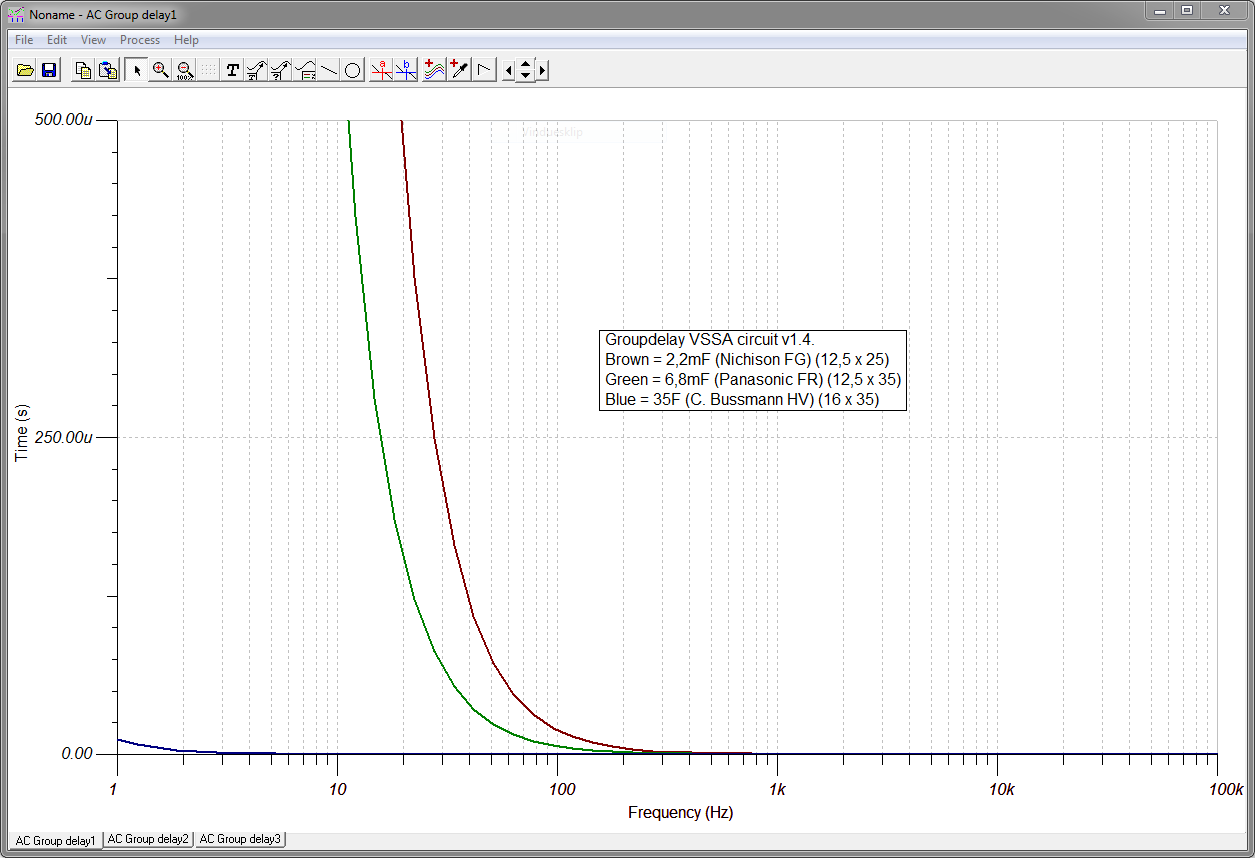

But think you must admit it is a nice plot with those 35F caps, i attach new plots with added 100mF. And one plus with 100mF or 35F is that the DC biasing level at position would be stable even long after amp turnoff 🙂.

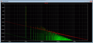

My concern was this (see attachment), where red is 2200µF and green 100 000µF.
Looking at your plot, and at 30Hz, we can see 100 000µF give a real 'no delay'.
To compare with the best enclosure i know, in this domain: http://www.moonaudio.fr/Photos taille affichage/group delay.jpg
May-i suggest you use a 5ms scale, and consider anything lower than 1ms as not a concern.
It is just like looking at harmonic distortion numbers lower than 0.005%.
There is many things more important, omho, like resonances, inductances and ESR of the caps at this critical position.
More interesting is the way those caps will "sound" in real, and that can be decided only after careful listening sessions, as L.C. do.

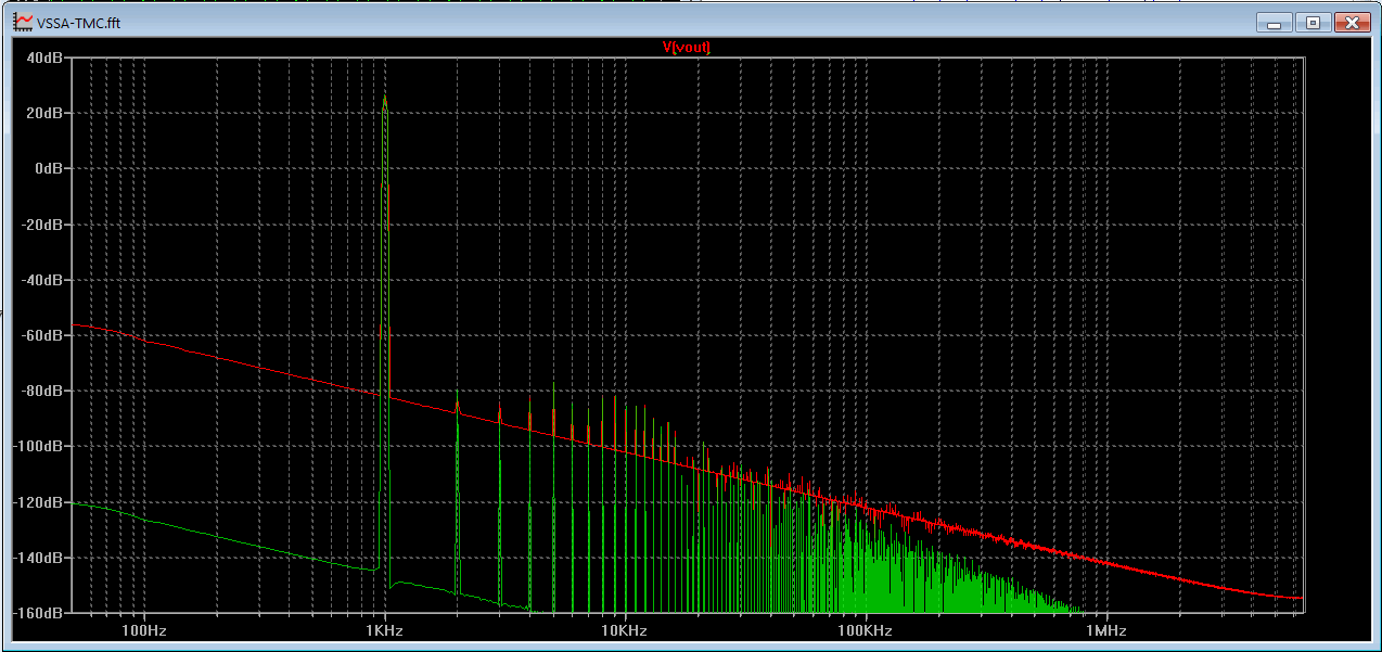

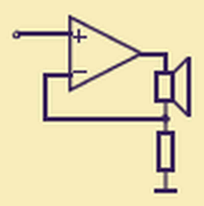

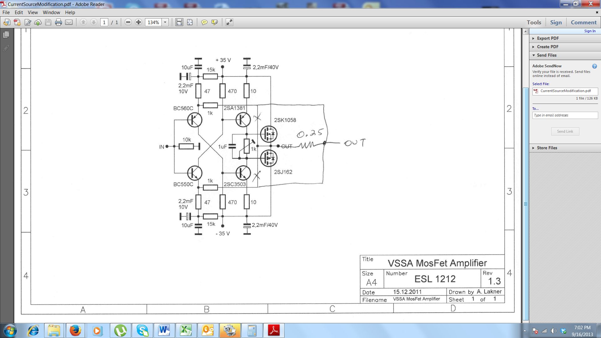

I would like to change global feedback of my VSSA breadboard to make the amplifier into a current source. Is it as simple as placing a resistor between the output and the speaker and moving the feedback point to that junction? Sort of a Howland Current Pump modification?
I'm curious. What for ?
padamiecki said:
...but I am not sure if vssa will be stable after this mode.
Can be, but very tricky, depending of the load: Need some luck with the load and careful adjustment of feedback serial resistances.

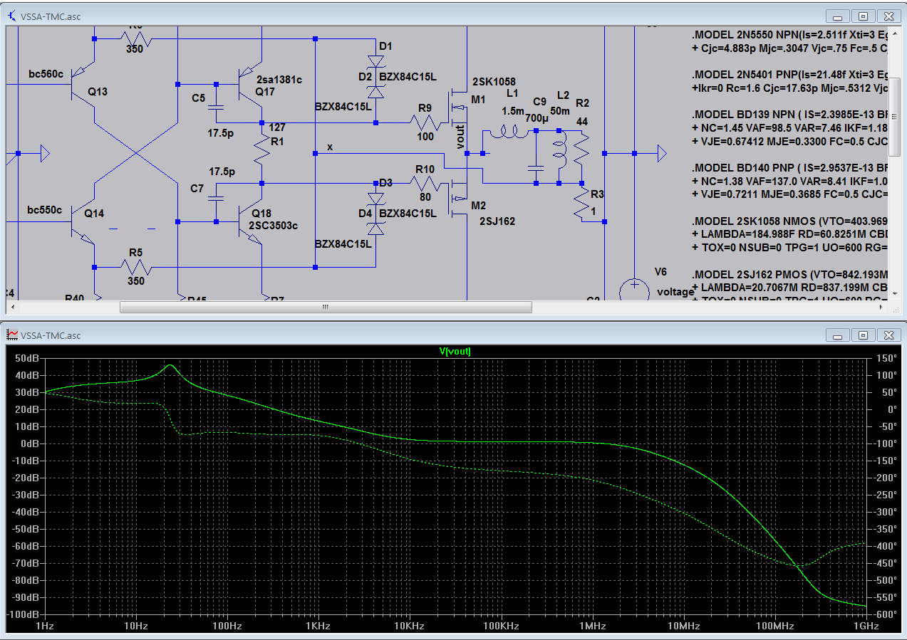

Simulated bass loudspeaker as model, see attachment.

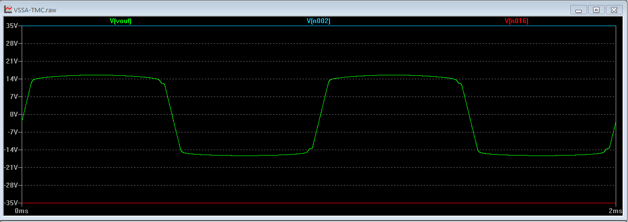

I got very strange result on pure 6 Ohms (+1) resistance load and sin in input:
[edit]Trying a little further, the response is no, you can't.
Need too much mods, as you can 't reduce enough the serial feedback resistances: It has a direct influence in currents of the amp's input stage. Such a project would be possible, but need deep modifications. Better try an LTP (VFA) Amp for this kind of project.
Hacking the VSSA for such an usage may looks like breaking a diamond Jewell to make a PU needle ;-)
