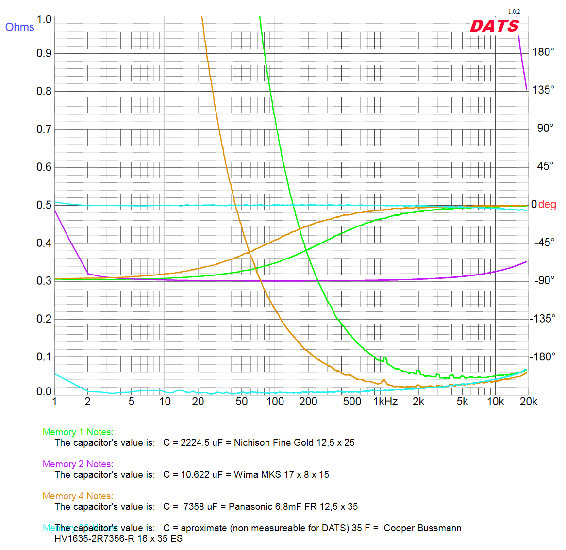

For members interested in the two feedback caps AC behave. Done simulation before, but here is realtime measure of caps AC behave in feedback position. Maybe best to download picture to be able to study better (zoom in/out).
For Esperado: see lighblue line and please don't shoot me :no:, but maybe help suggestions to get it stable in higher band. Like motion feedback on speakers, i think it will form the sound envelope presented, but last is what i think now, realtime trials later has to confirm or shoot it down. Those two caps for lightblue plot was awfull expensive at RS, but Digikey has better cost.
I'm just curious to read your comments on your listening results. Why to shoot at somebody dreaming of perfection 🙂

Just ironic about the shooting, reality was that your knowledge about trouble with that cap size is true up against my dreaming. Look at phase plot for the cap at high end. Phase looks like falling as leaving audio band where my measure unit can't discover behavour anymore. If it's because it becomes an inductor there with increasing AC impedance it can't sit there alone without a clever helper network to amend misbehavour. I put this cap on hold untill later, just bought two with other bits and got positive over the AC plot, therefor post/sharing.
Yes, you just measure the wire's inductances.
