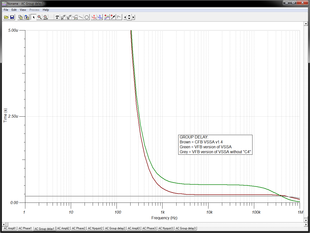

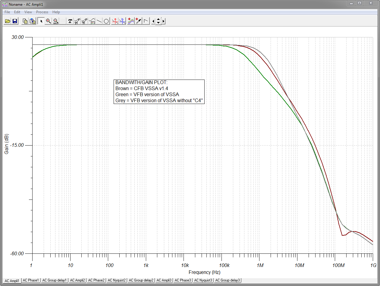

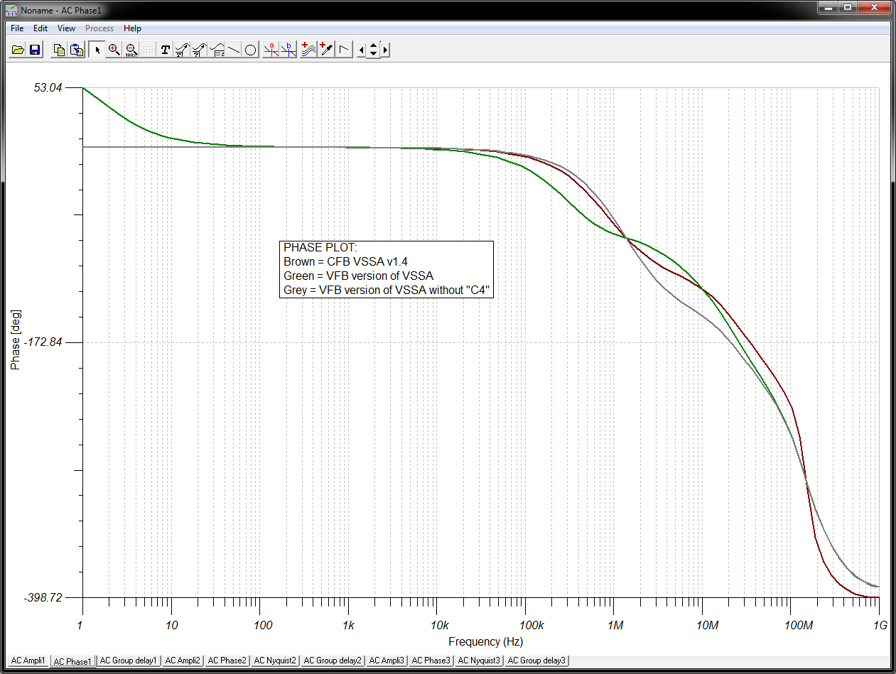

Hi Christophe and Andrej i have run simulation with Christophes circuit schematics for CFB and VFB which i attach as images (Thanks for the link Christophe).Esperado, you are a great friend, happy to have you around here, my admiration to you.
This is a great contribution to this thread which will help many of us to understand the topic even deeply by your step by step presentation. Many thanks for your will and time spent.![]()
When i remove "C4" from the VFB version it outperforms the other two except distortion.
Bear over with me i am hobbyist so only few of your knowlegde, but will the setup without "C4" be possible to realworld ?.
The models used for VAS and Output devices are not real manufacturer models but generic types from TINA program, but precision should not matter because the three simulations are compareable.
So Andrej should we buy a pair of BC550/560 and few resistors for tuneup ?
Regards Ricky
Hum...Did-you measured slew rate ? I doubt there will be a big change and that's the important point. I mean, that makes all the difference in listening experience, witch make some prefer current feedback amplifiers.(on my point of view)When i remove "C4" from the VFB version it outperforms the other two except distortion.
will the setup without "C4" be possible to real world ?.
We are not fighting about bandwidth witch is anyway killed by the input low pass filter. ;-).
By the way, this comparison is on an educational point of view, to make discover some things about current feedback, and kill some urban legend about more noise and distortion, as an example.
Without the cap, i doubt you can have a decent DC offset. And the cap is fair in this comparison, as it correspond to the C4 C6 of the VSSA (same response curve in low frequency).
I have to apologize, i made a little error with the input stage current: i did not took in consideration the currents used by the feedback path in CFA. I had spend some more hours to tune the VFA to perfectly match the CFA, both in gain and current in transistors of all stages. Guess what ?
The distortion of the VFA worsen. 0.001059 at 1000Hz. (it was 0.000978)
