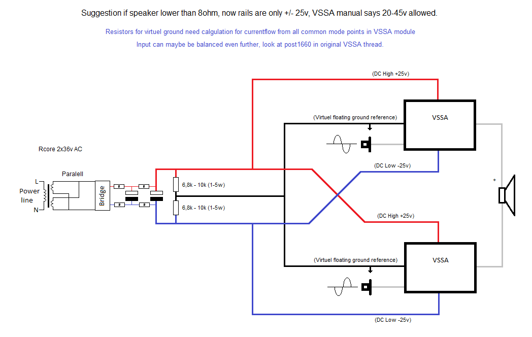

Hi Christophe, suggestion.
Now you have the sim file try make a copy and do the balanced version.
I have got balanced sim version up and running fine, details below for config:
1 - I used the simplified schematic that i attach as image.
2 - I used metallicus69 schematic for 2,2mF caps crossing, see link http://www.diyaudio.com/forums/vend...lateral-mosfet-amplifier-166.html#post3539303 #1660
3 - In the sim program i had to ad a virtuel ideal transformer (1:1) which primary pins were routed to pos amp speaker out and neg amp speaker out, and then secondary pins got ground and speaker out route. Else the sim program made strange sims because of pos/neg speaker out were referenced to ground.
In my sim it starts clipping, one standard module ~38,4V (8 ohm 2x45V supply), and in above config balanced, clipping starts ~75,8V (8 ohm 2x45V supply).
Christophe you can get copy of sim files, if the before mentioned sim program suits you.
Ricky

BYRTT, nice idea to simulate bridge, while i suppose there is nothing more than Harmonic Distortions to be enhanced and showed in sims (and PSRR if we try).
On my side, i use LTSPICE, but i'm both not very experienced in sims and not too much interested by them: I prefer real life 🙂
Will try to explore bridge operation of this amplifier, once i had finished a special mission: to compare it with a VFA version for educational purpose.
About the cap crossing, i worry about the increase of their voltage.

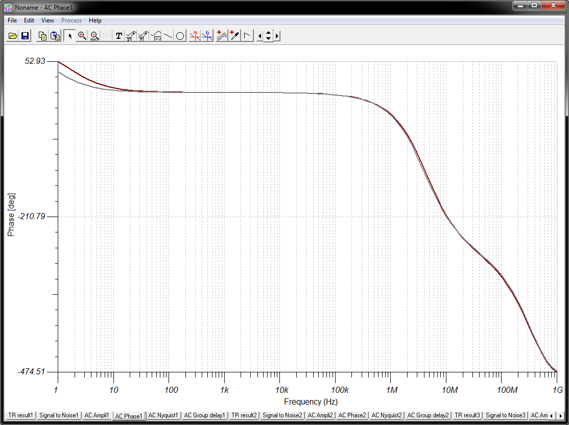

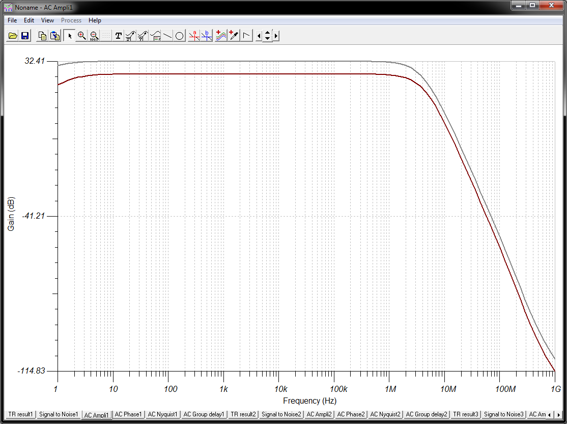

Post 2245: Heres sim data for measured voltage over mentioned caps.
Input 1,7V (+/-) sinus 1000Hz +/-45V rails 8 ohm resistor load.
Single module: 0,8V DC/2,44V AC
Balanced modules: 1,6V DC/2,58V AC
Input 1,7V (+/-) square 1000Hz +/-45V rails 8 ohm resistor load.
Single module: 0,8V DC/0,8V AC
Balanced modules: 1,6V DC/1,6V AC
Looks okay, maybe they need to be nonpolar ?
Groupdelay gets better when caps crossed, but then they also sits in their own Little floating virtuel ground spot.
Heres sim for single module verse balanced version configured as mentioned in post 2244. Sim program Tina Texas Instruments (v9.3.50.40 SF-TI) downloaded free from their website.
Brown trace=single module, gray trace=balanced modules
Picture 1=BANDWITH/GAIN
Picture 2=PHASE-PLOT
Picture 3=GROUPDELAY
BR Ricky

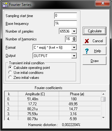

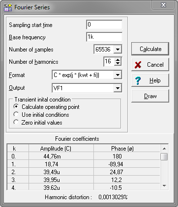

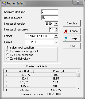

It would be interesting to simulate harmonic distorsion and levels of them in balanced and single ended VSSA version...
What comparizons ? Same total power harmonic distortion ?It would be interesting to simulate harmonic distorsion and levels of them in balanced and single ended VSSA version...
I believe the main benefits will not been showed by sim: PSSR, RFI/RMI immunity, etc.
Oh, no. double size and sometimes less quality.Looks okay, maybe they need to be nonpolar ?
On my side, i'm not tempted by this arrangement: it makes the build less easy and even tricky, the two side of the bridge will be no more independent, on a physical point of view, a risk to have longer lengths to caps, more risk in case of failure etc.
Quote: 2247-2248
Hi here sim for single ended verse balanced version. Because i am hobbyist i don't at present have skills for the setup of real technician bench for distortion test, so i use the in program built in Fourier Analysis
For remarks it should be said KSC/KSA and ALF devices are not built in the program, so its a generic types used.
For all sims input is 1,7V (right before clipping), rails +/-45V, load 8 ohm resistor.
25.07V RMS out single ended = 78,56 WATTS.
50,13V RMS out balanced = 314,12 WATTS (From others this should be real world 2,5 x single ended) so balanced gets real world 196,4 WATTS.
Picture 1=Single ended v1.4x schematic
Picture 2=Balanced v1.4x schematic
Picture 3=Single ended v1.3 schematic
Picture 4=Single ended v1.4 schematic
The version 1.4x schematic is compiled of info from this hole thread, it should be close to the shipped copyrighted layout version. It can be seen from v1.3 to v1.4x in very small distortion digits the fixes for real world safe funktion.
