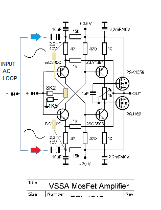

Hi Roberto
I am hobbyist so leave deep tech talk to you specialist, especially when it concern DC servo's.
But i think i can read funktion of your trimmer that is simple and match simpliness of VSSA design, seems to do Wonder for symetri and Groupdelay at lows.
If i do it right when simulated makes Wonder for electrical symetri and it makes the groupdelay in Lows caused by the 2200uF cap way better.
Am i right it sits there between rails and makes floating input ground ? if it Work reallife it must be better because the input ground and the return ground for speaker (heavy currents) are totally seperated.
But it seems to to make signal to noise 14dB worse, but still nice.

No way. If the group delay is better, it means the impedance of the current source had lowered on one side. Not necessary good news.it makes the groupdelay in Lows caused by the 2200uF cap way better.
In VSSA, input ground is referenced to...ground. Adding this trimer should reference-it to some mv in the opposite direction of any offset.Am i right it sits there between rails and makes floating input ground ?

Hi Ricky, this simple pic can help. independant of trimmer, show the ref of Ac input signal.
For noise you have ref with trimmer, it's not a trimmer but the long path up to big capacitors that is "hot" pole of input.

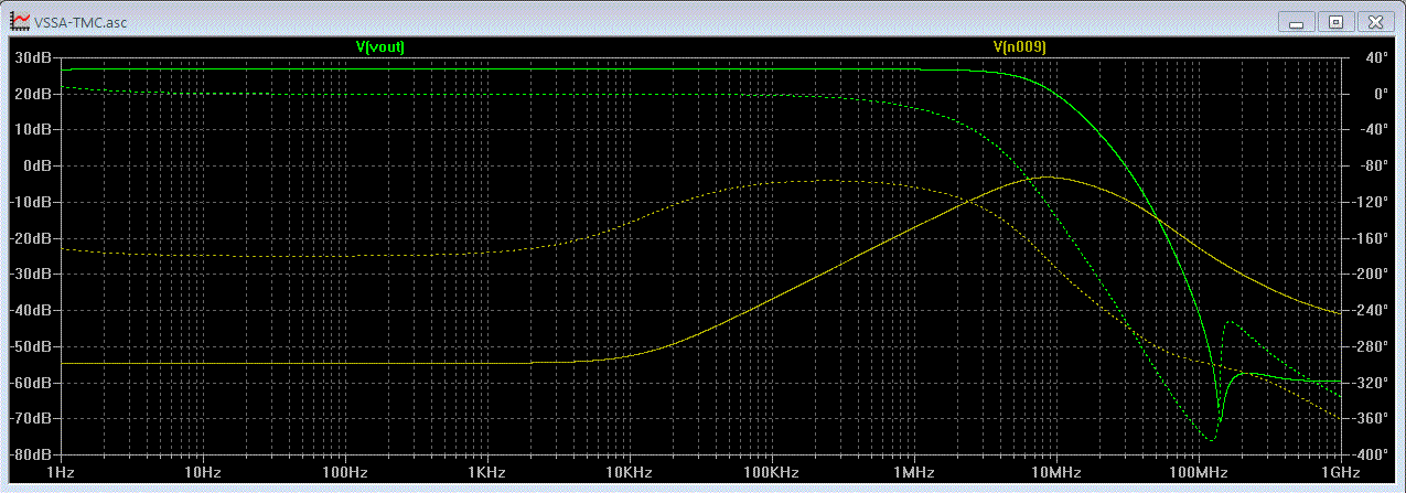

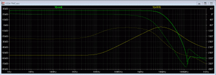

This is my first sim of VSSA, thanks to Dadod who provided the file and models to me.
Green trace is bandwidth
Dotted green: phase (-250° at 0db, 110° margin ! Rock stable)
Golden trace is open loop bandwidth (inverted due to my personal method): Cutoff frequency: 14Khz !!
Feedback ratio at 14Kz: 23dB (-4db comparing to 100Hz).
I don't see any noticeable phase error at 20Hz, means no group delay error.
