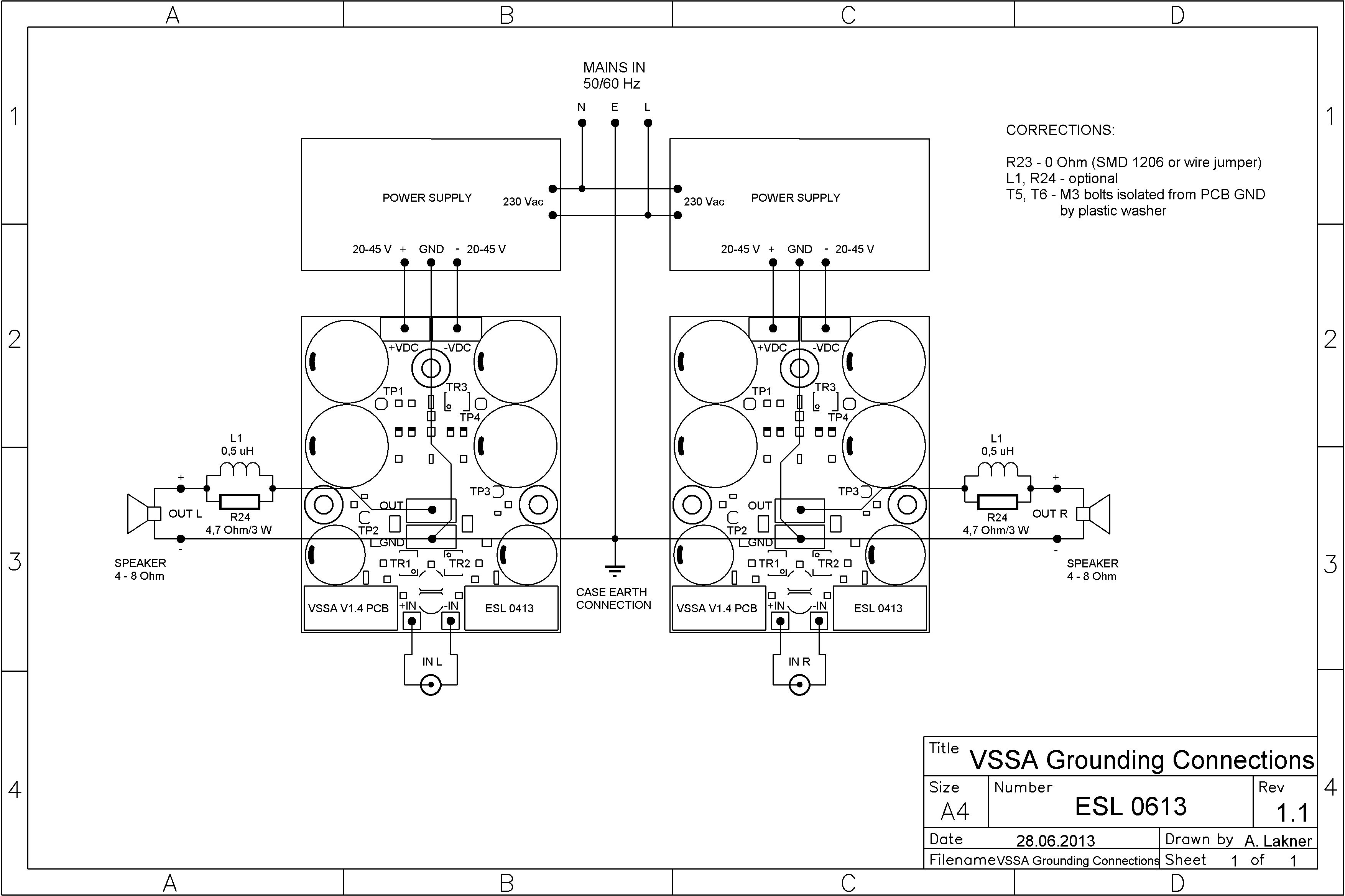

PCB needs corrections:
1 - Short R23
2 - If high inrush current from PSU read SMPS, replace R19, R20 with Farnell MPCWR10FTFQ100
3 - I attach VSSA grounding schematic as jpg-image from another post cant remember but attach here.
4 - In Step 2 of Calibration adjustments in Installation manual the correct text should be as follows: "Our final target for V-meter 1 reading is 4,00 V and 0 mV for V-meter 2 reading. Turn on the power supply and observe both V-meters displayed values. Clockwise rotation of TR3 will increase V value of V-meter 1 and should have no effect on mV value of V-meter 2 readings. Rotate trimmer TR3 in a direction to reach our final target goal 4,00 V reading on V-meter 1 (meaning 4,00 V/22 Ohm = 182 mA output bias current + front end bias current)."
BR Ricky
