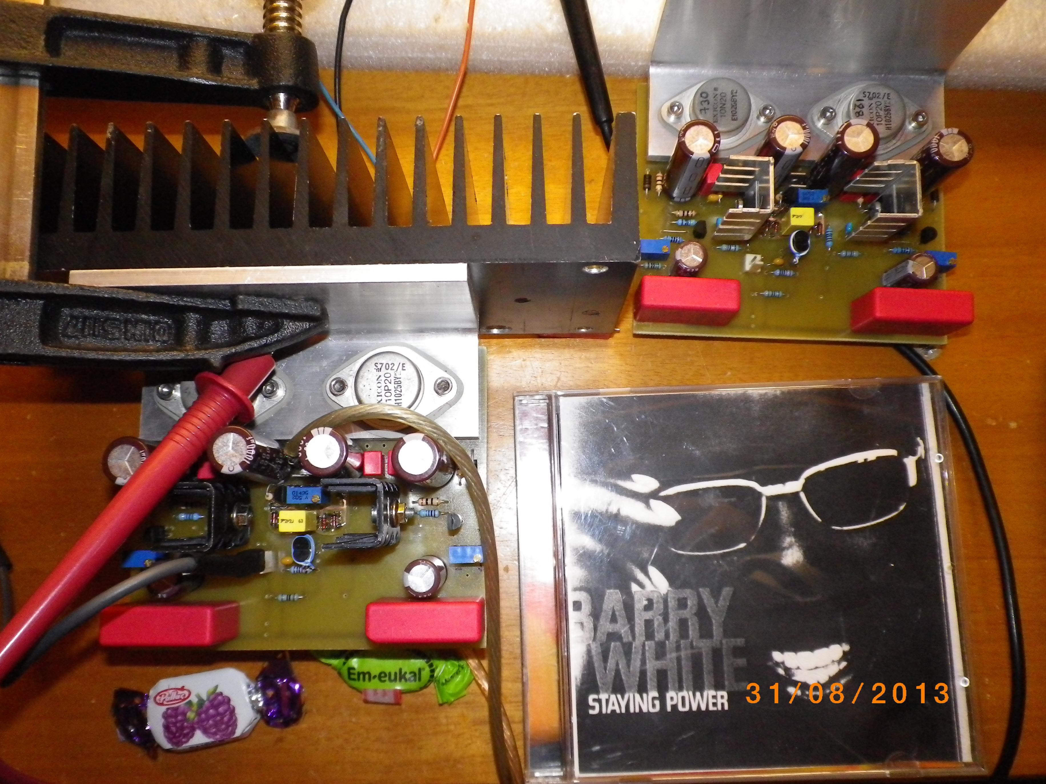

VSSA T03
My new version pcb
offset +- 3mv
2n5462 at 10 ma set to 2.4 ma
vas at 12.ma
exicon at 170 ma

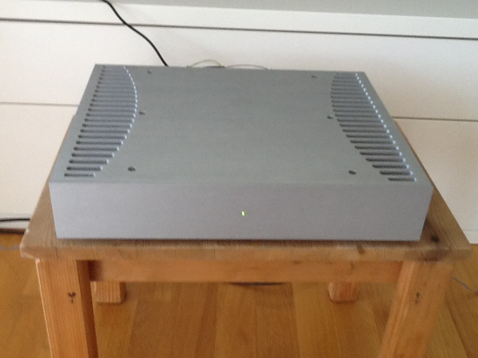

My finished VSSA
Hi guys!
I was able to finish my vssa amp last week and let it run for a full week.
I was able to hear previously finished product from LazyCat.
My amp at the moment differs to the from LazyCat mostly in choice of capacitors on vssa pcb. The power supply is identical.
We will do some sound comparisons in a few days and I will let you know.

hi nikosokeyMy new version pcb
offset +- 3mv
vas at 12.ma
exicon at 170 ma
Very nice amps you have there, did you end up with KSC/KSA VAS pole or is it BD devices.
Because you make so nice HD Pictures i am able to see you have a little copperwire around the input pole, no matter it is small signal, around those devices there must be audioband swinging electromagnetic field, so either use plastic/glue/or ground it.
It has just been discused in PeeCeeBee thread how it makes drifting the setup (see http://www.diyaudio.com/forums/solid-state/231662-peeceebee-112.html#post3616995).
Maybe also screw/nut/washer for VAS devices would benefit with nonmagnetic material brass/alu/stainless/(grounding) because of electromagnetic field.

VSSA T03
Hi Ricky
Thanks for your kind words
Honestly I did not give much importance to the little copperwire around the input pole.
Next move i use glu for them .
I use bd 140 and bd 139 mached and on R =47Ω Ι measure 107mv
and 107mv to other res =2,27 ma to set 12ma the VAS
Square Wave at 100khz are perfect .
The amplifier with this the PCB has no hum noise at all .
When opening the amplifier with speakers 4Ω above the offset steering momentarily at 50mV and sits to 5mv no <<dooop>> at all.
i dont use KSC/KSA VAS pole because i dont have ksc3503 E ,ksc3503 D make peaks on square wave bigger offset <dooop> on power up BECAUSE have big diferent hfe .
Fantastic bass .treble . etc ..

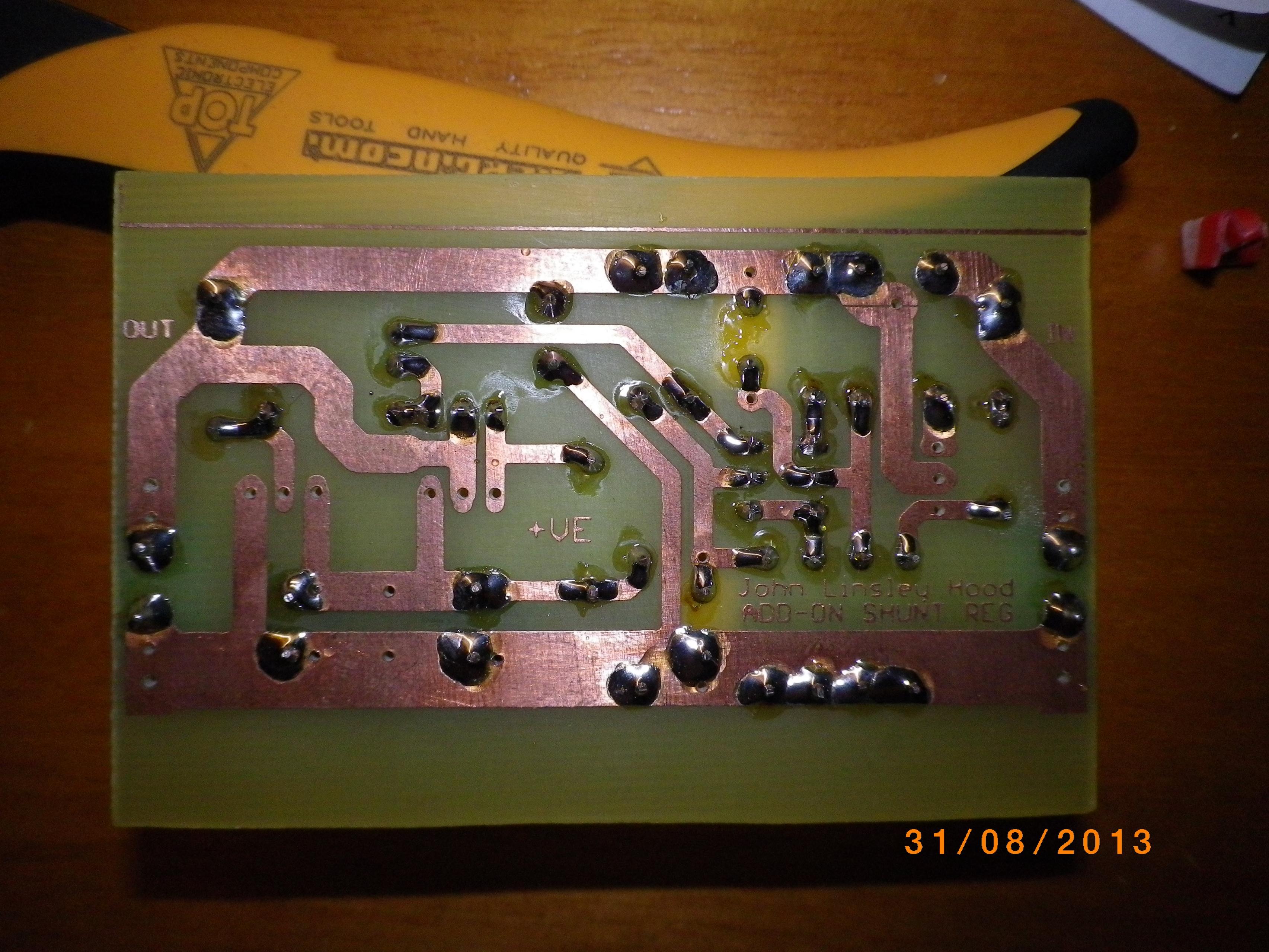

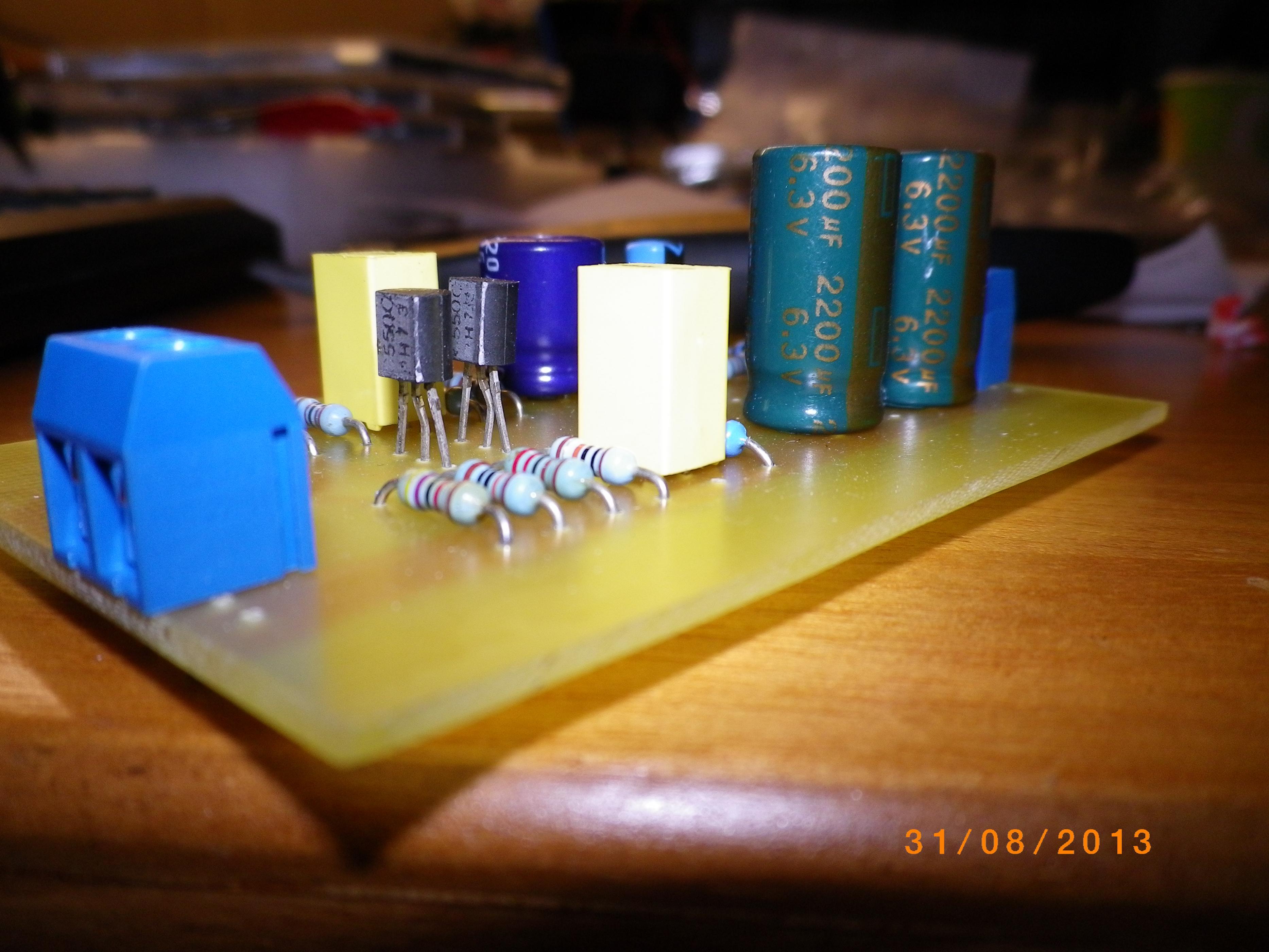

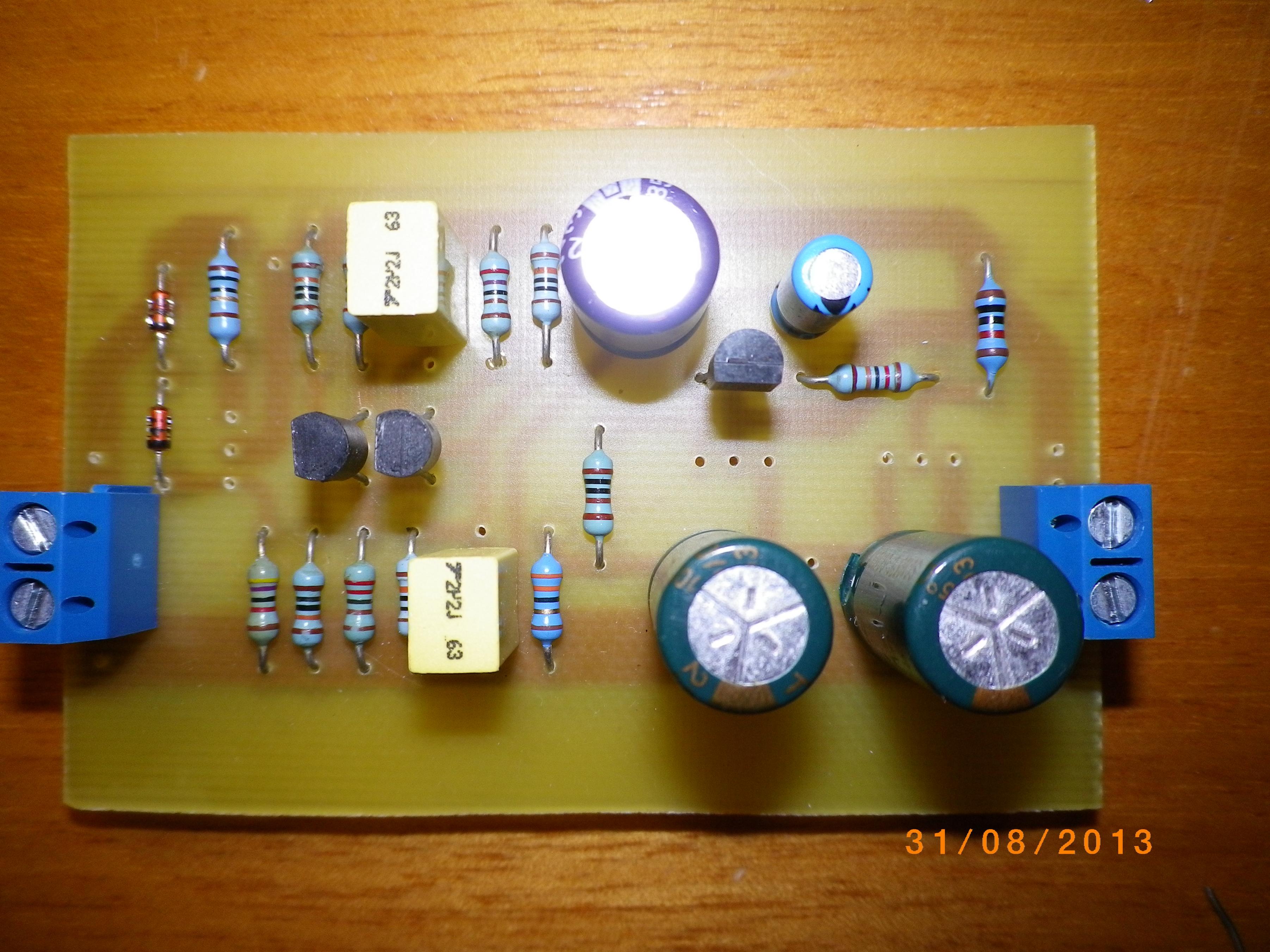

My new shunt reg for my B1 Buffer
Some sheet for CCS JFET P channel 2n6462 and trimmer to set 2.4 ma both sides + -

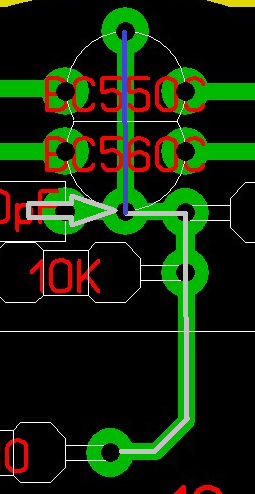

Hope i not too irritating, but if you gonna put time in input pole i have little tuneup to do at same time.
I attach Picture where you see input pulse (grey) going down trace hits BC560 before BC550 (blue) in teory one fires before the other out to symetri. Try making so that signal hits basis legs at both devices at same time so they fire synchronous to symetri.
Regards Ricky
