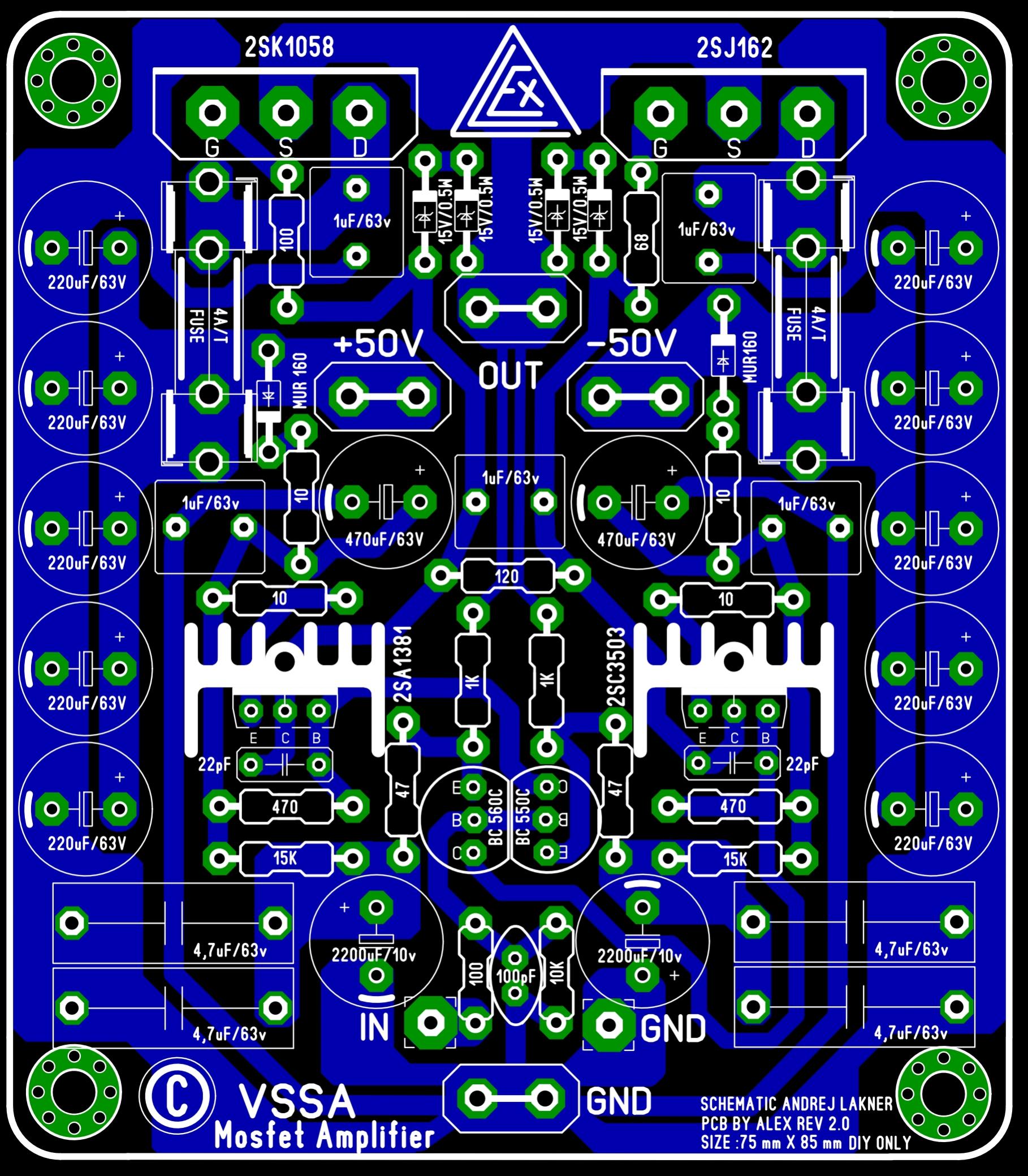

How much current flows in the VAS transistors??
Yesterday I tested only outputs with resistor divider providing Vgg and current was stable at 440 mA, so outputs with fixed Vgg (voltage drop on resistor) have stable bias completely.
VAS current set to 15 mA, very stable (14,5-15,5 mA) before employing bias to outputs.
When both running on the same heatsink, PTC is obvious, so output bias is going up because 2SA/SC gain is rising with temperature.
I will check with reference zener (1-100 mA shunt regulator) as bias spreader so the outputs will have constant Vgg, meaning constant bias, no matter of VAS current fluctuations. In that way cumulative process will be avoided, VAS bias will stop rising at certain temperature.
TLVH431BQ adjustable precision shunt regulator from 1,24 to 18V, 100uA to 70mA, -40 to +125°C temperature range, most suitable to replace bias trimmer for ALF mosfet. In this way Vgg and therefore output bias current will stay constant as once set, regardless of VAS bias current variation. In this case 2SA/SC could stay on the main heatsink to ensure smallest PCB possible. 😎

Yes this part fixes the bias problem, but still the bias of the VAS transistors Will be highly depending of the heatsink temperature.
I'll check the range of VAS bias. The good thing is it won't go below initial setting. 😀

Hi Gabor
I suggest you to use ALF mosfets, they have low Cgs and high transconductance. I couldn't find better ones for the job in this simple topology. Also they're stocked in Farnell or Newark (Element 14).
I'm sure you'll be pleased with the sound with these new parts incorporated. 😉

No, not in the VSSA thread. I promised it will stay fixed on six transistors with parts needed to assure stability and safety. The last V1.2 sch posted is pretty much final. You can assemble one if you like. 😉
