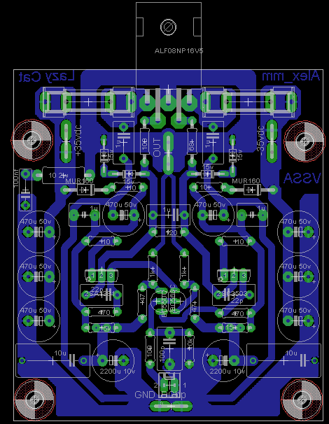

Thank you, Lazy Cat and Alex MM. Alex, may I have a pdf of the bottom copper side of the VSSA PCB using the ALF08NP16V5 ?
Credit to Alex_mm just add the zobel network and solderpad for trimmer during fine tune session. Board has exact same size as Alex ones.

Feedback Resistors
Will it be useful to make provision for parallel resistors (R5 or R6) for the feed back for finetuning? Should be more easy than 0.1% tolarence resistors.
Marc

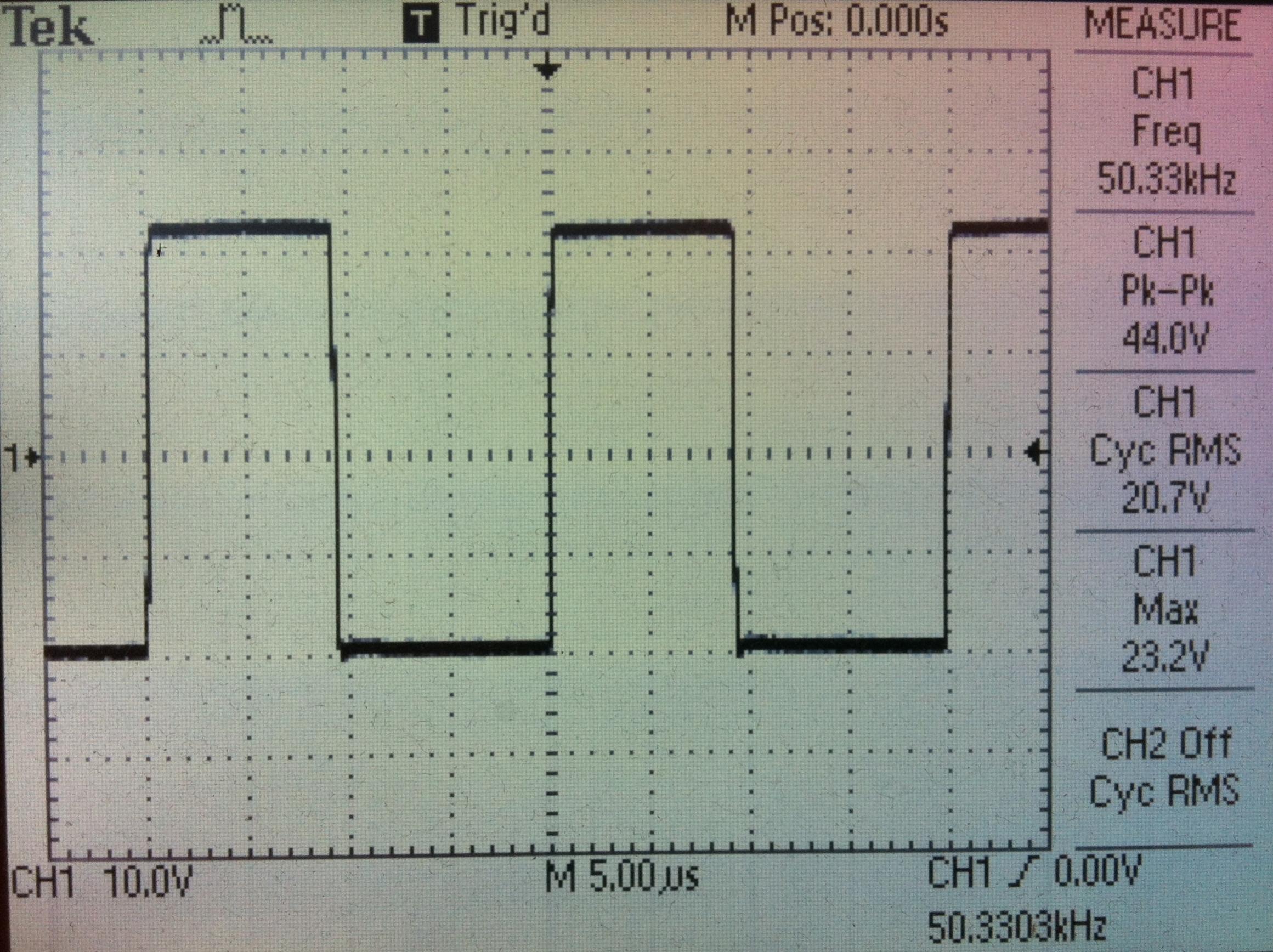

VSSA measurements, +/- 32 V rails
1.pic - 50 kHz square wave, 20,7 Vrms/8 ohm, 2,5 Arms
2.pic - the same as first only 0,22 uF parallel to 8 ohm load
Not bad for six transistors amplifier with no CCS.

P.S. Miller caps are 12 pF SMDs and VSSA is completely stable.![]()
Hi LC, are you using classical NPO smd brand for miller cap?
Marc
RF quality SMD capacitors. Copper heatsink is in electrical connection to sources of ALF, so a little portion of capacitance coming from here is in addition to Miller cap too.
I'll try to replace injection resistors with CCS to see possible improvement in the next test.
Regards L.C.

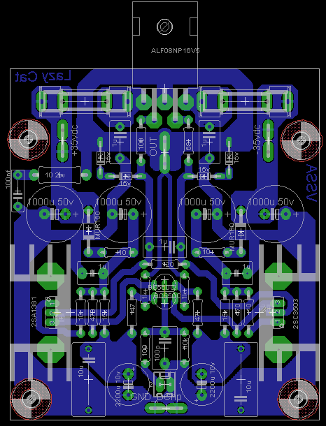

LC one more question : in his layout Alex swap the 1000uf 50v implicated in first stage power supply to 470uf 50V is that sufficient to your taste?
Marc
