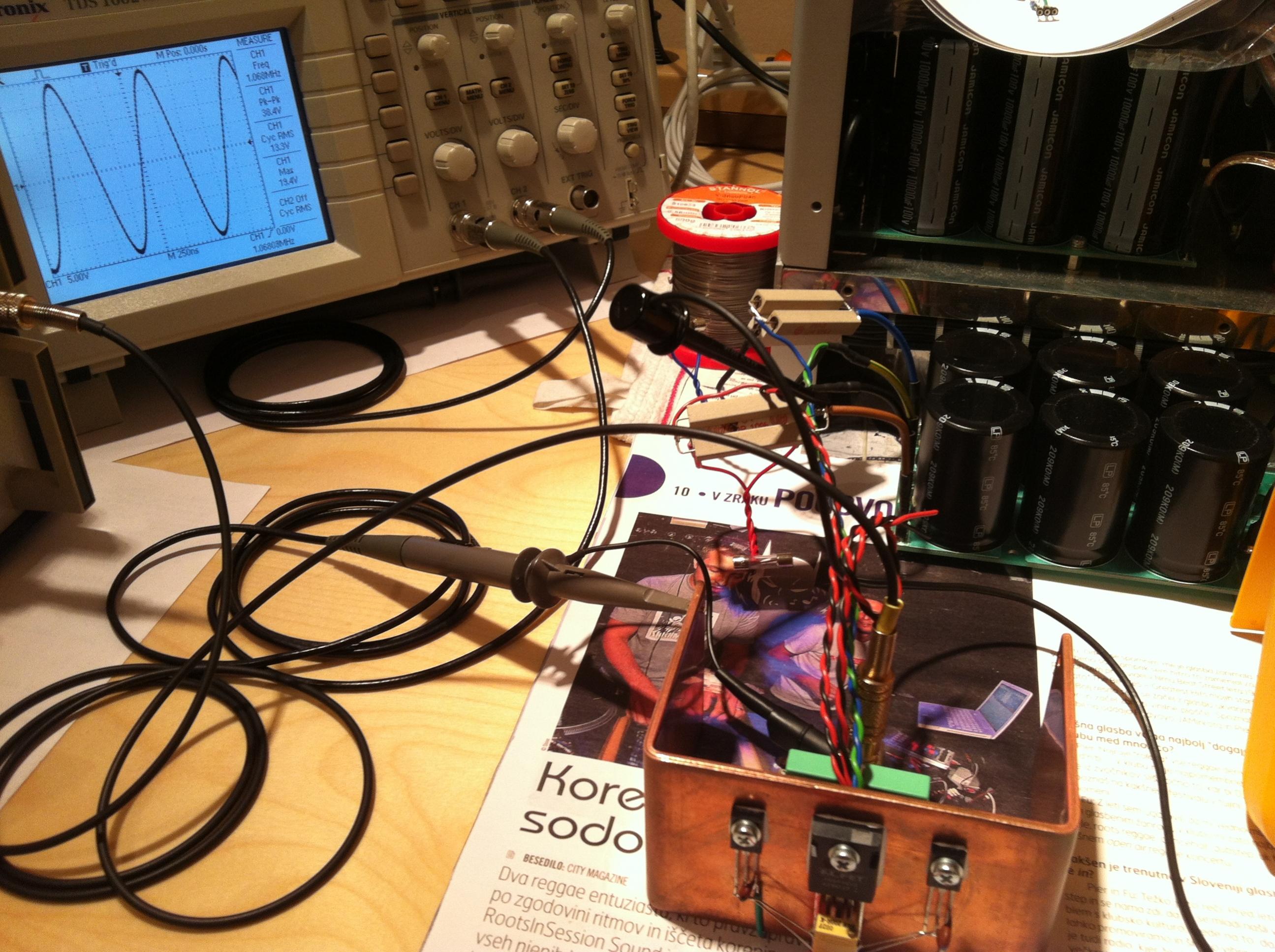

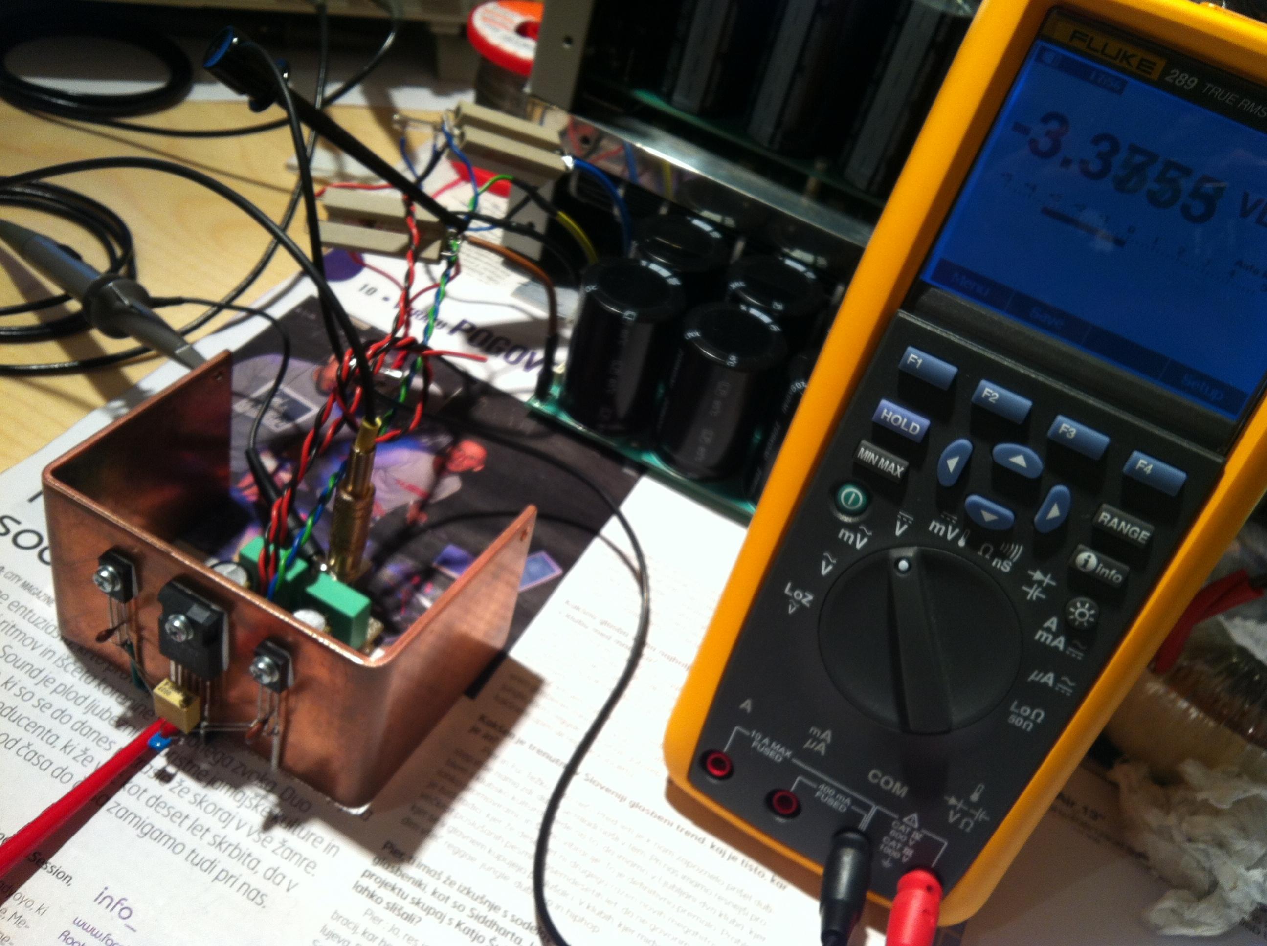

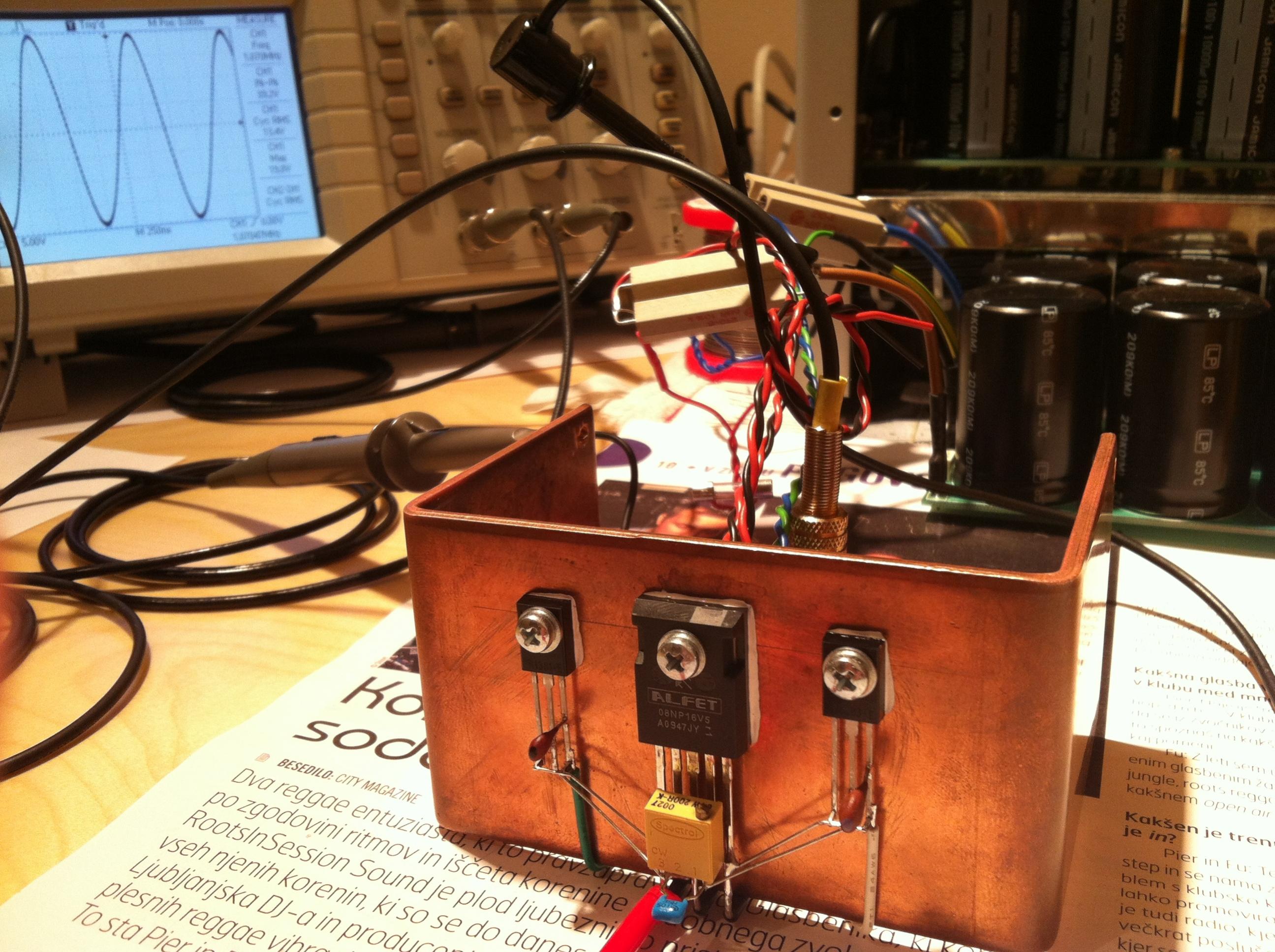

VSSA prototype is working, very well I could say. All DC and AC conditions stable, turn on without any swing, imediately zero DC on the output. Bias setting very linear, no jumps whatsoever. Without any compensation 10 Vpp 25 MHz oscillation, two 12 pF caps on VAS makes it completely stable. 😎
Pics showing 38,4 Vpp, 1 Mhz sinus signal, tested at max 3 Mhz, still no sign of smallest attenuation. 😀

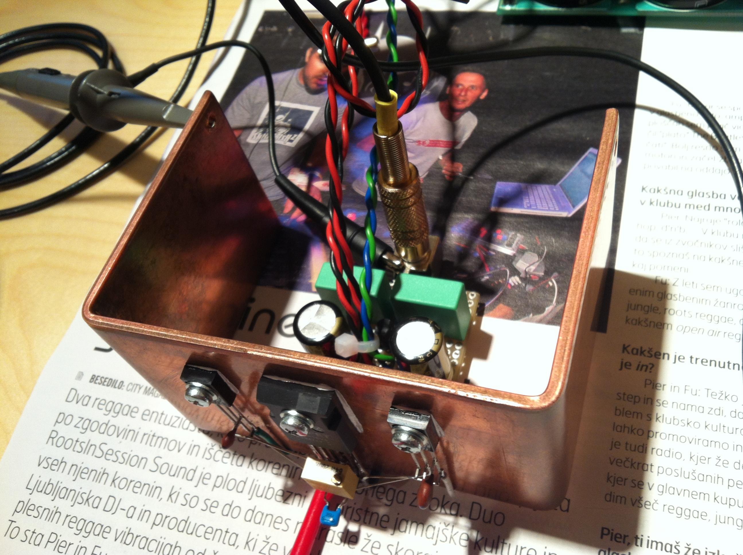

The only problem I noticed is thermal bias PTC because of VSA BJT's located on the same heatsink as the outputs. Solution is to use reference adjustable zener for bias spreader or relocation of 2SA/SC to separate heatsinks. My wish is of course to have them on the main heatsink because of PCB-module compactness. Any suggestions? 🙄

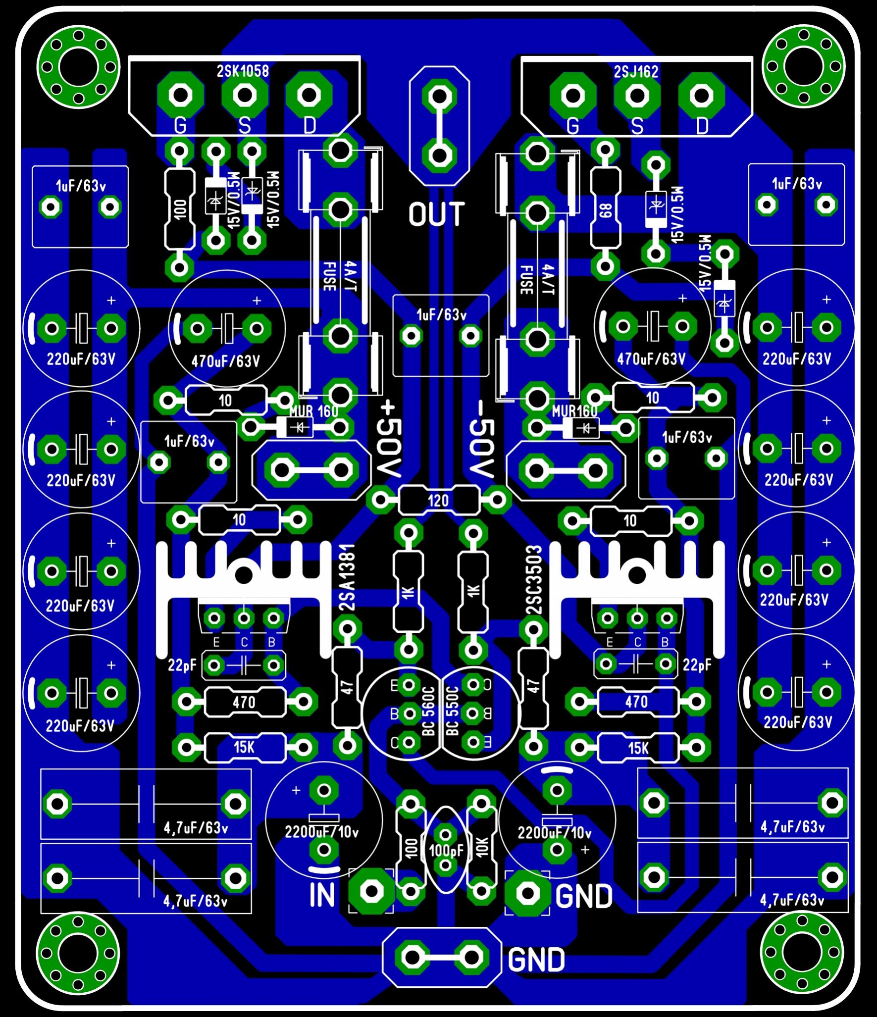

Hi Alex, nice to see you continue to draw layout. According LC schematic the left one 1uF near 2sk1058 should be after fuse and at right side the 4x220µ should be befor the fuse. Yet i don't know if this make a difference but shoundn't be the 1uf the more we can near Fet drain?
Marc

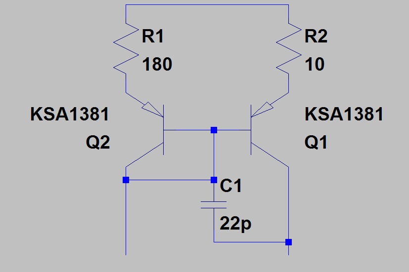

Q2 on heatsink. Q1 on top. But the gain is reduced 2.6 times
