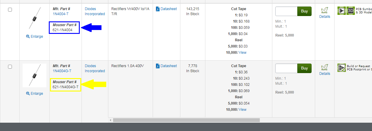

Question 1N400 Which one?
Hi!
I'm filling my basket, but have a little issue here:
D1 - D4 are supposed to be 1N4004, 1A silicon diode, Mouser# 621-1N4004
Mouser offers me either 1N4004-T or 1N4004G-T.
Do I go with the 1N4004G-T (the other being "not recommended for new design")?

Doesn’t matter.
Perfect, thank you, 6L6!
(I guessed it was something like this, but guessing isn’t the best bet [emoji848])

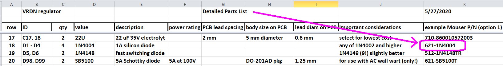

Look inside the blue rectangle and also look inside the yellow rectangle.
Choose the one whose part number is 621-1N4004.

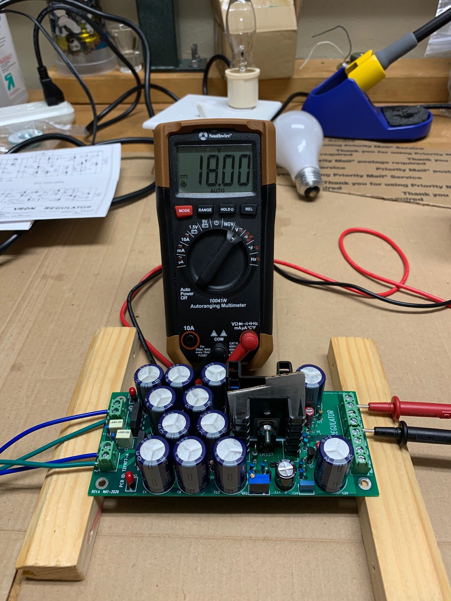

It rained all day in Shreveport, so no fence building. Took me about four hours to assemble the board. Checked the transformer then the transformer and power supply, using my handy dandy Dim Bulb Tester. Good test.
Mark thanks for all of the hard work to develop this Power Supply. Also thanks to RickRay for the board.
Someone somewhere said if there "ain't' pictures it didn't happen. Well here goes
Now if I can just get those "SMD" devices soldered to the BA2018.
Thanks everyone

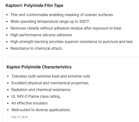

@A321Drvr -- Congratulations! And attaboy for the very nice pics. I recommend something a little more heatproof than cardboard, for a long term insert between the heatsinks. I use Kapton tape that I buy from Amazon and eBay, here's part of their sales blurb

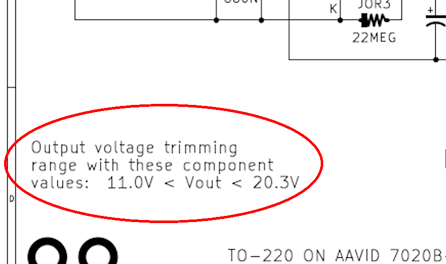

Please notice the voltages mentioned in the title of this thread:
and the VRDN schematic diagram (attached to post #1 of this thread) agrees. ±20V is as high as it will go, when your turn the trimmer potentiometers all the way clockwise.
I suppose that a highly motivated & enthusiastic reader might be able to modify the circuit design to give higher output voltages. However I think it is probably not an easy task; the very first job would be to read through Elvee's Forum thread about his De-Noiser circuit, and learn whether it works or fails at 24V output. (I don't know the answer, myself). Also to learn whether Elvee recommends any component value modifications in the frequency compensation sections of the De-Noiser, to preserve stability.
Another job the modification team would need to do, is re-calculate the necessary voltage, current, and power limitations when the output voltage is higher. Maybe the heatsinks called for in the Parts List are simply inadequate? Maybe the specially called-out 600 milliwatt resistors need upsizing? What about the large number of 2200uF filter capacitors? What about the Metal Oxide Varistors? And so forth.
It would be a not-insignificant amount of effort and there is a chance that the final answer might be: don't do this, it cannot work. But highly motivated & enthusiastic people are also highly optimistic, so I wish you happy designing and best wishes for complete success!
