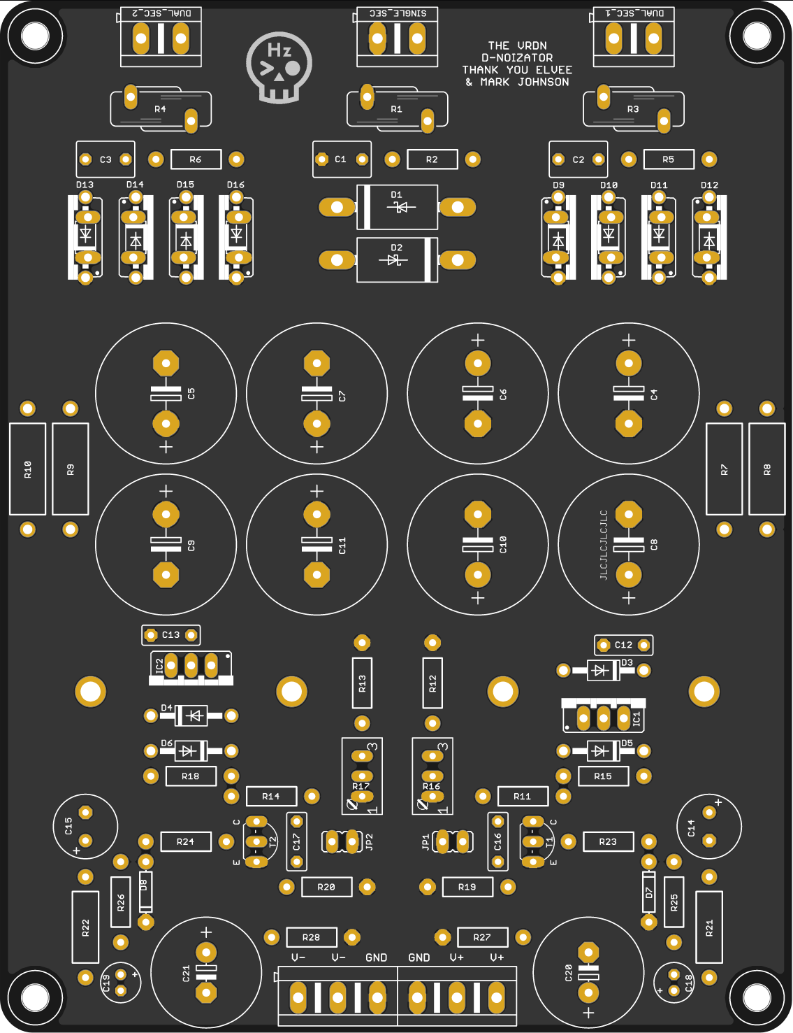

VRDN: bipolar regulator PCB for line level ckts: ±11V to ±20V @ 1.5A with "De-Noiser"
Boards for my layout are currently in production at JLCPCB. Once they're in hand I'll test them for stability etc. If all is well I'd be happy to post the gerbers here (with Mark's permission).
Mine are 2 layer instead of 4 layer (for cost reasons), size a bit bigger than Mark's at 10 x 13cm, and 2 fewer capacitors
[image]858553[/image]

Hi, I prefer that you open a new thread with an informative title perhaps such as "VRDN Clone on 2 Layer PCB" or something like that, so members will know instantly that it's just a little different. By all means please post the Gerbers and I'm happy they will be freely available. Just not in this thread, lest confusion arise.
Thank you and congratulations!
Mark

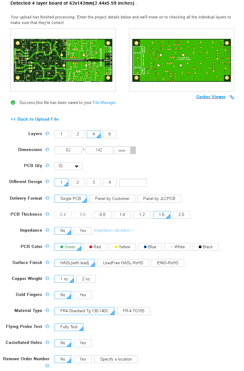

Would anybody be interested in some of these pcb‘s?
I‘ll place an order over @ jlcpcb, with blue coating even though it costs a bit (60something for 5, 60something + a few more for ten... costs to be fairly shared)
