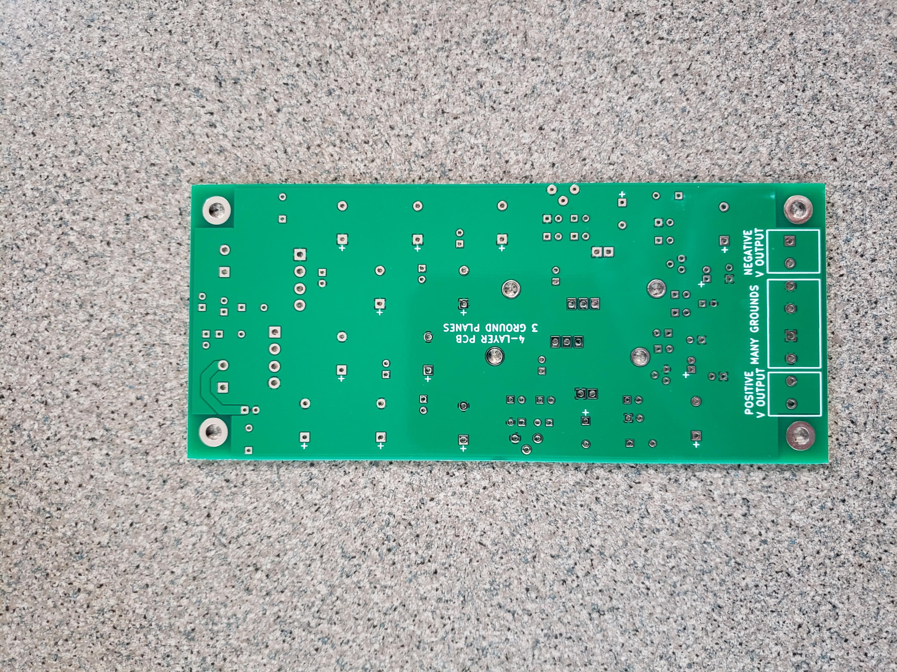

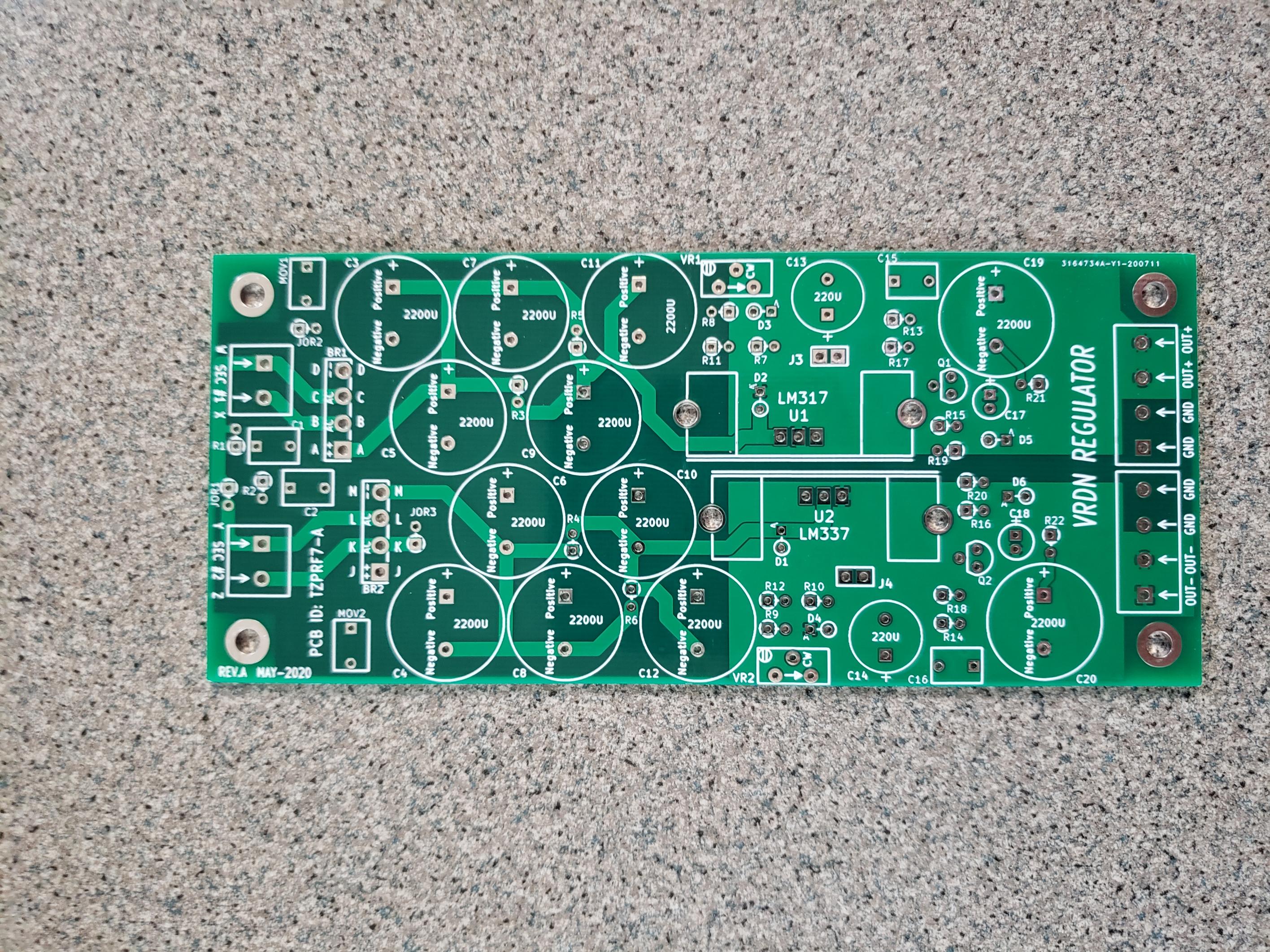

VRDN pcb
Finger on "Enter Key" as soon as you let us know
Thanks Folks
When I receive the boards, I'll let everyone know on here and will provide instructions for buying boards.
Thanks Folks

VRDN Power Supply
Thanks Jim always the man ready to help.
Ordered a VRDN board from RickRay,"Mousered" some parts today for the said power supply, now just waiting for the BA 2018 pcbs to return to DIY store.
Going to use this in front of my DIY F5
Received my boards from RickRay a few days ago. Beautiful! Also, RickRay was a pleasure to work with - very easy transaction and speedy! Thanks so much for helping our DIY community, and also special thanks to Mark for the extensive work to bring this circuit to life. More opportunities for big fun. 🙂
