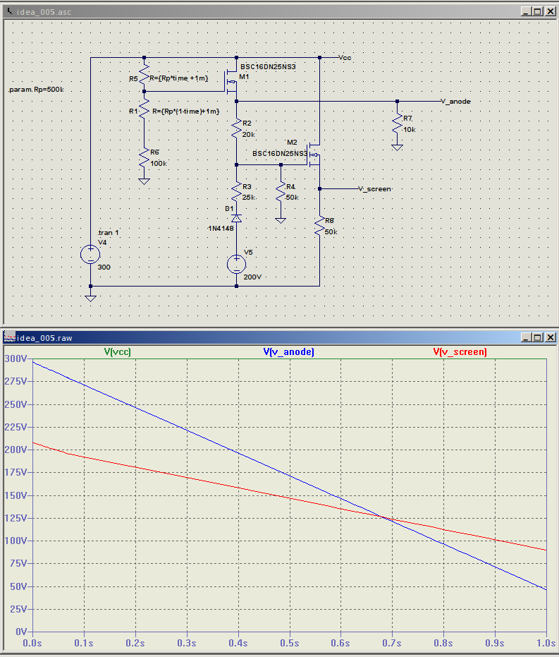

Here's an idea I had last night. Two MOSFETs, one to scale anode voltage (V_anode in the image), the other to scale screen voltage (V_screen).
Having the two voltages scale proportionally so that the screen voltage is always lower than the anode voltage is easy as pie. But I have some reason to believe that, in order to keep the load-line in the proper place wrt the "knee" of the curves, V_screen should start out below V_anode, but as V_anode is progressively lowered, V_screen should eventually become larger than V_anode.
Making that happen took some thought, but here it is. R3, D1, V5 are the key elements to making the two lines cross each other. When the voltage at the junction of R2 and R4 drops below V5, diode D1 starts to conduct, and R3 starts to flow current which changes the rate at which the screen voltage falls.
V5 would be a Zener diode or adjustable voltage reference in a real implementation of the circuit. In LTSpice, using a voltage source is much simpler.
this looks like a worthwhile direction to explore
Maybe the sound will depend on other supply details - i.e. the 'output impedance' of the supply that you normally have in amps that you like the sound of verses the output impedance of the MOSFET - may need some series resistance / RC filter after the MSOFET to provide the right dynamic behaviour.

Back to pentode screen compression, I got home too late and too tired to take apart my little preamp last night. I'll try to get the component values for Bigun (and anyone else interested) tonight. B+ was around 140 volts DC, and I think the screen resistor was 270k or 330k, but I've completely forgotten the value of screen bypass cap, which is the other crucial part of the compressor time-constants.
The relatively low B+ for the pentode was a design choice; it was part of my strategy for keeping the voltage gain from the small-signal pentode relatively low, about the same as you'd get from a typical half-12AX7 triode gain stage.

I just took my 6JW8 preamp apart far enough to read most of the component values....do you know what were the details of the power supply and value of that screen resistor?
The 6JW8 is a triode and a pentode in the same nine-pin bottle, and this is the pentode section we're talking about.
B+ is 130V - 140V.
The screen resistor is 270k.
The screen bypass cap, from screen grid to ground, is 10nF, or what is usually called 0.01uF in North America, because of an inexplicable prejudice against the SI prefix "nano".
The anode resistor (load) is 47k.
The cathode resistor is 1.5k.
The cathode bypass cap is a 10uF electrolytic.
This pentode stage is part of the clean channel. The guitar signal first goes to the triode from the same 6JW8, then through a gain control, to the pentode.
The component values listed above work well for clean and mildly overdriven tones. But overdrive it too heavily, and it makes unpleasant blubbering sounds (blocking distortion.) That's why there is a separate drive channel.
As you turn up the gain control from zero, the pentode gradually starts to introduce some compression, and, as mentioned previously, at some settings, it's very clearly audible.
There's nothing special about the power supply itself, other than the rather low voltage. As mentioned previously, that is deliberate, as it helps to keep the voltage gain from the pentode under control. The rather low value of the pentode's anode load resistor is part of the same strategy.
