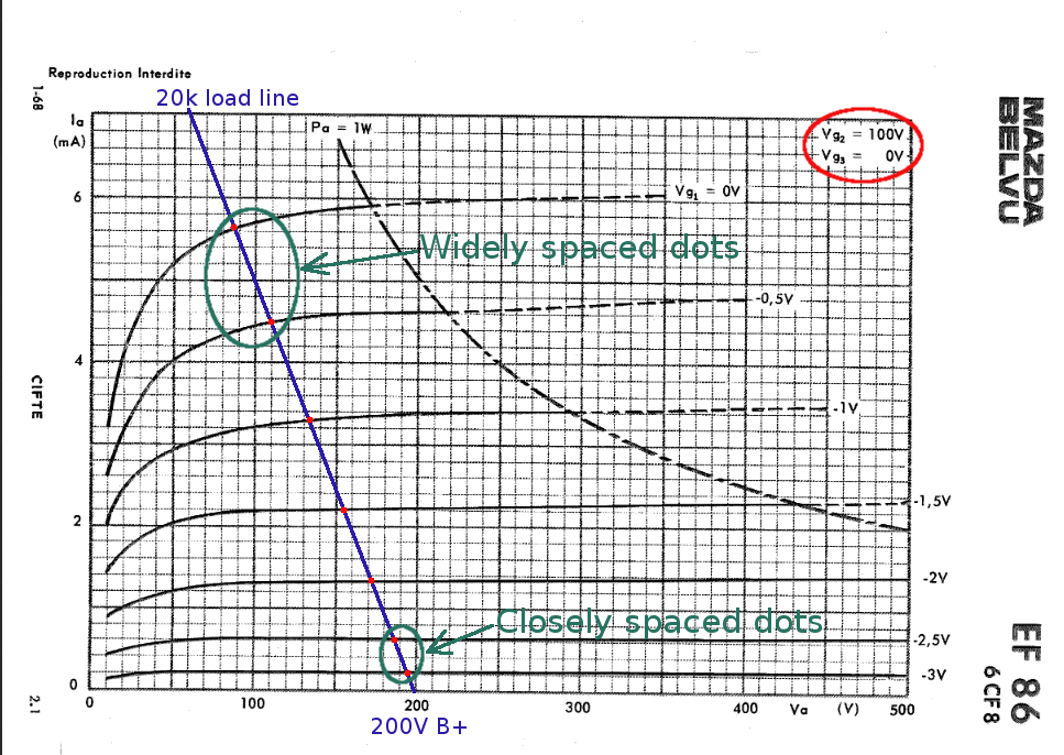

I'll try and show you why there is, in fact, a need to scale the anode voltage. To do this, I created the three attached images. Take a look at these, and I will walk you through how they clearly show the problem with NOT scaling the anode voltage.I see no need to scale the anode voltage.
I couldn't quickly find a big pentode datasheet showing curves for multiple screen grid voltages, so I just used an EF86 data sheet (this one: https://frank.pocnet.net/sheets/020/e/EF86.pdf ). Exactly the same thing happens with bigger pentodes as well, so the conclusions we draw from the EF86 data apply equally well to bigger pentodes like EL84s and EL34s and so on.

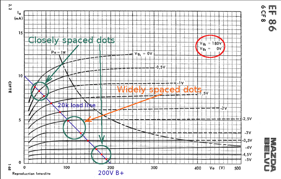

The first image shows a load-line for 200 volts anode voltage, and a 20k anode load. The screen grid voltage is 180 volts (circled in red.)
The second image shows the SAME 20k load-line, with the SAME 200 volts anode voltage. However, screen voltage has been lowered to 100 volts, pushing all the curves down, as you said.
The third image is the same as the second image, except I have compressed the vertical scale to match the first image. This lets you see that the curves have been squashed down, but the 20k load-line is the same as it was before. (This follows simply from Ohm's Law: notice that the load-line goes through the two points (Ia = 0, Va = 200V), and (Ia = 10 mA, Va = 100V) in EVERY one of the three images.
One, and only one, unique straight line can be drawn through the same two given points. Therefore this shows you that the load-line is exactly the same line in every case. It only appears different in the middle image because the manufacturers plotted the 100V curves using a different (expanded) vertical scale to account for the smaller anode currents.
So what's the problem with not scaling anode voltage along with screen voltage? The problem is that the anode curves got pushed down, but the load line did not - so the load line is now much higher above the knee of the curves (in the second and third images, with Vg2 = 100V), and this drastically changes the distortion characteristics.
To make it clear to you why the distortion characteristics change, I plotted the red dots you see on the images.
There is a dot at each point where the load-line crosses an anode curve, so the position of each dot tells you the anode current and voltage at that value of incoming signal voltage (the voltage on the control grid corresponding to that particular anode curve.) The crucial thing to understand is that, if the pattern of spacing between the red dots changes, so does the sound of the distortion produced by the amplifier.
As you can clearly see by comparing the images, the pattern of these red dots is very different for the first image (Vg2 = 180V), and the second and third images (Vg2 = 100V).
At a screen voltage of 180V and anode voltage of 200V, both ends of the output signal are compressed (red dots are closer together), while the middle of the waveform is expanded (red dots further apart.)
At a screen voltage of 100V with the same 200V anode voltage, the bottom end of the output waveform is compressed (red dots closer), but the top end is expanded (dots further apart.) The type of distortion is quite different, the distortion spectrum is different, and so these two cases will sound different to the human ear.
So we conclude that the amplifier will not sound the same, because we lowered only the screen voltage, and failed to lower the anode voltage by the proper amount at the same time. Lowering the screen grid voltage - without lowering the anode voltage to match - caused a drastic change in distortion characteristics.
We do not want this from a good voltage scaling system - we would like the distortion characteristics to stay the same, with only the output power being reduced. In other words, we want the load-line to move with the knee of the curves as the voltage is scaled down. And this is only possible if you scale both screen and anode voltages together, and by carefully calculated, but different, amounts.

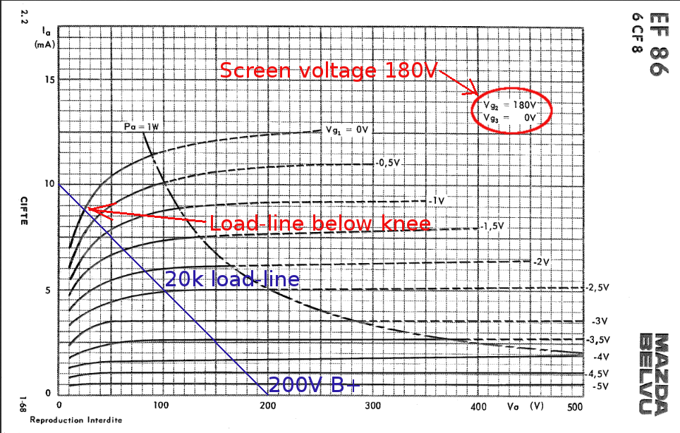

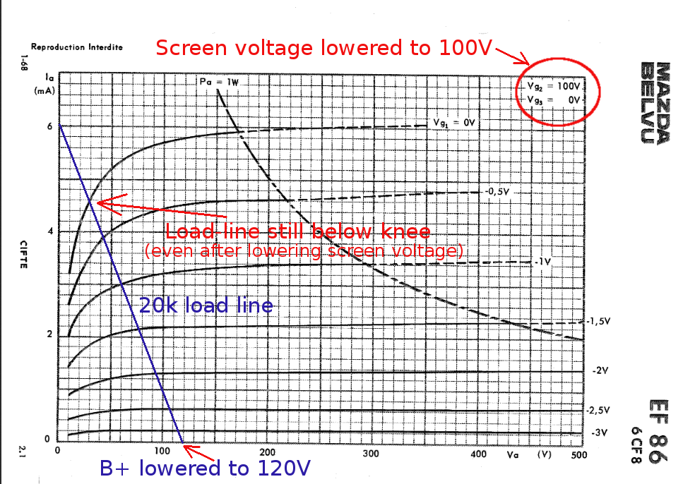

And here are two images showing why your really should run the anode current through a (second) MOSFET. 😀
For an EF86, by lowering anode voltage from 200V to 120V at the same time screen voltage is lowered from 180V to 100V, the load-line shifts in such a way that it stays in roughly the same place relative to the new "knee" of the curves.
Note that the slope of the load-line is the same in both cases (20k, or 1 mA for every 20 V). But by lowering B+, we slide the line to the left at the same time as we are lowering the screen voltage. If we slide it the correct amount to the left, the y-intercept will end up in the correct place, below the knee of the new, lower screen voltage curves.

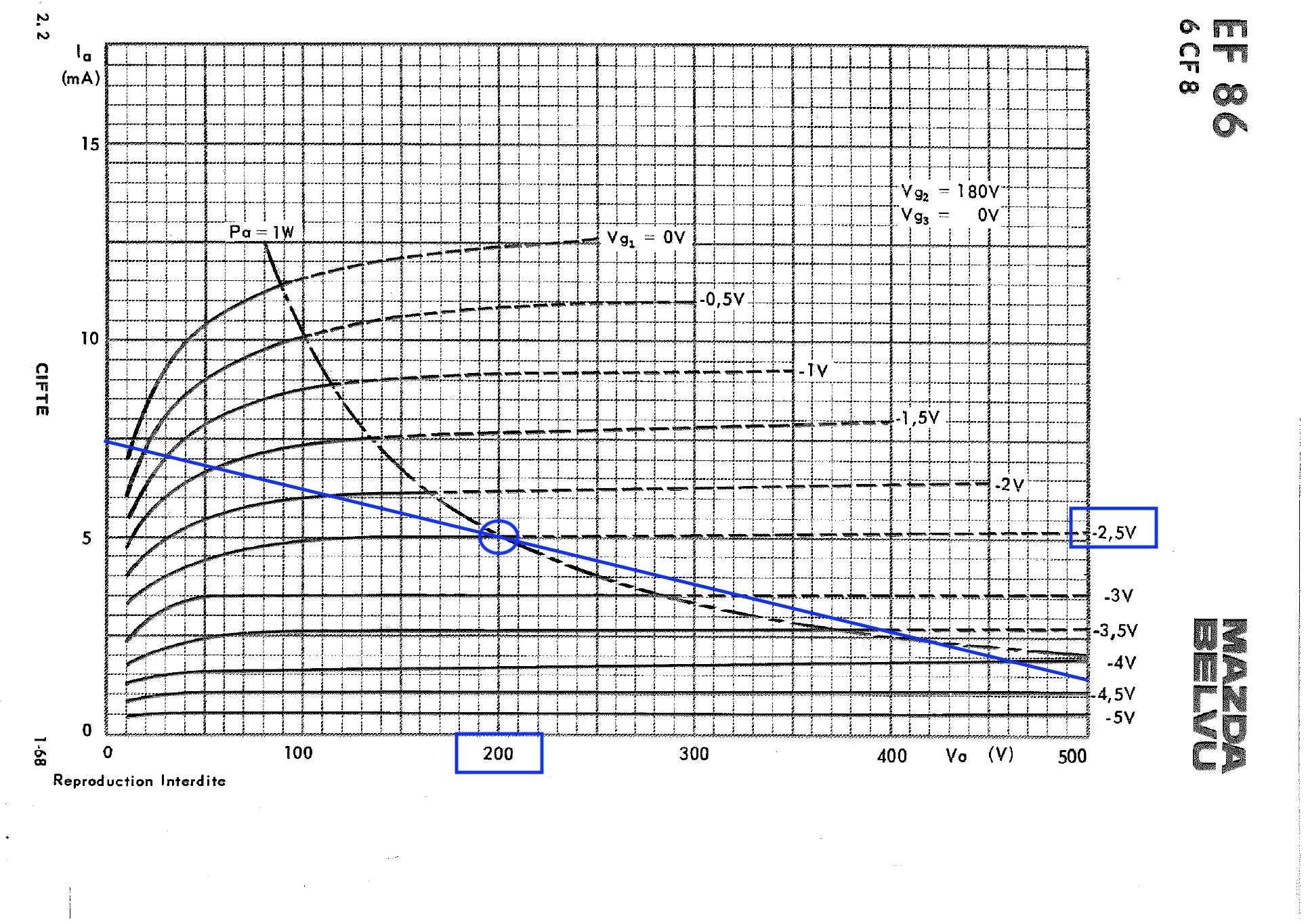

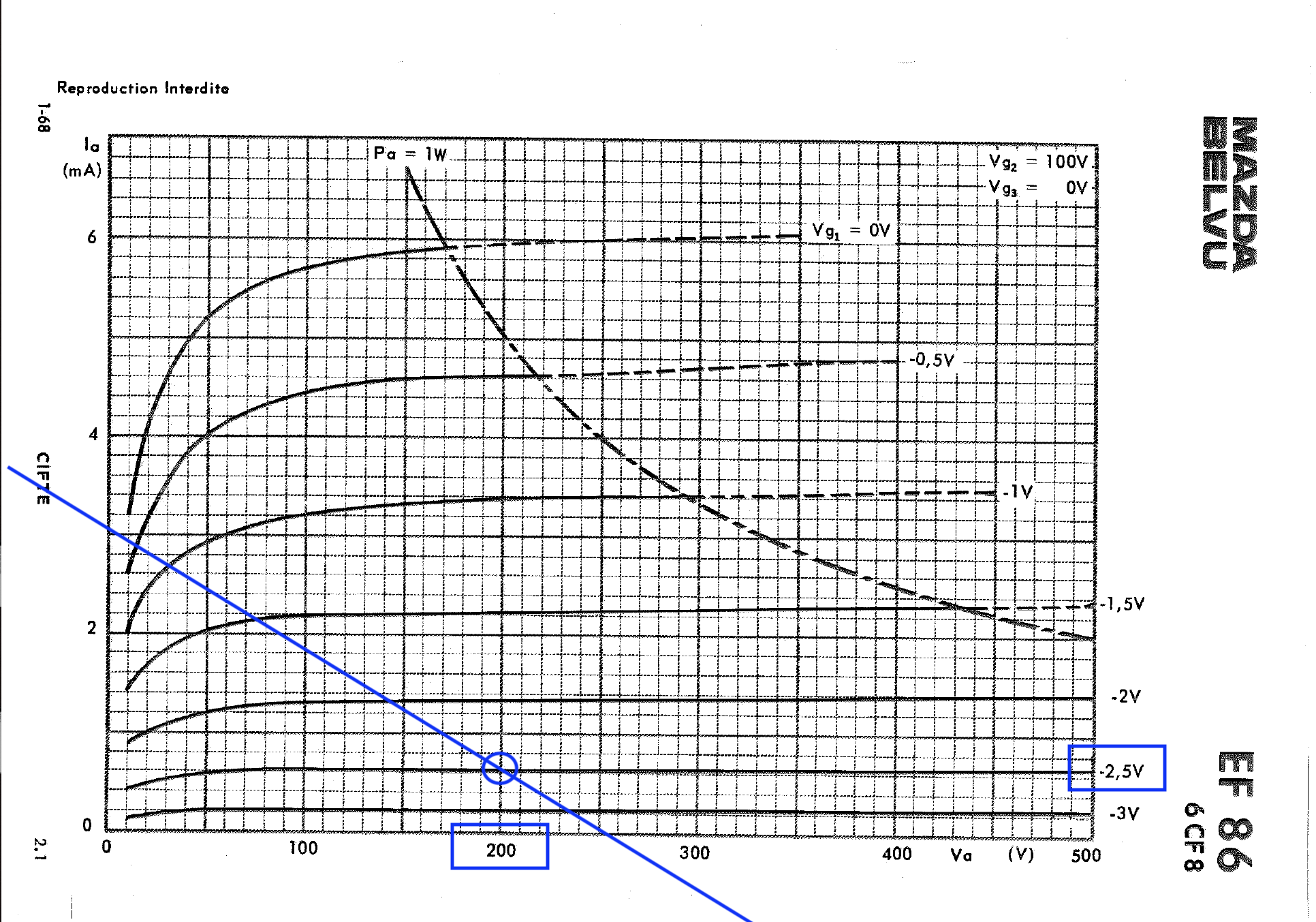

The simplest case, fixed bias. Let's fix the bias at -2.5V and the Anode voltage at 200V. I picked a load line of 500/6 = 83k for my convenience.
The loadline in both graphs has to pass through -2.5V and 200V. See how at reduced screen grid voltage the idle current drops. See how the load line kinda clips through the knee in a similar way in both cases.
In more detail. At g2=180V the idle current is 5mA. And we get into serious compression when the grid voltage swings 2V positive from idle to -0.5V at which point the anode current swings up to 7mA, a change of 2mA.
At g2=100V the idle current is now only 1.5mA and we get into serious compression when the grid swings 2V positive at which point the anode current swings up to nearly 3mA, a change of 1.5mA. This is a smaller change in current through the OPT than we see at the higher g2 voltage meaning the power output is lower but we still enjoy similar distortion.
