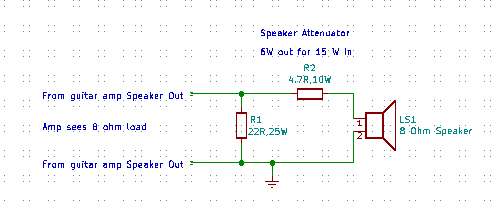

You have to change almost everything in the power amp, including the OT. In effect, you would be designing a new amp, or bolting something a lot like a Fender Champ output stage onto your VOX EF86 preamp. Even if you do this, there's no telling if you'll like the result, so it will be an experiment.

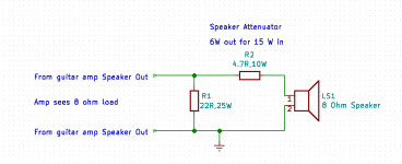

So I would suggest you consider making a simple speaker attenuator instead. You only need two power resistors to make a simple fixed attenuator. You can quite easily cut the power from nominally 15 W to nominally 6 W, and see if that quietens it down enough for you (it may very well not.)
The attached schematic shows you how simple this is. You need two power resistors, which only cost a few bucks.
Consider the power ratings shown in the schematic a minimum. You can use a 50 W resistor for R1 and a 25 W resistor for R2 if you want a little more safety margin (cooler-running resistors.)
Remember, 6W can be very loud...this attenuator will do what you asked for (turn a 15W amp into a 6 W amp), but, depending on how you plan to use the amp, it may still be louder than you want.
It's not hard to change the values of R1 and R2 to lower the output power to less than 6 watts, and I've already made a spreadsheet of values you could use if it turns out that 6W is too loud for you.
-Gnobuddy

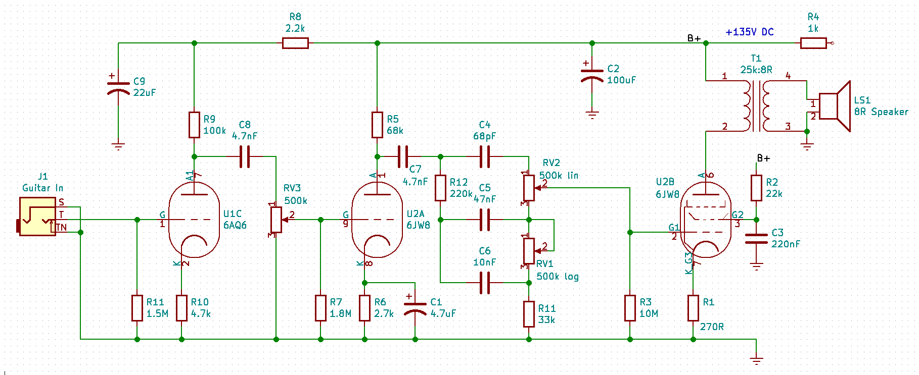

Along the lines of your proposal, a few years ago I built a small push-pull 2 watt amp using a pair of little 7-pin 6AK6 pentodes as the output valves. I paid $3 each for these. The 6AK6 was originally designed for audio output in radios, and has a 2.75-watt anode dissipation rating.
My more recent 200 mW single-ended experiment used a one-buck 6JW8, a 9-pin triode-pentode valve originally designed to be used in televisions. The pentode section is rated for only 1.2 watts maximum anode dissipation, the same as each of the two triodes in a 12AX7!
For my 6JW8 design, the OT primary needs to be about 20 - 25k, which I got from a little Hammond transformer, though a Fender reverb transformer would probably also work. There are only a few milliamps of DC anode current, and output power is miniscule, so my small PP output transformer seems to have no difficulty at all coping with SE usage.
The triode in the 6JW8 is used as the driver for the pentode, and I used a second one-buck valve (6AQ6) as the input gain stage. There is enough gain to insert a tweaked Fender two-knob tone control between 6AQ6 and 6JW8 triode, and go from clean tones to something in the classic rock era.

Certainly close power-wise. Here's the schematic of the final version I tested on the breadboard. I felt it still needed some tweaking to sound its best.
Incidentally, that's not grid-leak bias at the output stage; the control grid of the output pentode gets its ground reference through the tone control pots and R11. LTSpice simulation showed that this particular tone control circuit had very good performance, as long as the output was essentially unloaded - the usual 1 meg load was far too low, and ruined the tone control contours. I used the 10M resistor to offer some safety to the pentode stage if the treble tone control pot goes bad.
I used a bench supply to power the breadboarded prototype; had I gone beyond prototyping, the plan was to use a small 120V:120V mains isolation transformer or a small switching boost converter to generate B+, and power the heaters with a small SMPS wall-wart.
One of the things I never did was explore how it worked as a Herzog, though that had been part of the original intention.
