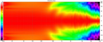

- the system measurement was made 0-90 hor at the tweeter axis (thus making bass/mid at y -160 mm)
I wouldn't publish this kind of measurements because vertical plane is not included and measurement distance does not equal to final listening and simulation distances which changes phase matching and woofer's relative magnitude.

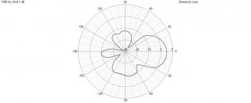

First is what I will call a "basic xo", minimal components, only on axis considered, looking for the big reverse null.

Overall reverse polarity,

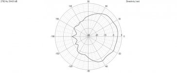

Horizontal polar response normalized,

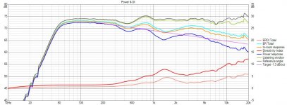

Power response,

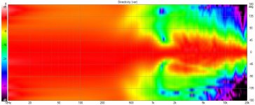

Vertical directivity,
Vertical polar response normalized,
Power response,

Please attach just schematic, six-pack image and single extra directivity chart for vertical plane to forum. Reverse null and polar chart at single frequency are not very valuable.

I was just considering reverse null in my 2,5 way project. Because in my example it is barely visible, because of the midwoofer break-up RLC trap (I need to turn it off to see the reverse null). Is this something to worry about?
Here is one version of Dave's project. Goal is to show just three design tips with single six-pack image. I'm not saying that it's perfect and only possibility.
On-axis response is hidden to emphasis that it could just disturb XO design. Green trace is listening window RMS.
1) Power response is flat horizontal at XO band from 1.1 to 3.5 kHz to avoid S-curve in power i.e. higher power above XO than at XO frequency. This is done by increasing axial power at XO band. Not much other choices in this case with phase match because both cone and wave guide are directive at XO, and box is less directive ~3 kHz. In-room response and total ER have tiny shallow dip ~1 dB so balancing compromise is done with on-axis and ER.
2) Listening window RMS should not be hot at HF. Usually small tilt down is more natural and less sibilant though possibly a bit dry/dull.

Top five responses have the same trend upwards from XO to 3.5 kHz. Result depends on what you listen, but any relative emphasis around 3 kHz is almost the worst case scenario. For example 80s' Iron Maidens having hump at ~3 kHz possibly due to monitors with BBC dip cannot tolerate any systematic mistakes.

I simulated different x-over typologies and finally got deep rev null and maintained all the other aspects quite similar to R7. Does this R8 simulation in your opinion look better then R7? I didn't measure nor heard it yet.
^Could you use six-pack export with aspect ratio of 20 dB/dec to make graphs more readable. Directivity chart with vertical polarmap. And no reverse null plots anymore because it's not quality benchmark.
