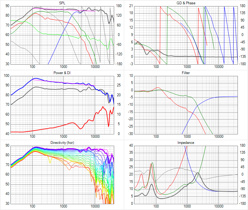

Hi kimmosto,
first I want to thank you very much for this really genius piece of software you wrote!
There is one issue which sometimes makes working with it harder: It is the auto scale function for the Y-axis (Level in dB) in the Power & DI graph. Sometimes it is scaling wrong so the curves go out of sight. Changing the Span sometimes helps, but not always and of course with lowered 'resolution'.
I would be very happy if there would be -for example- a possibility to turn of the auto scale function and only have some fixed numbers there.

I have seen your simulations with this issue on German forum. Some of your response files are corrupted for sure. Auto scaling works very good with valid data.
There must be random peak somewhere within 10Hz...22kHz. Peaking frequency can be revealed by maximizing program window to full screen and then zooming SPL chart with double click. Then use text editor to fix corrupted frequency point in response file. You can delete whole line because program interpolates missing bands.
Another option is smoothing all responses with Calculator tool (select Scale function and smoothing of 1/12 oct). Smoothing cannot fix extremely bad corruption.
I will not make scale locking or manual scaling if single...few users encounters problems due to corrupted files.

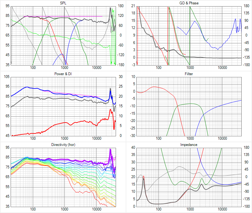

In Enclosure window a frequency is limited to 20 kHz. But in exported files max frequency is 39793.9 Hz
Thank you very much for your answer, kimmosto.
This helped me out, I used simulated data from ABEC and there was a peak above 20k >10dB higher than the rest.
Unfortunately this may also happen in "real life", for example with metal or ceramic cones and domes. And I, personally, don't like the idea to rework evident resonance peaks just to have a better view, because the software wants to tell me what I have to see and what not 😉

Correct, but you can still eliminate the issue by limiting displayed frequency range up to 20 kHz or even less if the peak is very close to 20k. What I cannot totally control is that .NET engine hides very fast/dense jumps in graphic lines. It's quite annoying feature - especially in Impulse response window. This is the reason why chart should be zoomed to reveal the problem.
"I will not change XY because of only one single or few people" - preventing very good stuff to become brilliant stuff..for ever 😀
My job is to verify that limiting of visible frequency range really works for this issue, and fix the program if needed. But I will not take steps back because auto scaling is usually stable, flexible within -150...+200 dB range and very easy to use. It can also eliminate scale jumping with some hysteresis while tuning crossover.
Manual span and max adjustment is implemented in some other places e.g. in Calculator. It is doable but would make main program less brilliant, imo 😀
This is done in rev. 1.1.18.2
