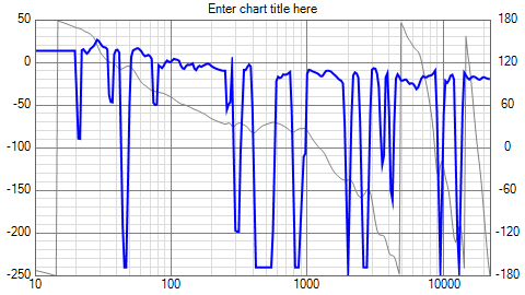

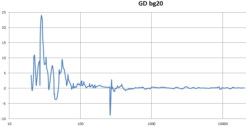

^Looks like a bug in Calculator tool. That function is not checked for a very long time... Main program works okay. You can use it until Calculator is fixed.
^^Sorry, it's not a bug. You should check Linear result mag. because Y-scale of GD result is linear milliseconds, not logarithmic dB.
^GD result needs usually some smoothing because relation of phase and amplitude changes is not very accurate with interpolated or averaged and stepping response data. For example 1/3 oct. smoothing looks quite okay. Also main program has some smoothing and exception handling for irregular values, especially at the lowest octave.

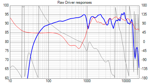

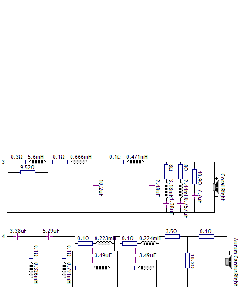

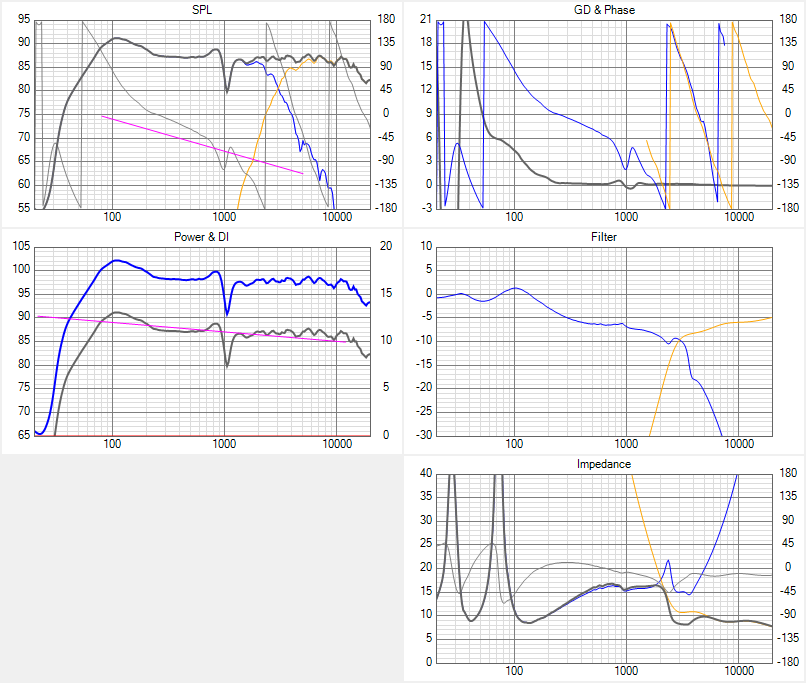

I've attached a couple of pics of the sims for the project I'm working on - a brand new crossover for a 2 way consisting of a Coral full range and an Aurum Cantus tweeter.
They have been kicking around in use for years with various crossovers and some digital EQ but I have never really put the effort into optimising the crossover properly as it was such a slow, tedious manual process for me without the right simulation software.
This time I wanted to include baffle step in the crossover, (I was previously taking the lazy way out doing it with digital EQ) use an all-pass to properly equalise the time delay of the two drivers which are not time aligned to achieve good phase tracking at the crossover, achieve a 24dB/oct Linkwitz/Riley accoustic response, and also deal with a couple of driver resonances.
I've literally only been working on the current design in VituixCAD for a couple of days not counting the time performing the measurements - it will be a complex crossover due to the quirks of the drivers and I could have kept it quite a bit simpler if I'd been less fussy, but I have to say I'm quite surprised at just how flat I was able to get the crossover region considering both drivers have a dip at 3Khz and the Coral's have a peak at 2Khz and 4Khz. It doesn't look nearly as pretty without the two notch filters... 😉
It's not finalised yet and I'm undecided if I'm going to attempt to do anything about the surround dip at 1Khz in the crossover - it's always been there and while it looks nasty you don't really hear it, and it would be a fairly large cap and coil in an already complex crossover...

1) I appreciate the "cookie cutter" circuit design that lets you combine blocks of common filter elements together, move them around, adjust them, toggle them in and out etc, but that can be a bit limiting in some ways, for example I can't find any way to add an RLC "notch" in parallel with my 5.6mH baffle step coil/resistor.
If I was to attempt to partially compensate the surround dip the only feasible way to do this would be to have a series tuned RLC bandpass which is then connected in parallel with the baffle step coil/resistor, but the circuit tools in this program do not allow such a configuration to be created, as far as I can see. I did simulate this manually in XSim which allows full free form circuit design to verify that it would work.

This should be found also in manual. Middle area is for zooming. Low and high frequencies are for setting ends of target slope.
I agree that span of group delay is sometimes too large, though zooming will show quite small changes in excess GD. I will add span to Options window. Span of other curves is adjustable.
Power&DI chart has overlay for all three curves. That is correct place to save intermediate result or any other reference for x/o tuning.
Very wide phase match (where level of acoustic signal drops below -40 dB) is quite or totally irrelevant. Phase matching is perfectly readable when timing of all drivers is adjusted equal, giving close to minimum phase with the tweeter. This is explained in Measurement preparations document.
See Measurement preparations document. No need to play with this at all if phase correction (e.g. PreDelay in ARTA) is applied while exporting frequency responses with measurement program.
Longer distance -> more delay should be quite logical. mm is visible just below microseconds.

Thanks - adjustable span for group delay and excess group delay would be excellent. Excess group delay in particular can be very small on the order of 0.1ms but is useful to identify acoustic centre offset between drivers and whether the crossover is correcting for this or not.I agree that span of group delay is sometimes too large, though zooming will show quite small changes in excess GD. I will add span to Options window. Span of other curves is adjustable.
