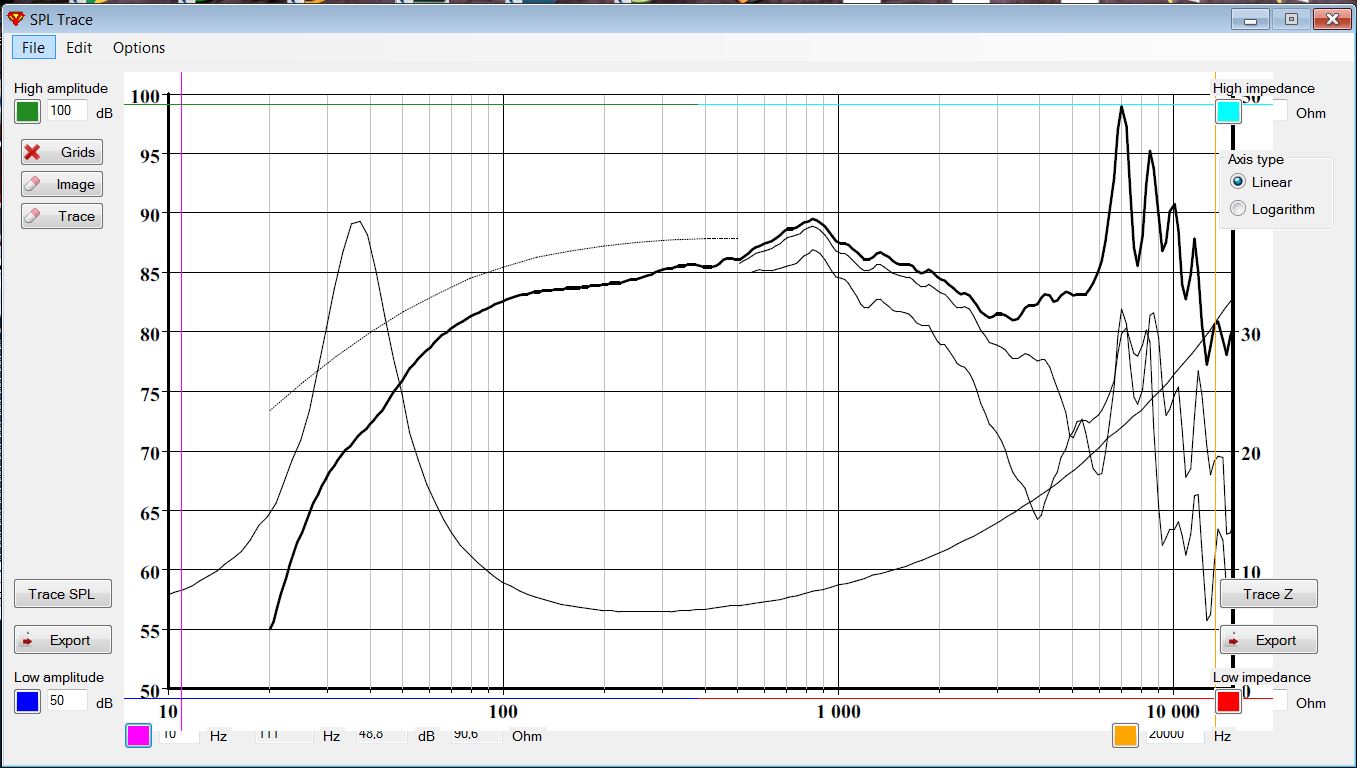

Hello,
I'm having trouble with the SPL Trace tool.
When I paste the image it's always bigger than normal.
I also can't enter a new value to the fields that define the boundaries.
Any idea why this is happening?
I'm using windows 7.
Best regards,
George
Best regards,
George
^Looks like some issue with window size detection. Try single display mode if you have dual display.
Windows 7 should be sp1, both 32-bit and 64-bit okay.

For the time being I sidestepped the problem of not being able to see what the actual boundary values are, by putting the cursor in the relative box, hitting backspace three times and entering the correct value of impedance, for the lower and higher boundaries.
That trick gave the correct value of impedance, even though I can't see the actual values entered.

Found the reason of the problem.
I had set the font size to medium (125%) so I could better read the characters on my monitor screen (I'm 53 years old).
Once I reverted to small font size (100%) everything is working perfectly again.

Very good! I was just beginning to write that you should test application scaling if that feature exists in your system. Scaling happens to work on Windows 10 with SPL Trace, but not tested on 7.
Generally, VituixCAD is neither designed nor tested for scaling >100%, and therefore errors could occur. Situation could be better in the future. I'm quite sure that can be improved by changing some parts in the program.

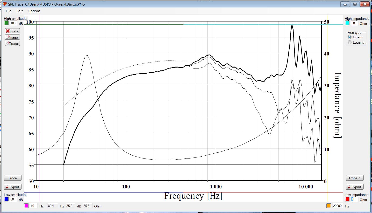

gagnou,
Could you test this revision, is SPL Trace working on Windows 7 with 125% scaling or not?
Auto scaling of all forms is switched off, but no difference to official release at least on Windows 10 (both work fine).
