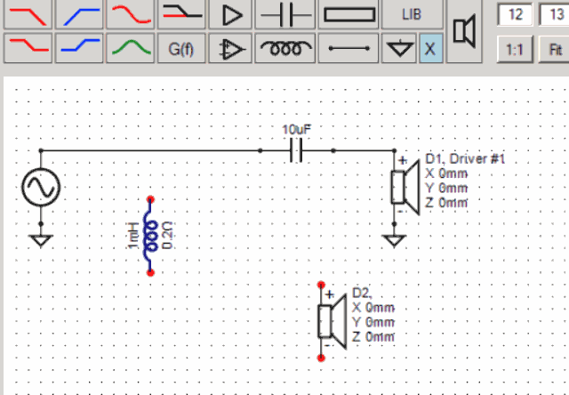

I guess the corner is actually a node, but doesn't show as such...
Component terminals, wire ends and wire corners are nodes. Wire corner can be located also in the middle of straight line if you have clicked that point while wiring, or wire is stretched from L-shape to straight by dragging some component in the end. Node is totally invisible if it's not yet junction to other wire.
edit2: the second attachment shows sometimes it does not take.
It takes that. Don't take any screenshots before wire is terminated.
I think I need to take a video. I clicked the wire and it made an anchor but as soon as I move the cursor it starts drawing another wire (this is not the normal behaviour). The second and third screen shot were taken one after the other as part of the same line drawing session ie after I took the screenshot with the wire extending to the right I moved the cursor to the left and then the wire turned green. I could also have gone back to the original termination point and clicked again and it would have created the dot 🙂

ok here is a demo that should make it clear what I am talking about 🙂
Ignore the turning green when going to the right. I had previously (before I got the screen to gif going) added a line there and then deleted it (so there was a node).
You don't terminate the wire after you selected the point at existing wire. Wire will continue if you don't terminate it with Space, Enter or right click, and that is normal and expected because it's designed so.
Wire termination is automatic only at existing nodes, indicated with green highlighted wire.
OK thanks that I didn't know because it always auto terminated when I was connecting things (as I was always connecting to existing nodes before) 🙂 So just a PEBKAC issue 😉 or a failure to RTFM 😀

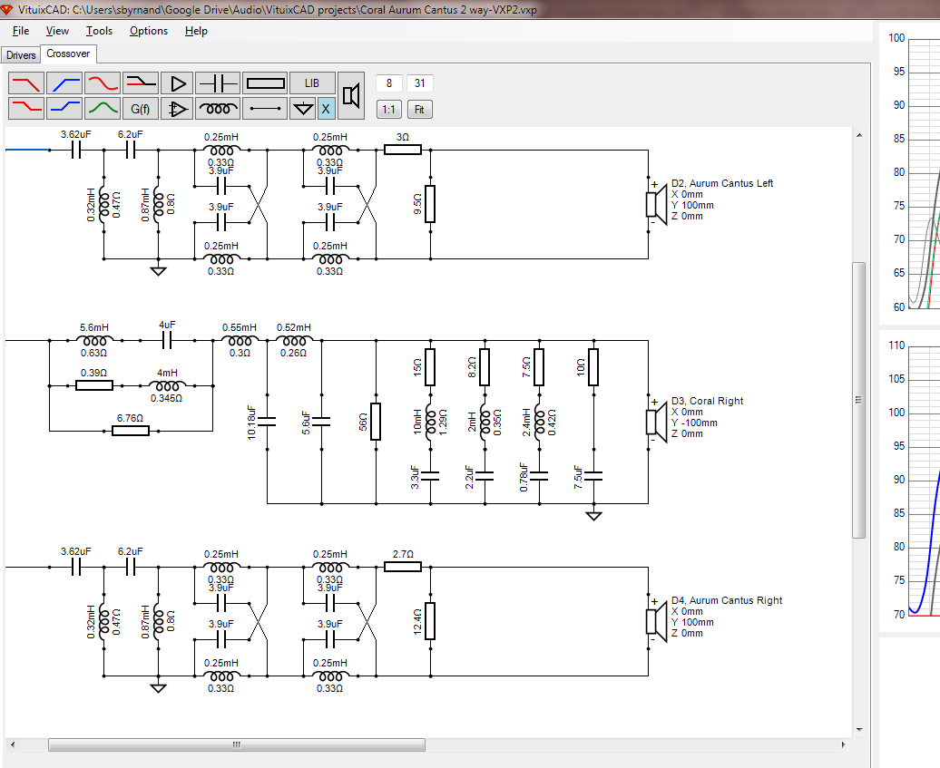

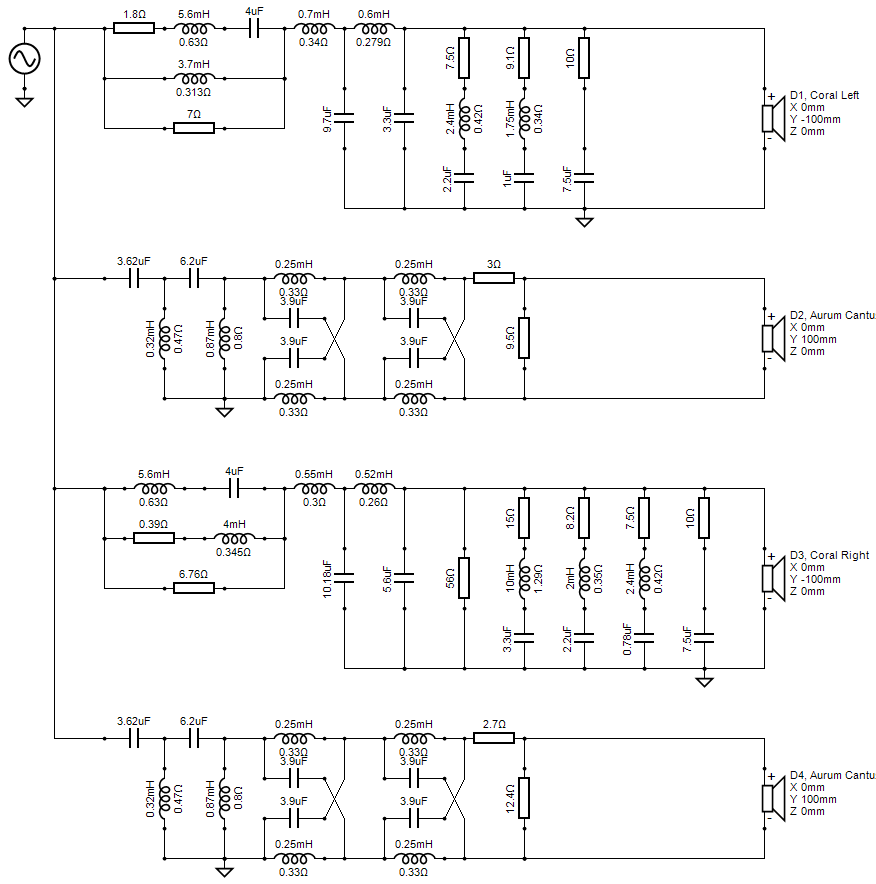

While I'm in bug hunt mode I've found that the export schematic option truncates the right hand edge of the text of components if they extend far past the object itself. (I assume a fixed border beside the components closest to the edge is used) Attached is a screenshot of the schematic as well as the exported schematic to show the issue where "Aurum Cantus Left" (and Right) is cut off in the export.
^Yes. That is known feature already discussed on some English forum - maybe here. Width of driver canvas is fixed (for ~13 letters) at the moment, but you can trick the program by adding e.g. short wire on the right. Then crop to smaller with some editor.
Text length detection is very easy to add, but I've skipped that so far.
