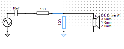

VituixCAD
^^.NET crash reports won't help much. I know what is missing in the code but identifying crashing control (B318TBaRGA?) is more difficult. Information where cursor/mouse was and what key was pressed etc. would be more helpful.
I have narrowed down what the cause is and created a small test case to reproduce it, with project file zipped.
It happens when you delete multiple items at once (with the "are you sure" dialogue)
In my example, multi-select the 10 ohm shunt resistor, the earth symbol below it and the wire link between the two resistors, as shown in the image, then hit delete and confirm the dialogue - it should crash.
Try it again without deleting the wire link and it does not crash.
I was able to reproduce many more combinations of multi-selection deletions crashing. (such as drawing a box around an entire connected all pass filter)
Hopefully that helps find it!

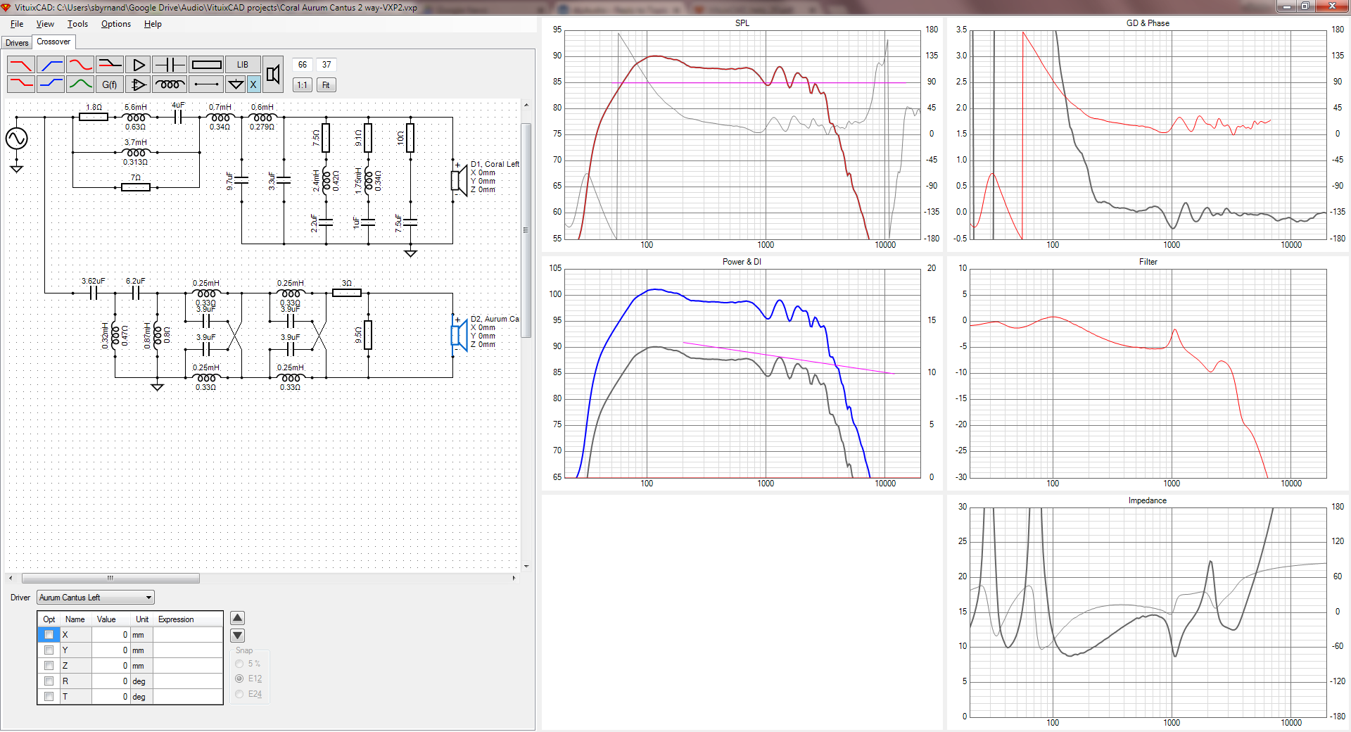

My next question is probably going to make me look stupid, but I can only seem to get Driver 1 to display on the graphs... Driver 2 acts as if muted.
If I mute Driver 1 the SPL, GD & Phase, Power & DI graphs all go blank, the impedance graph stays the same, (makes sense, because the driver is still connected) the filter response still shows the response for driver 1. (Doesn't make as much sense - how would I display the filter response for driver 2 ?)
The documentation says I should have a black curve for total SPL and individual coloured traces for each driver, but I do not have this, I only have a single brown curve for driver 1.
Have I missed something ? All drivers have frd and zma files imported and driver 2 has the correct driver file group selected. I have tried deleting and re-adding the driver. If I select the driver files for driver 2 on driver 1 it is displayed.
Screenshot attached.

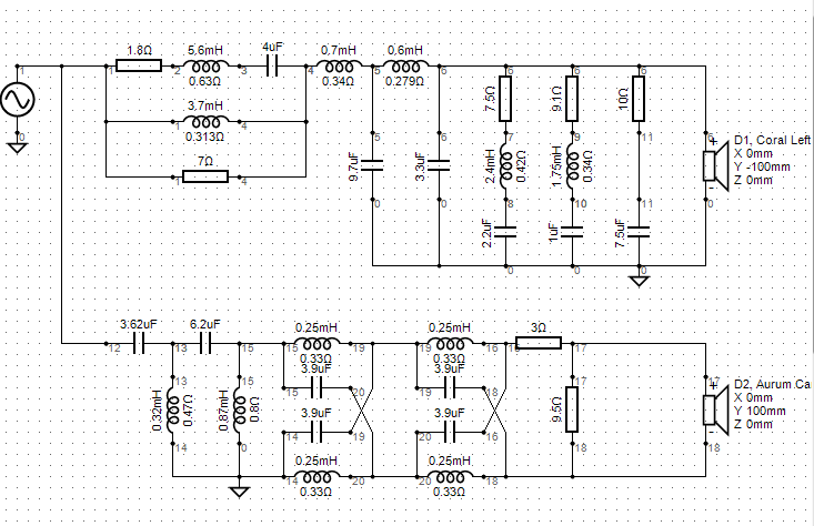

Might have found the error, but I don't understand how it happened. When I enabled node list display I see the 3.62uF capacitor for the tweeter that is supposed to be connected to the signal generator says node 12 not node 1!
How did that happen ? Also it looks like the earth point for the tweeter crossover is wrong as well - it shows node 14 on components that are supposed to be connected to the node 0 earth point ? Something not quite right with the node editor that has allowed this to happen I suppose.
Edit: If I delete the line between the signal generator and 3.62uF cap and try to redraw it starting from the middle of the line between signal generator and 1.8 ohm resistor, once the line connects it shows a dot at the top but the capacitor still lists node 12 not node 0 so there is no actual connection made in the netlist even though there is a visible connection on screen.
If I instead try to draw the same line starting at the capacitor it will not "attach" to the horizontal line from signal generator to 1.8 ohm resistor at all, so the result is inconsistent depending on which end I try to start drawing from.
Same problem at the bottom earth point - the line is displayed as connected but isn't. If I recreate it using different arrangements of line segments and a different drawing method I end up with something visually identical, but with the nodes merging properly and I now have displayed output from the driver.
The issue seems to be where a new line is started from the middle of an existing line. It looks joined complete with a dot but really isn't.

I'm just guessing now but probably all wires are not connected together. Endpoint of wire must be connected either to:
- Terminal of component or
- Endpoint of another wire or
- Corner of another wire. Not in the middle of straight wire without node.
I would not use wires to combine ground. Ground symbol for each shunt is simpler and faster to draw. All pass filters are exception because output side must be separated from ground/minus terminal of generator.
General instruction is to avoid wires because it's difficult to see without single selection is everything properly connected or not.

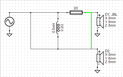

Green highlighted wire visualizes valid endpoint while wiring. Dot is just a dot in the end. Problem is that dot is not yet red (will be quite soon I hope).
Still a bug present though - if I start from the middle of an existing line and draw a line to a valid destination like a corner, the line turns green before the final click indicating that the line will be valid, after clicking a dot is drawn at the original starting point as well to show a connection, however the line is not really joined and the actual nodes are not merged. So it looks connected but isn't.
If I draw the line differently, I can get a line that looks visually identical but does have properly connected nodes. For example, delete the line I wanted to draw from the middle of, draw a line from the new point back to the same place, then follow a 90 degree bend to one of the original connection points to complete that line, then draw a second line to complete the other missing piece.
Now it looks identical on the screen but it works correctly. Looking identical when drawing different ways but one works and one doesn't is a bug that will catch people out. I only figured it out after I turned on the node list display.

This is now done to rev 2.0.3.5 (2018-06-13). Wire segment is splitted with a node if user clicks intermediate point while adding new wire. Wire to be added won't split even it travels via component terminal or endpoint or corner of some existing wire.
Black dots are rendered to wire junctions (with some exceptions, see changelog). Dot rendering is kinda post process and therefore dots are not visible while adding and dragging.
Could you evaluate are these features close to your expectations, please. I don't have higher requirements or plans for basic wiring anymore.

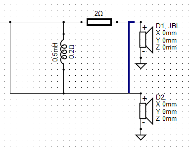

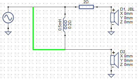

Ok just that it sometimes actually does turn green see attached 😉 I just started to add that line from the top and moved down to the corner (to see if I could reproduce) and it turned green, so I thought it was being inconsistent... edit: I guess the corner is actually a node, but doesn't show as such...
edit2: the second attachment shows sometimes it does not take. I clicked on the line and it still stayed in line drawing mode. If I move it all the way to one of the component junctions it turns green which means it is attached at the bottom (as shown in third attachment.

I just made new build (with same revision number) which draws dots also to wires which are not properly connected to network. That could be more logical when circuit is not so complete yet, though black dots in opened wires are not so nice looking.
