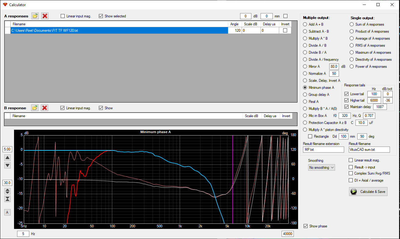

Once TF is exported, here I used calculator tool and min phase / HBT to define a flat line slope below 100Hz for zero low frequency adjustment by the filter.When I tried this, I am unable to limit the filter to a certain frequency range, despite setting it in the Optimizer window.
What end up is that it will try to hold a flat FR until 0Hz (or it seems so as step response never came down). That drove the woofer crazy. 🙂
Is there a way to have the FR limit to a certain range? It can do unity gain outside the range so it won't affect the response.
I understand one way is to try to play with the LP/HP curve to match the current cut off but it'd be nice for the woofer to come down naturally in its low range.
HBT damages measured phase response so minimum phase feature alone is not valid option for this purpose. Merger is needed to include actual measured MF...HF to generated LF. That does not change much because adjusting target close to system response drops gain close to 1. Noise stays quite low with help of near field measurement.
Extrapolation down to 0 Hz is needed for IFFT anyway so there is no perfect solution. FFT length (not too long) and window function in Impulse response window can be used to limit problems due to extrapolation.

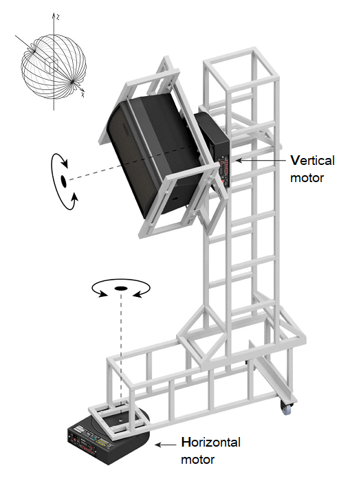

I'm just trying to find document where V[mmm]H[ppp] format is specified. I can't find it from EASE 4.4. user manual. Some (lost) document I've seen used mmm=meridians and ppp=parallels also for V000H000 format i.e. exactly the same coordinate system with IR[mmm][ppp] format having 3 digits for phi (orbit) and 3 digits for theta (off-axis) which is tested with actual data. That does not sound logical with V000H000 format so I can change reading for V000=vertical and H000=horizontal as they are in VituixCAD.Kinmo, sorry for the bump, but I am afraid that this will be drowned in all messages and yiu have switched pms's off

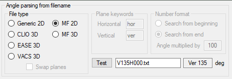

Maybe I am not understanding something right.
if I try to import the files in the attached rar file (also in the vituixcad "normal" format), I expect to get 4 horizontal and 4 vertical measurements.
But there is no way I get this working in the importer, If I use plane keywords H and V, only H's are imported if I use "search from beginning" and only V's are imported if I use "sear from end"
what should I do to get both H and V values imported?

'Generic dual plane' option reads just one angle value from filename. Keyword - usually 'hor' or 'ver' in the filename specifies the plane. Other orbits are not possible. Therefore dual plane. It's not VituixCAD specific format. For example ARTA, REW and CLIO in other than balloon meas. mode save in this format.
Your filenames have balloon format because filename contains two angle values: V and H. Constant zero in the other plane/orbit is still balloon format.
P.S. V000H000 format is quite problematic in my opinion. Balloon measurements should use PHI and THETA (such as CLIO, VACS and IR format of EASE) to be easier to understand.

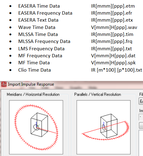

Finally naming format V[mmm]H[ppp] found from here: EASE SpeakerLab – User’s Guide
Section 2.7.2 Importing Directivity Balloon Data:
According this it's quite clear that parsing is already correct in VituixCAD: mmm is meridians/orbit/phi and ppp=parallels/off-axis/theta.
So filenames for
Changes canceled.
So filenames for
- horizontal plane 0-359 deg are: V000H000...V000H180...V000H359
- vertical plane 0-359 deg are: V090H000...V090H180...V090H359

I'll try to find official information about V000H000. It seems to be naming convention in Monkey Forest i.e. WinMF measurement software. Not original EASE format, so I need to make at least small change to user manual and tooltips which refer to EASE.
'MF 3D' file naming V[mmm]H[ppp] is now separated from EASE 3D option so it wasn't big job to make separate 2D variation from it. It's more logical than MF 3D though not necessarily any standard and mandatory. Other naming formats can make the same.
See rev 2.0.82.3

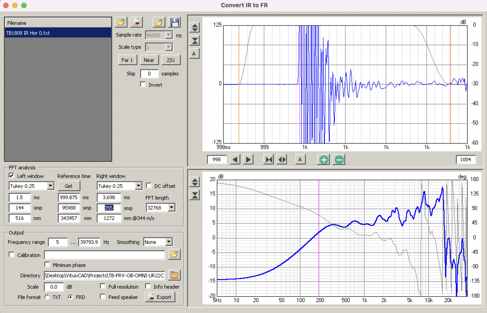

Normally I would measure in REW, gate the response and then export it for VCad. This time I exported the IR from REW and tried to gate it in VCad but am facing a weird problem. I can't drag the markers (yellow or red). The cursor changes to a drag icon but that's it. I'm using VCad on a Mac M1 under Wine.
Joined 2003
Yes, it is a problem with Wine. I find the same issue when running VCAD under Wine in Linux. However in a virtual machine there is no problem, so you may want to try Parallels.
Within Wine you should still be able to use the scroll wheel on the time fields to the left for adjustment with real-time visual.
Joined 2003
Scratch that. @atharva there appears to be a problem with the way the impulse response is saved. I confirmed your issue only because I used the same file that you sent via email.
The issue here is that the impulse is at 1000ms, usually we would expect only a couple ms before the start of the impulse. VituixCAD has issues with this extreme delay for click and drag operation. The issue here appears to be with the file, time of flight is 1 second, or 344 meters!
In the files you sent me, you have also included an ARTA .pir file, if you load this file you will find the click and drag works just as you expect, even in Wine.
