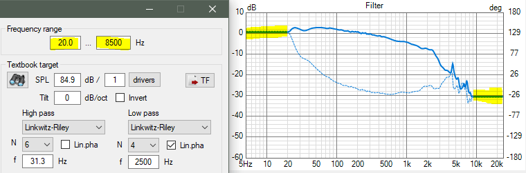

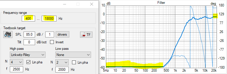

The latest build of 2.0.83.1 (2022-02-04) uploaded few minutes ago uses frequency range limits when calculating response for G(f) block. Magnitude and phase of G(f) response are frozen outside frequency range limits specified by user. This is quite cheap trick because result does not necessarily maintain delay features.When I tried this, I am unable to limit the filter to a certain frequency range, despite setting it in the Optimizer window.
What end up is that it will try to hold a flat FR until 0Hz (or it seems so as step response never came down). That drove the woofer crazy.
Is there a way to have the FR limit to a certain range? It can do unity gain outside the range so it won't affect the response.
For example woofer equalized to target within 20...8500 Hz:
Tweeter equalized within 400...18000 Hz:
Bad measurement data outside frequency range limits does not affect to G(f) anymore. There's still possibility that taps is not adequate, but improvement may need quite much smarter logic and calculations or some user decision or both.
This works also with Axial response and Listening window options for whole speaker.

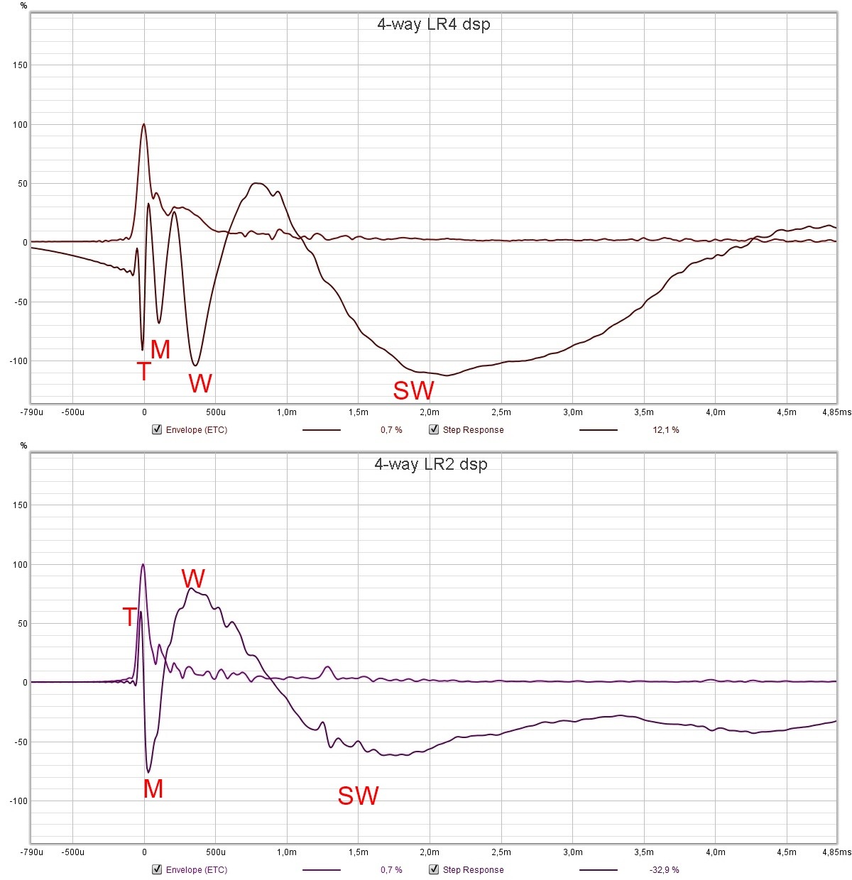

Energy dispersion is not a secret and effect shouldn't be difficult to understand. Sound wave transient can be like a hammer blow, and there will be reduction in audible and sensible effect if total energy is distributed for example from 1 ms to 5 ms with crossover. Normalization to max 1 or 0 dB is typical problem in visualization of pressure(time) and energy(time) data so comparing momentary pressure/power/energy loss is not usually very direct and clear visually. Evaluation of strength/weakness of transient by listening requires suitable music and possibility to manipulate phase response without any other change. Low SPL is as revealing as high because compression may weaken 'hammer blow'.Any chance you could expand on the problem? I think you know exactly what is the difference between good and lame sound, while both would have very similar magnitude graphs, but I'm afraid this might be something you can't disclose? The missing piece
Ideal vs. excess group delay seen in some speakers. The most lame and thin sounding industry has greated.
Here is an example of my diy 4-way speaker with all-LR4 vs. all-LR2 crossovers (response and delays optimized) Measured indoors at roughly 1m, so some reflections visible. The LR2 version sounds better with transients, eg. piano recordings. Later on I've made two 3-way speakers and ended up usig LR2 xo with them too, despite of slightly worse spl-response and distortion than with LR4.
I have understood that kimmosto doesn't like the sound of Genelecs very much, perhaps because of very steep xo causing softening of ETC?
I'm trying to avoid naming, but at least the latest Ones and probably other SAM models too have FIR stage for phase linearization at MF...HF. Improvement is clearly audible in my opinion though cannot compare properly with FIR stage bypassed. Latency requirement limits possibilities with FIR - especially if the lowest XO must remain steep due to features of the radiators. Shallower slopes would help with taps, but that is just different compromise and not necessarily acceptable.I have understood that kimmosto doesn't like the sound of Genelecs very much, perhaps because of very steep xo causing softening of ETC?

Just looking at this again. I think the flat line transfer function makes sense for avoiding compensation of the speaker natural low frequency response, left highlight of the first image. However, for the right highlight of the first image, or the left highlight of the second image, I would want a filter response that follows the slope of the filter there, so the filter continues for n beyond the measurement noise floor for example, the sharp corner in the filter response is a bit disconcerting. This is why my previous suggestion was for use of HBT for this task, but it sounds like HBT creates some phase errors. Maybe I’m just nitpicking once the response is say 40dB down, just something I thought I’d mention if there’s a practical solution for it.The latest build of 2.0.83.1 (2022-02-04) uploaded few minutes ago uses frequency range limits when calculating response for G(f) block. Magnitude and phase of G(f) response are frozen outside frequency range limits specified by user. This is quite cheap trick because result does not necessarily maintain delay features.

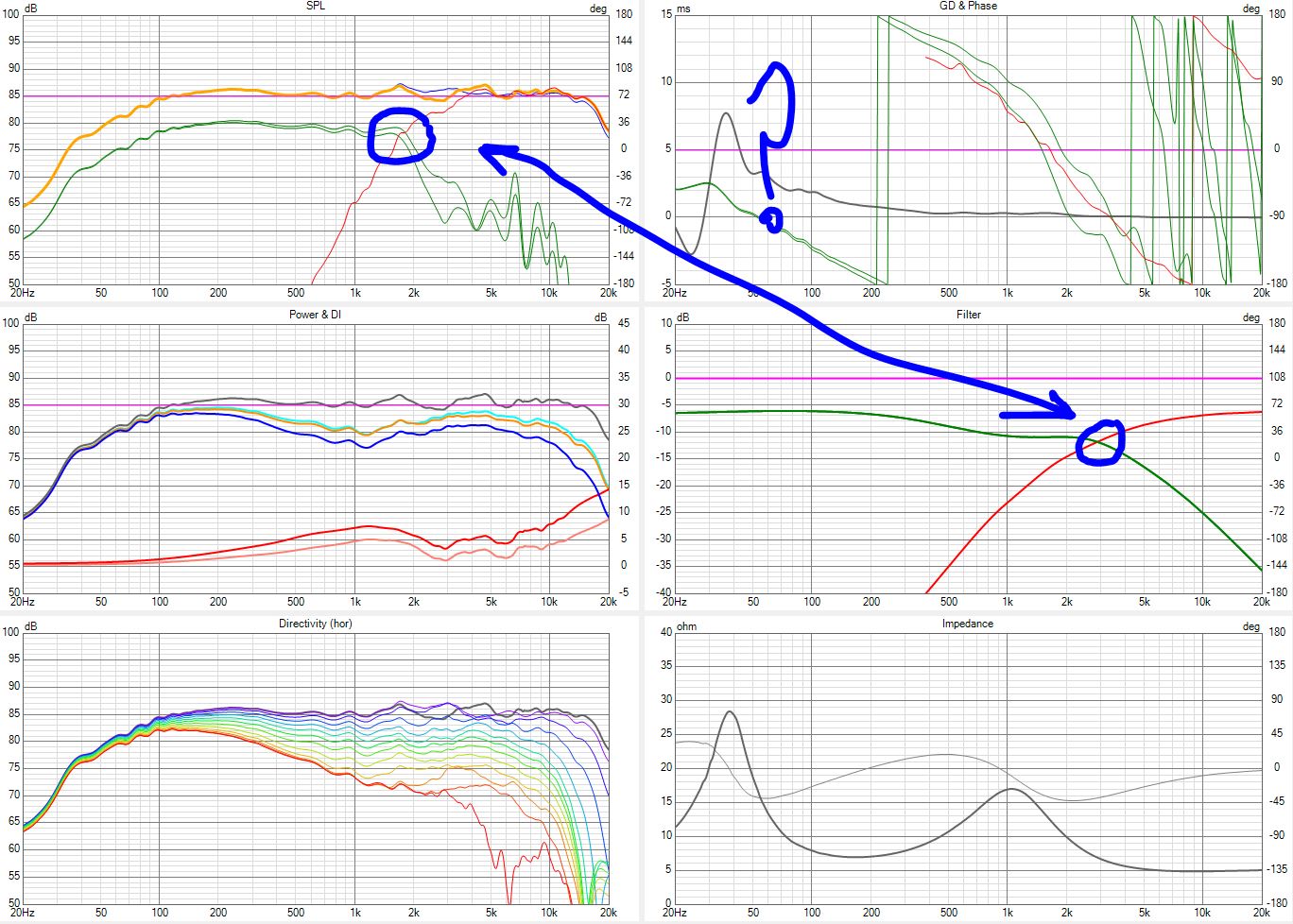

i tried searching this thread prior to posting, but I have a question about the actual crossover frequency. in VituixCAD, there are 2 (of the 6) graphs in question... the SPL and the Filter. When modeling a 2-way system, which of these two, where the drivers cross, is the actual Fc? neither matches each other, so i want to make sure i'm understanding this correctly. thanks!
got it, thanks. i went ahead and did this...Sorry, just realised I misunderstood your original question zinger, I hadn't realised the control options for the preset filter blocks are a bit different than those for when you build from individual components.
In your case, you would be best to use whatever the approximate value of the impedance is at the range of frequencies around your crossover point - for a nominal 8Ω woofer that could be a bit below the 8Ω or a little above, depending on the exact impedance curve of the woofer.

Well the top left is the acoustic response, and the right middle is the electrical response. Both are "correct" in some context of crossover frequency depending on what you are talking about, but for most cases when speaking of the crossover frequency of a speaker, we are speaking of the acoustic result.i tried searching this thread prior to posting, but I have a question about the actual crossover frequency. in VituixCAD, there are 2 (of the 6) graphs in question... the SPL and the Filter. When modeling a 2-way system, which of these two, where the drivers cross, is the actual Fc? neither matches each other, so i want to make sure i'm understanding this correctly. thanks!
