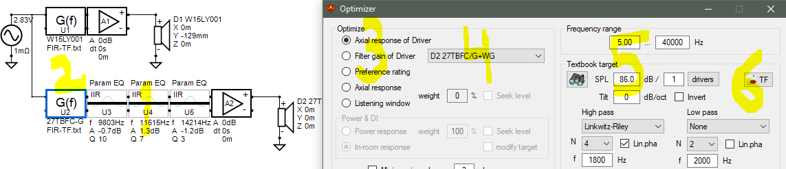

I would use a bit different work order. This is for driver for responses:
0. Add all drivers and load driver responses to Drivers tab. Set smoothing e.g. 1/12 oct for all driver responses to avoid unnecessary detailed EQ with FIR. Add full connection to crossover schematic.
1. Short custom EQ blocks of the driver (Param EQ blocks in the image below).
2. Select G(f) block of the driver to be EQd by clicking it (block highlighted).
3. Select 'Axial response of Driver' option in Optimizer window.
4. Select the (same) driver from list box on the right.
5. Create target response. Note! Woofer's target response should be quite close to system response and Lin.phase unchecked to avoid huge amount of taps. Check Lin.pha for other slopes.
6. Click TF button to save and load mirrored EQ response to selected G(f) block. Command supports also updating response of G(f).
Repeat steps 1-6 for other drivers.
Enable custom EQ blocks and equalize combination of ON, LW, ER, PIR and SP as you like or with Preference rating option.
Finally export IR files as IEEE wav for EquAPO.
One small thing. Wires between active blocks are useless and just waste of time.

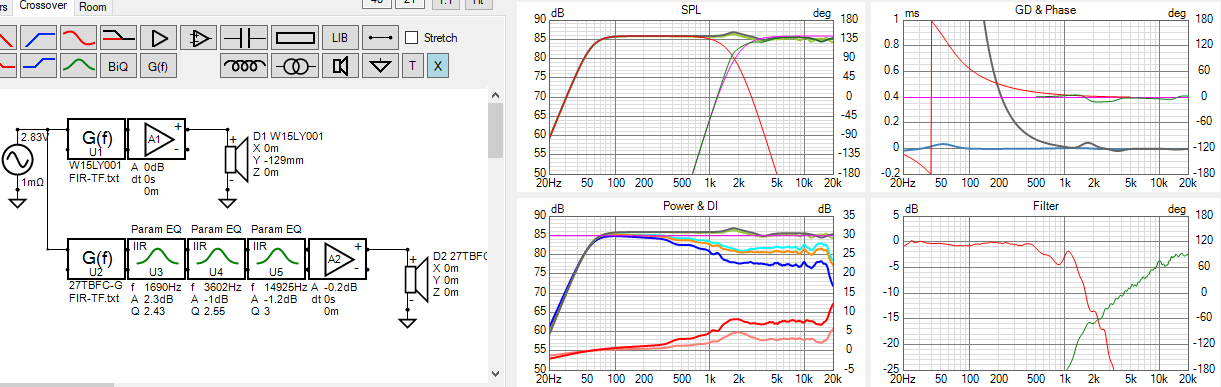

Example result with Kontiainen_demo. ON and LW are compromised with custom EQs to get better ER, PIR and SP. Excess GD is flat 0 ms because HP slope of woofer's target response was minimum phase (=Lin.pha unchecked).
Yes, all blocks and components which are not bypassed (shorted/open) when TF button is pressed will be compensated with G(f) transfer function. That enables also equalizing total response of passive speaker with single IR file and 2 channels. This version has target for listening window. Excess GD again flat 0 ms. Note! Buffer block is needed after G(f) for Impulse response export.

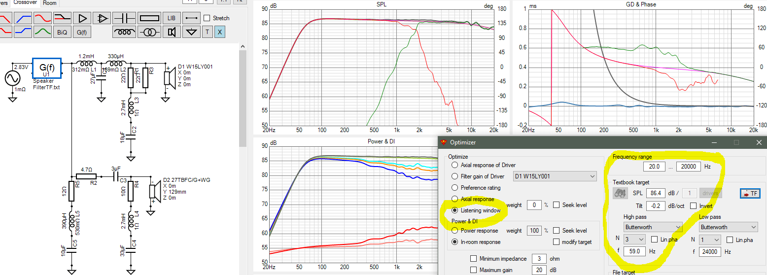

When I tried this, I am unable to limit the filter to a certain frequency range, despite setting it in the Optimizer window.
What end up is that it will try to hold a flat FR until 0Hz (or it seems so as step response never came down). That drove the woofer crazy. 🙂
Is there a way to have the FR limit to a certain range? It can do unity gain outside the range so it won't affect the response.
I understand one way is to try to play with the LP/HP curve to match the current cut off but it'd be nice for the woofer to come down naturally in its low range.
Setting target response very close to system response at sub frequencies is the best and only way because flat response down to 0 Hz is not possible electrically or acoustically. This is not mentioned in user manual because it should be self evident. Instructions exist on both diyaudio and htguide.I understand one way is to try to play with the LP/HP curve to match the current cut off but it'd be nice for the woofer to come down naturally in its low range.
Dropping naturally "as is" could also be difficult in some cases because limiting frequency range causes step to both magnitude and phase response, or target could be linear phase at HF while original response is something else. Both have impact also to impulse response. I have to make some subjective decision how magnitude and phase steps are handled; with simple offset, some ramp, generating theoretical minimum phase response, ...

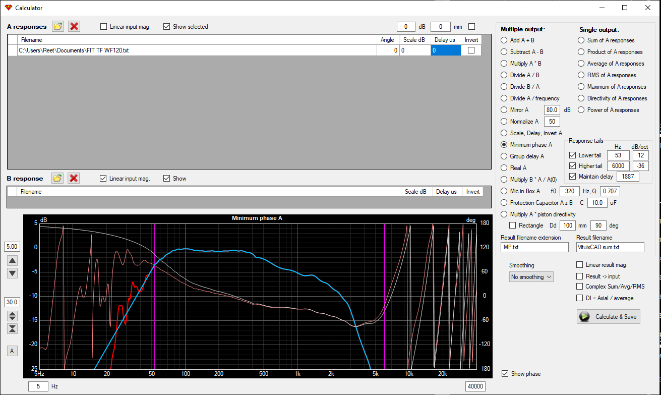

Joined 2003
Just a thought, what if you take the TF result in the calculator tool and use HBT to define a flat line response at lower frequencies. In my testing I often encounter noisy measured response at low frequency where the driver rolls off, so at the very least using HBT to avoid compensating for noise may be a good solution.
