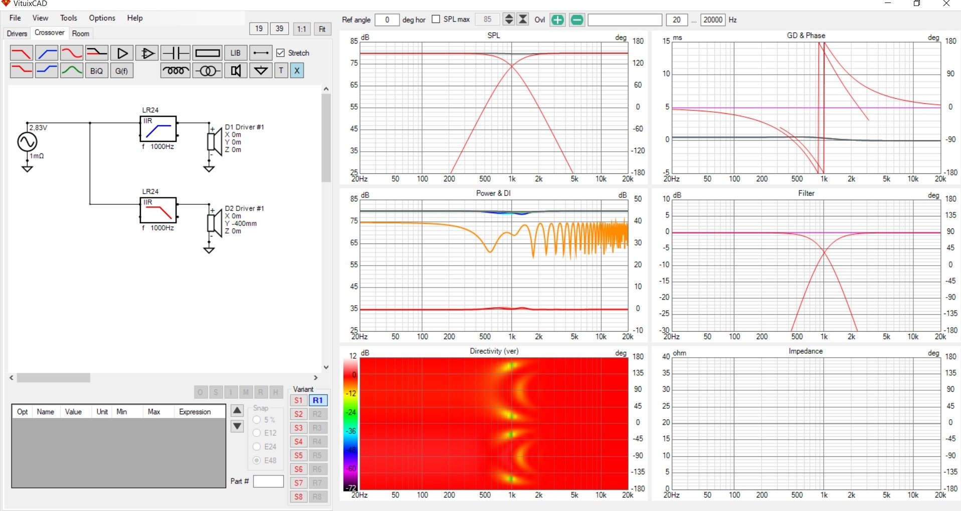

Yeah the woofer is then responsible for the dip, did you check the heights, Y coordinates for your drivers? As the crossover is significantly above the dip then the dip is on the woofers bandwidth and if the woofer is at same height (and Z) as mid the dip doesn't move.

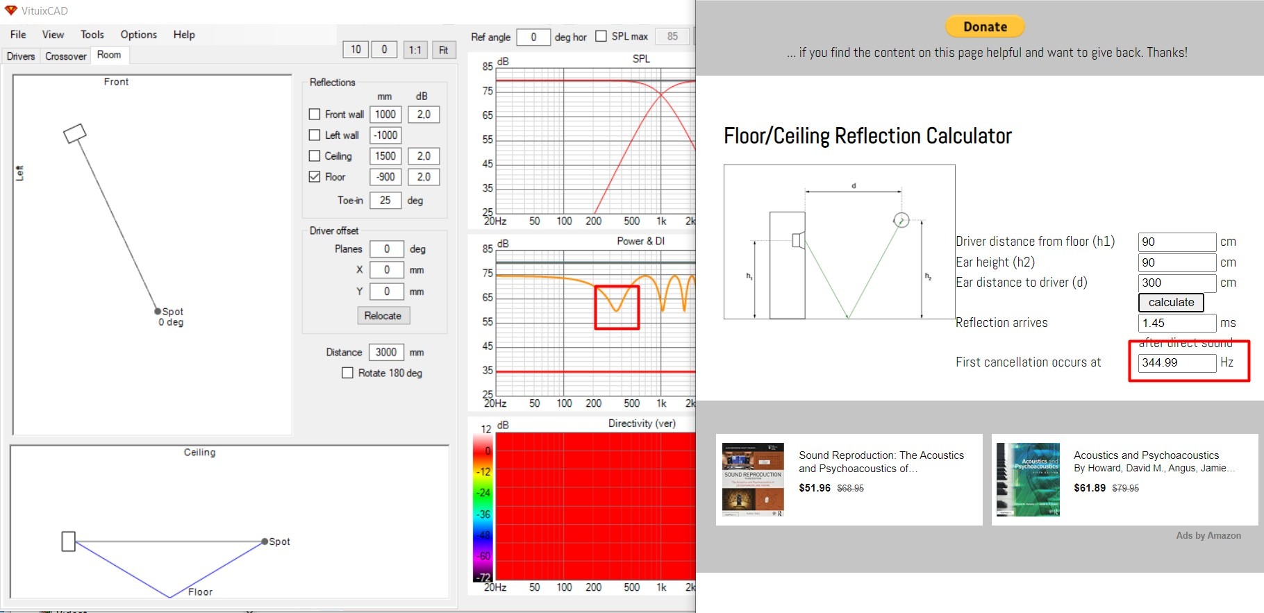

It looks like everything works as it should by few tests, calculator and VCAD show same frequency for first dip :

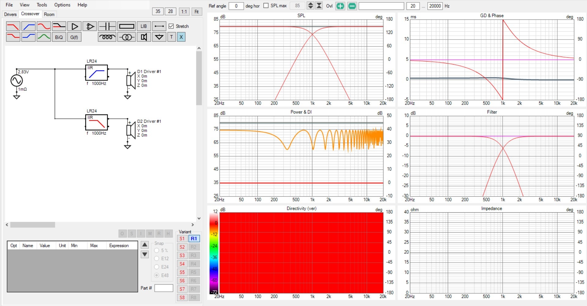

Ideal drivers coinsident, the first dip happens at the woofers bandwidth:

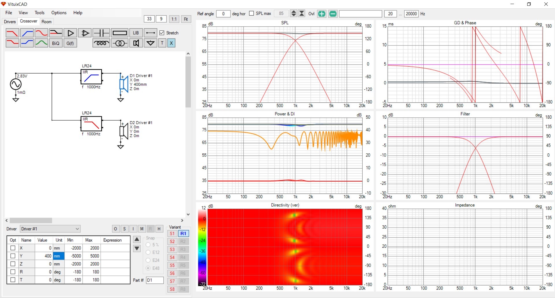

Here woofer is set -400mm, so path length through floor shortens in comparison to direct sound and the dip moves up in frequency like it should. This is roughly 605Hz in the calculator and in the VituixCAD the dip is roughly 580Hz so there is some difference.
Here is for fun, the tweeter part moved up while woofer stays at 90cm. First dip is back at ~344Hz because it is the woofers bandwidth not the tweeters.
To get rid of the interference one should have directivity control, limit sound towards the angle on the floor.

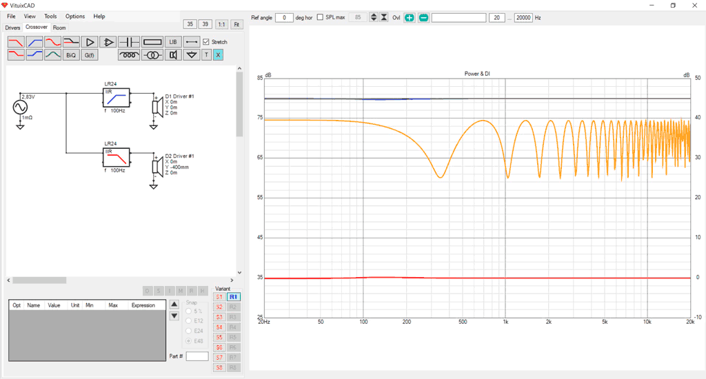

As bonus here is fun GIF with crossover frequency changing from 100 > 1000Hz, as the low bandwidth changes form the higher up driver to the lower one, path length difference towards listening spot shortens and the dip travels up in frequency but almost nothing happens to the dips depth as expected because the directivity is (about) the same all the time. Around ~400Hz the dip gets a bit less since the 40cm c-c is roughly around half wavelength there and there is some directivity towards the reflection point on the floor, at least that what it looks like. Note how the constructive interference gets less as well above the first dip, the directivity due to c-c distance has most effect perhaps wavelength around 600Hz (by eyeballing) because we are inspecting the system through reflection at angle, not directly above or below in which case the reduction of interference would be at the ~400Hz.
