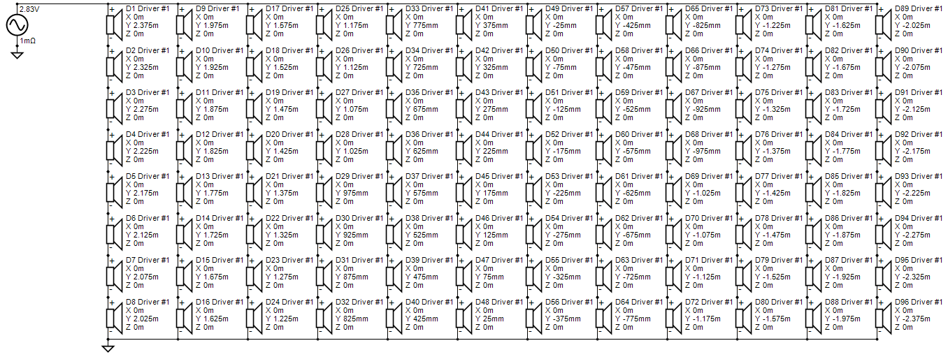

I wonder if would be possible to allow a few more drivers (<=75) and taller baffle (+/- 2.5m)? I hesitate ask because I suspect it would break things. Its already slow near the existing limits but I can tolerate that to get a few answers. Expanding those limits allows me to add sets of ground and ceiling image drivers for more accuracy. Most cases I enable reflections in the room response tab but I can't do that and get a mic offset at the same time.
Limits are just numbers in the program. We can test how long coffee break is needed after changes
I'll try to fix that. Reflection calculation and mic offset are different generations having some differences in coordinate system so I have prevented simultaneous use until problems are solved.

As a spoiler I'm changing Microphone offset to Driver offset i.e. X,Y mm parameters change location of all driver instances in crossover. That solves reflection issue and still serves original goal to test changes in listening axis. Also adding Relocate button which moves all drivers to new positions if X,Y offset produces better result than original.
Rev. 2.0.50.3 (2020-05-16)
Main program
* Microphone offset group in Room tab renamed to Driver offset. Location of all driver instances in crossover can be changed temporarily by X,Y mm.
* Added Relocate button to Driver offset group in Room tab. Location of all driver instances in crossover are changed permanently by X,Y mm.
* Enabled reflection simulation simultaneously with driver offset.
* Parameters in Room tab saved to project file.
* Max 75 drivers can be added at once with Driver layout window.
* Initial Y Min/Max of driver component increased to -2500/+2500 mm.
* Y scale of Driver layout graphs expanded to -2500...+2500 mm.
* Drivers added with Driver layout window are located to crossover schematic on the right side of existing drivers.
Unfortunately driver offset is not as easy and logical as microphone offset was - especially with line arrays, but it works with reflections and enables permanent movement of drivers with Relocate button.

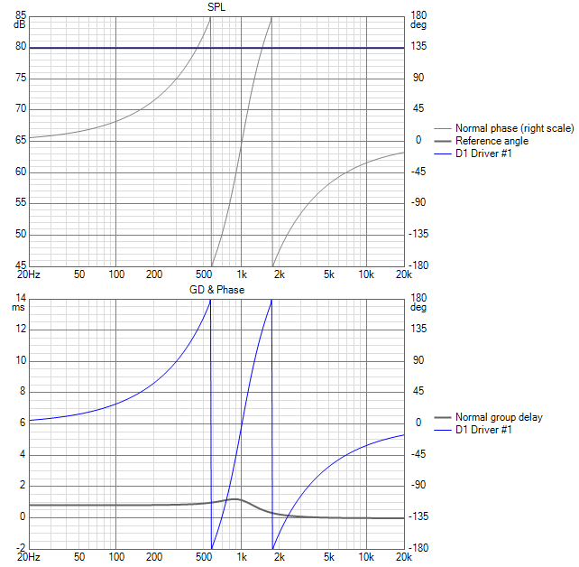

Few all-pass and phase linearisation options are available with generic active all-pass block. VCAD is able to export IR so IRL application requires FIR convolution app/plug-in. For example this is L-R48 phase linearisation.

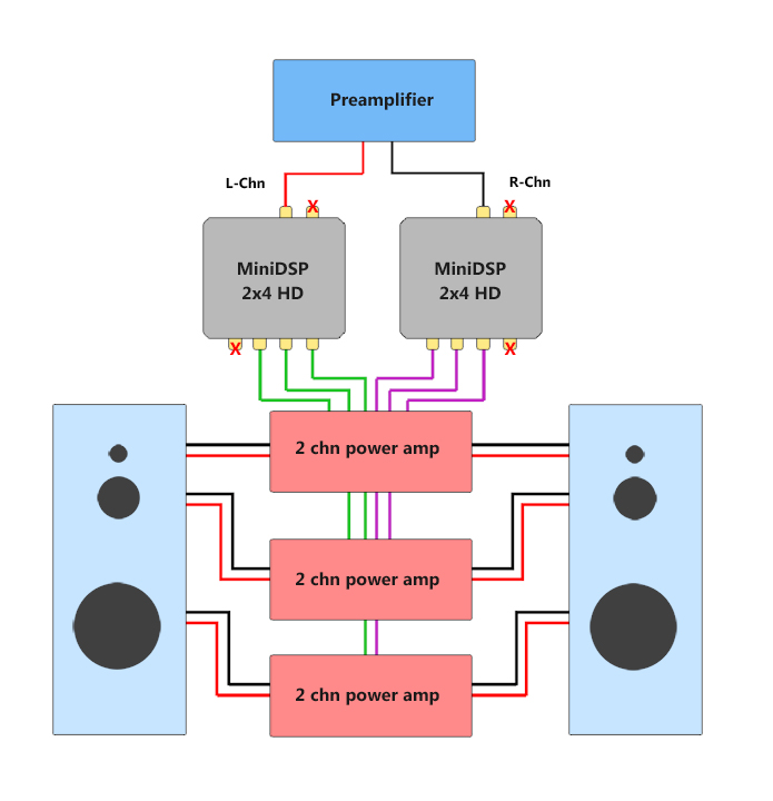

Since the MiniDSP 2x4 HD is able to process 32bit/192kHz and apparently has better sound processing compared to the older 2x4, MiniDSP for me might be back in the game, so I read through the manual and couldn't find any reference for 3 & 4 way loudspeakers. On the surface, it should be able to be used in mono and split the incoming chn to 3/4 outgoing channels.
Included a block diagram of how I intend to use it. Anyone else doing this and any known issues ?

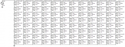

Just tried to add two groups of 25 drivers one above and one below the original 25. When I checked Y in driver layout and schematic, I saw that the Y's had been changed to keep the drivers within the +/- 2500mm boundaries. Even going to schematic and changing a y one at time, the software will set anything you enter above 2500 back to 2500.
Each set of 25 spans ~2.2 meters so would need limits > +/-3.3m for 3 sets
