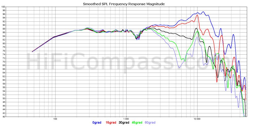

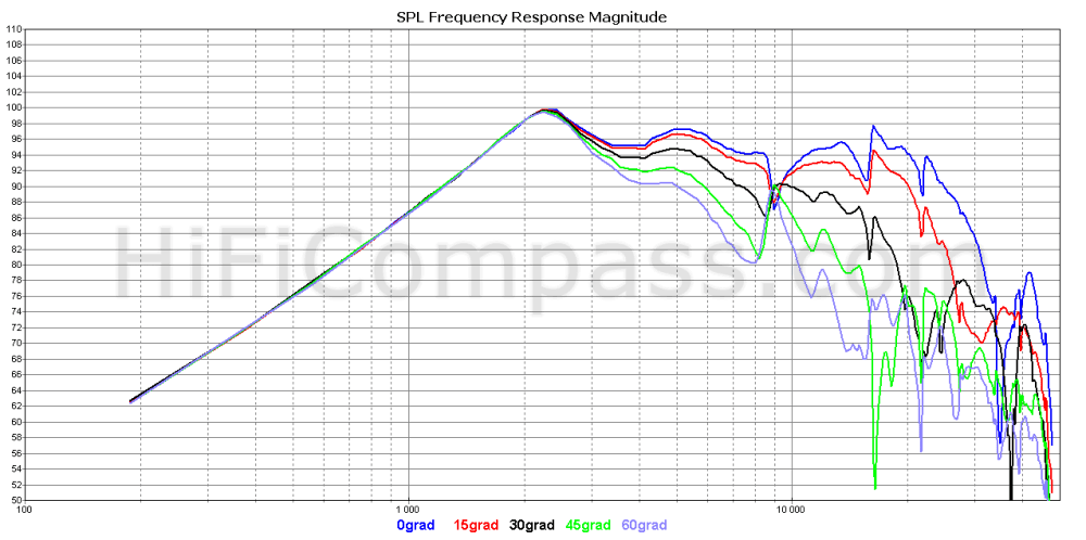

I haven't even tried to learn VCAD, but I see T/S data key to a driver's low end, sensitivity and max spl performance. Directivity of a cone or dome always has many deviations from ideal driver (plate) or even from ABEC sim. But VCAD has enormous database of measured responses!
I do Edge sims almost daily. Basta is even more helpful, but needs a bit more (=too much) brainwork.
https://www.tolvan.com/index.php?page=/main/home.php
That isn't necessarily true, the overall response is usually different due to elements that aren't modelled, but the directivity follows the dimensions very closely so if those are correct the directivity can be extremely accurate.Directivity of a cone or dome always has many deviations from ideal driver (plate) or even from ABEC sim.
